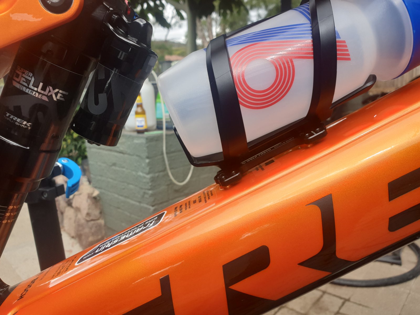

One Q there, you seem to have also an L, and a bottle holder, what bottle actually fits without hitting the frame/shock? :)

It will be a bottle holder that you pull the bottle from the side ?

The bottle thing is a difficult one, even a small bottle if the base is the wrong shape interferes with the shock piggy back... so you need a low profile base, otherwise its good pulls from the side.

As I have one myself, I can also say.... it is a brilliant bike, it is just FUN! I recommend it to everyone.
I purchased a wolfe tooth offset with a left side bontrager cage and a small bottle from trek shop. Works great
