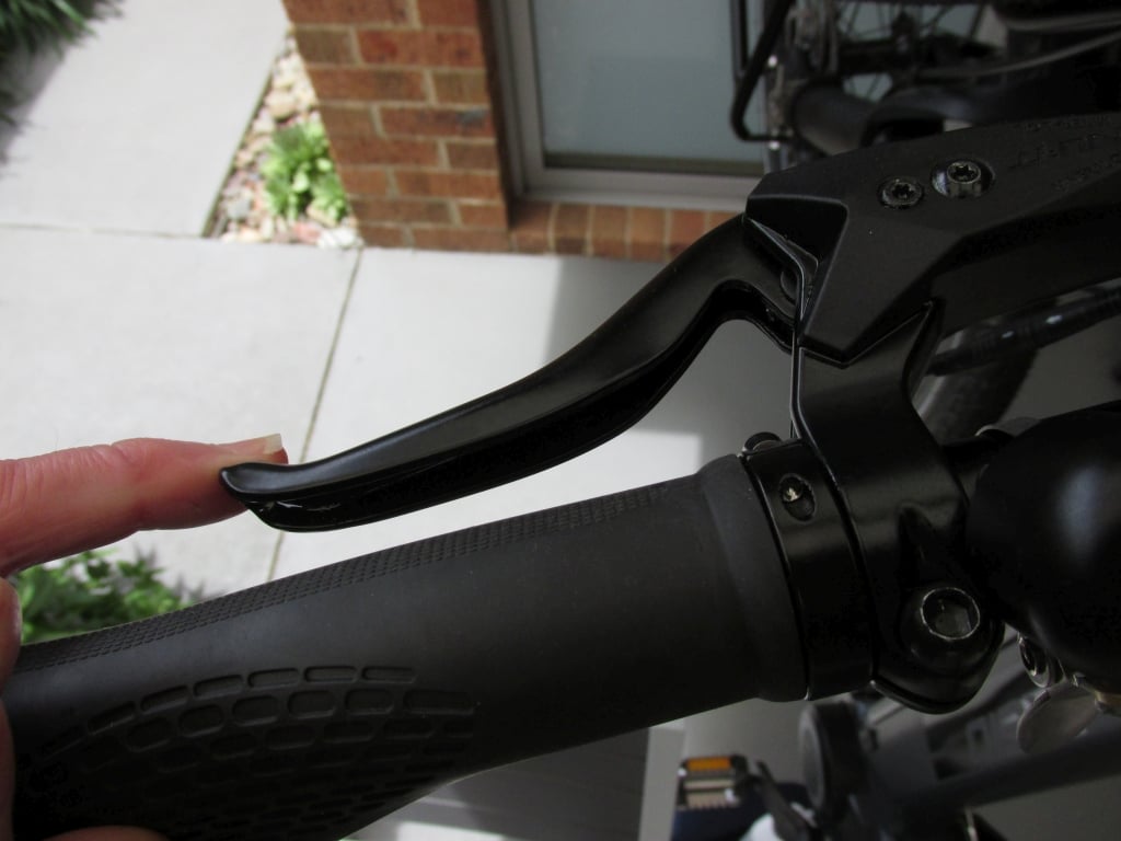

The bike has been destined to pavement riding. The rear brake caliper and lever have been ongoing issue, the front pair not far behind. The NUTT brakes are not great quality overall in materials and assembly. Air leaks continue to pose problems with lever pull getting weaker and weaker. The brake pads are not Shimano compatible using smaller type A03 rather than Shimano type S01 which has become a defacto norm on many bikes.

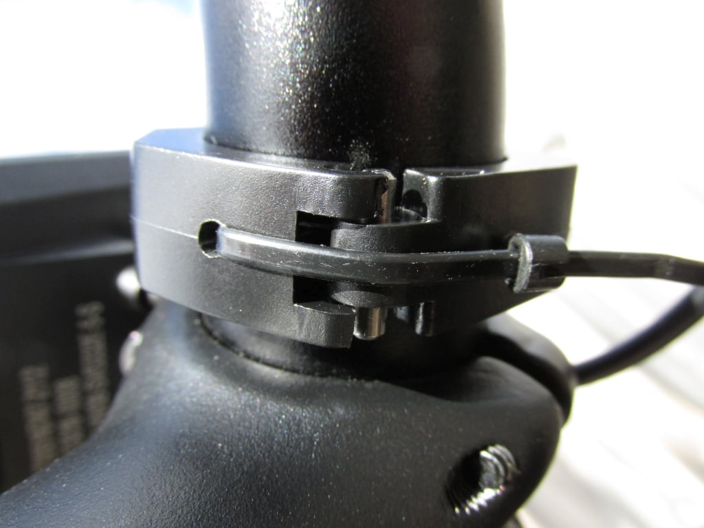

LCD D10 display started coming loose and discovered broken plastic hinge which appears a common fault reported elsewhere, maybe a weak point or over tightened during assembly. DIY repair with cable tie and two small drill holes.

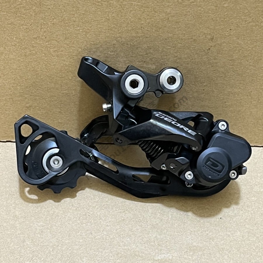

Shimano Altus derailleur difficult to tune for accurate changing, it and the matching Altus shifters are just low quality components and they are what they are. Suntour XCM32 forks beginning to show oil marks on left stanchion, but not uncommon for coil shocks.

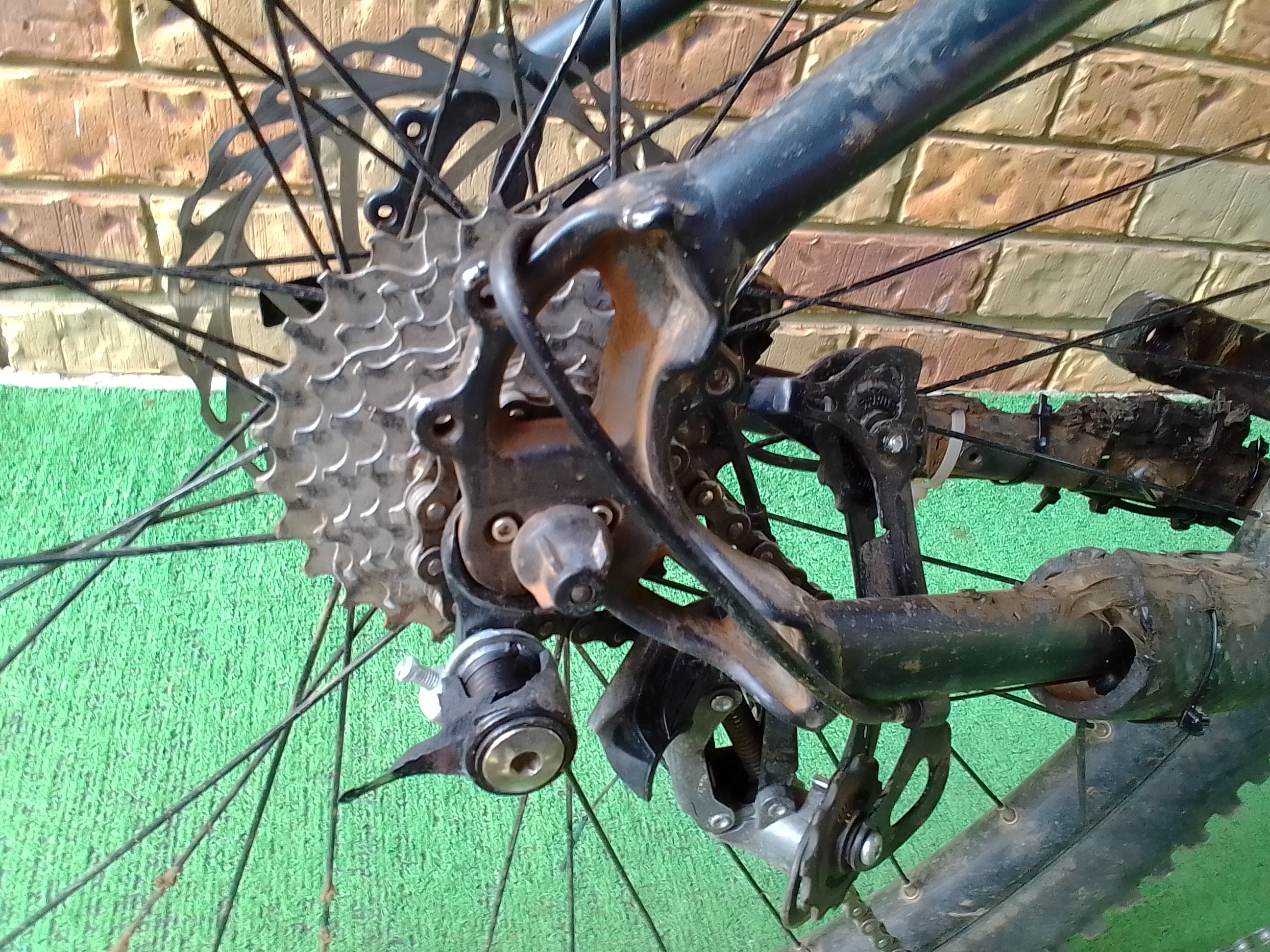

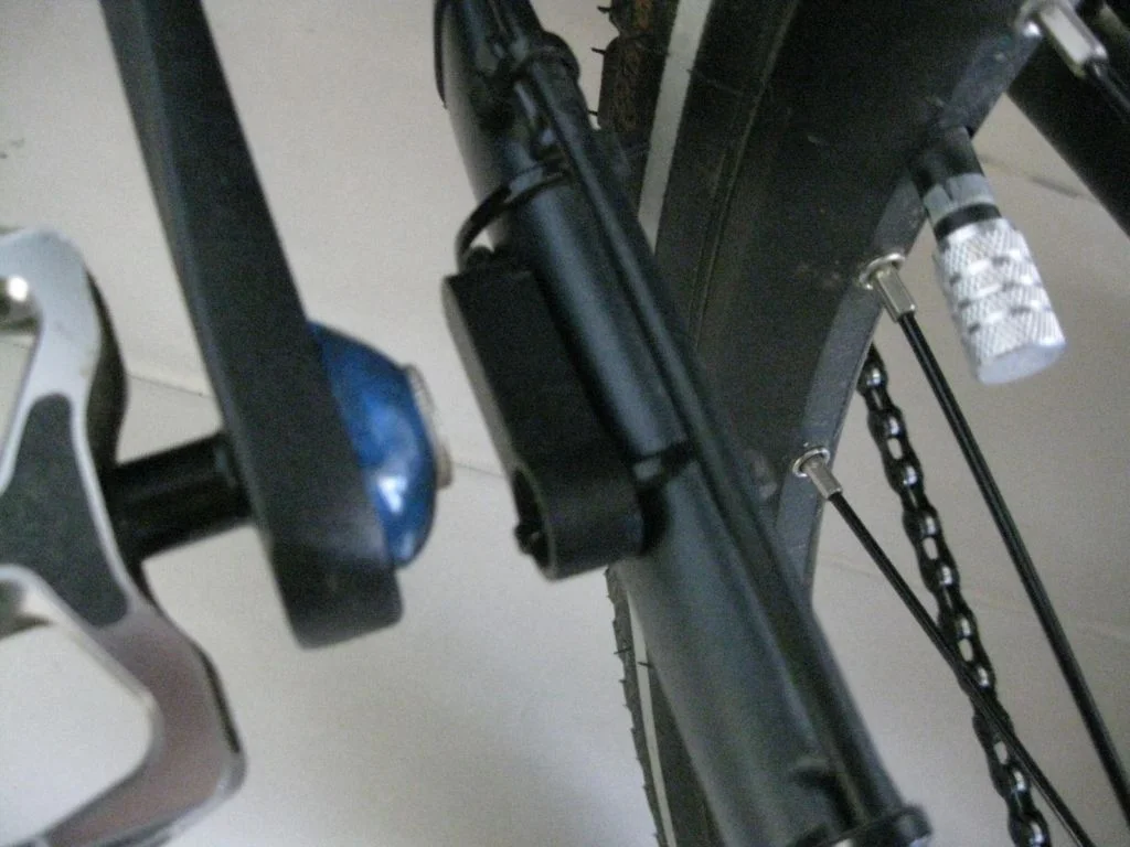

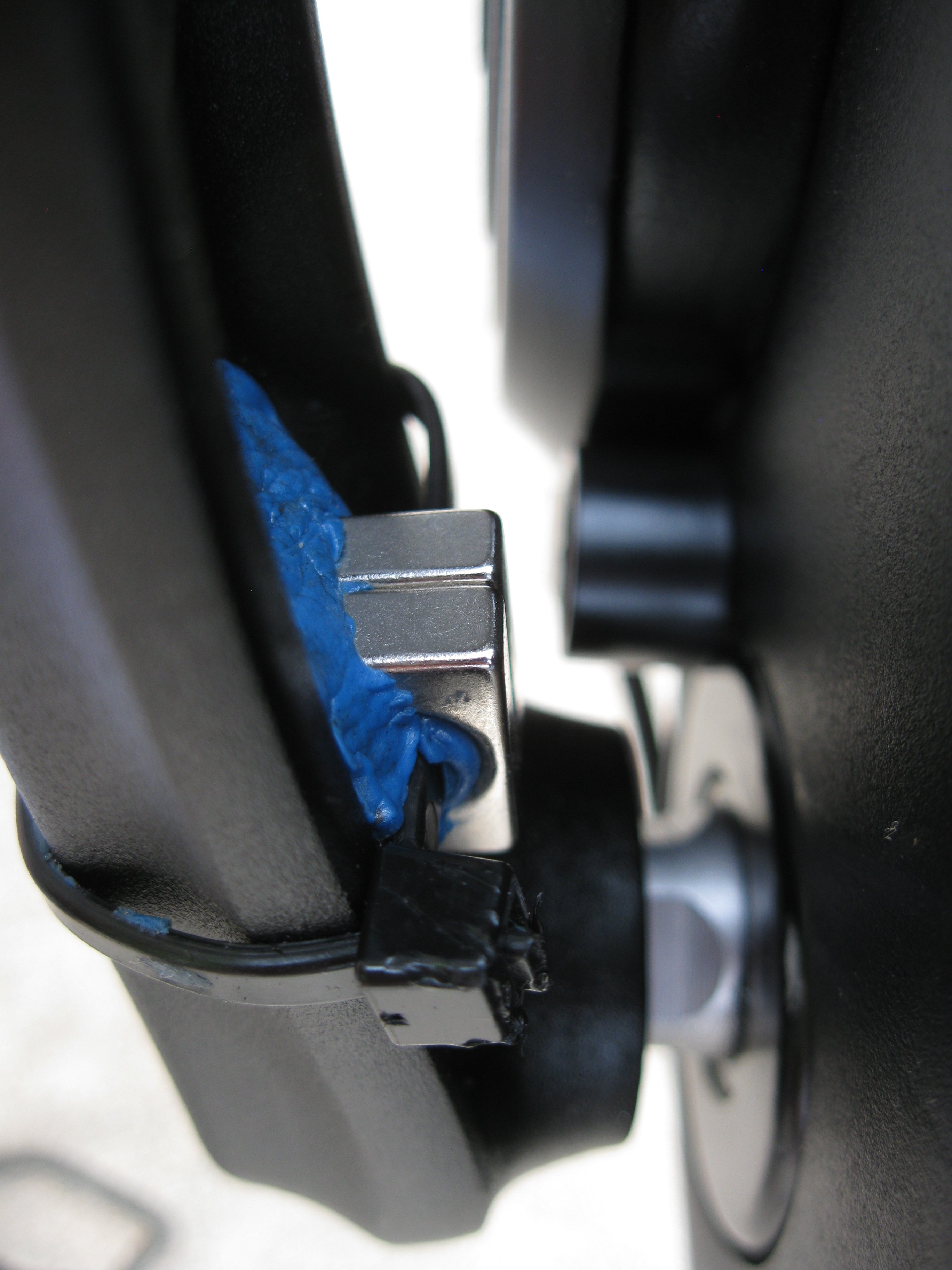

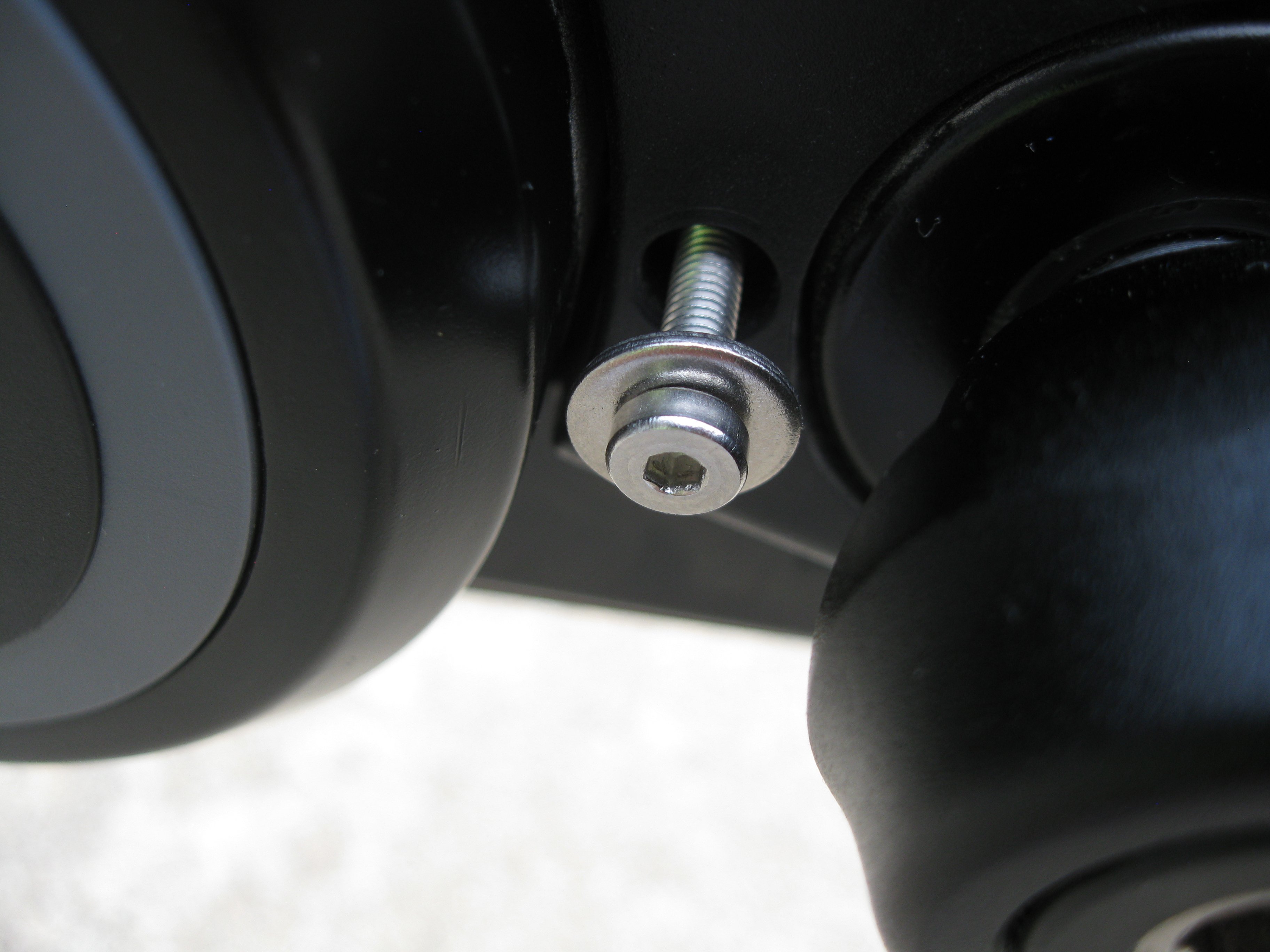

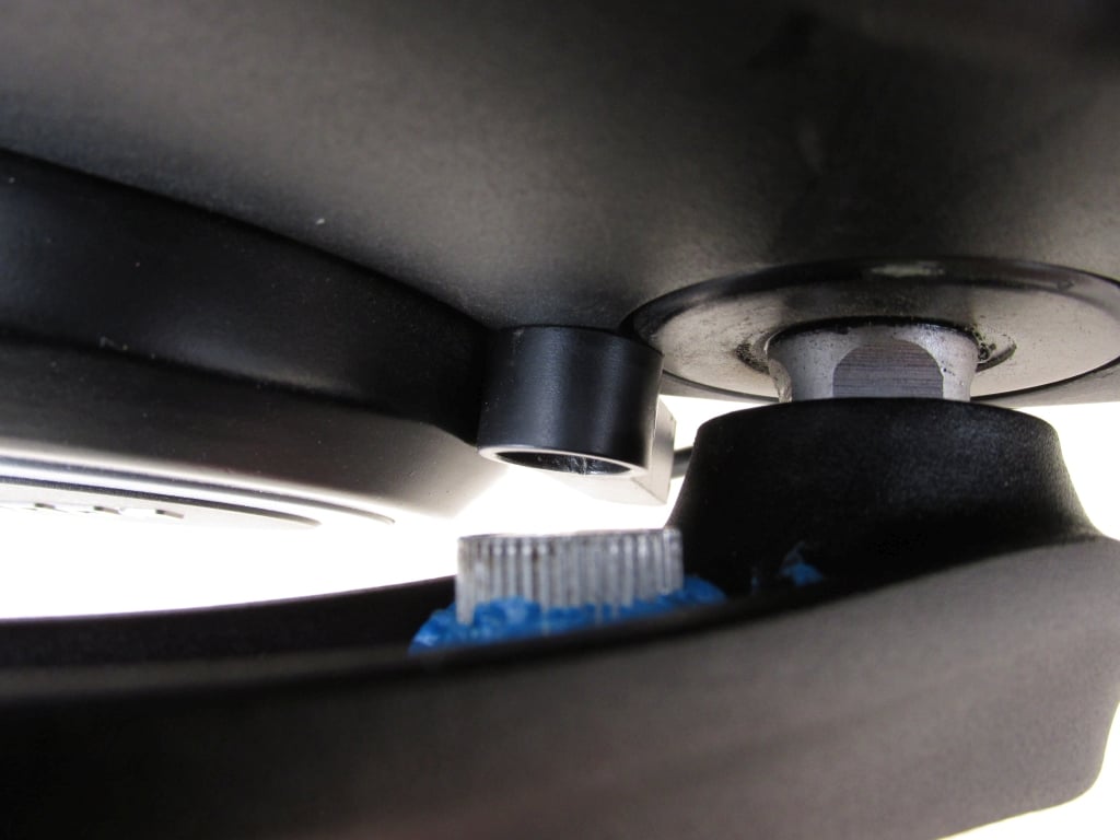

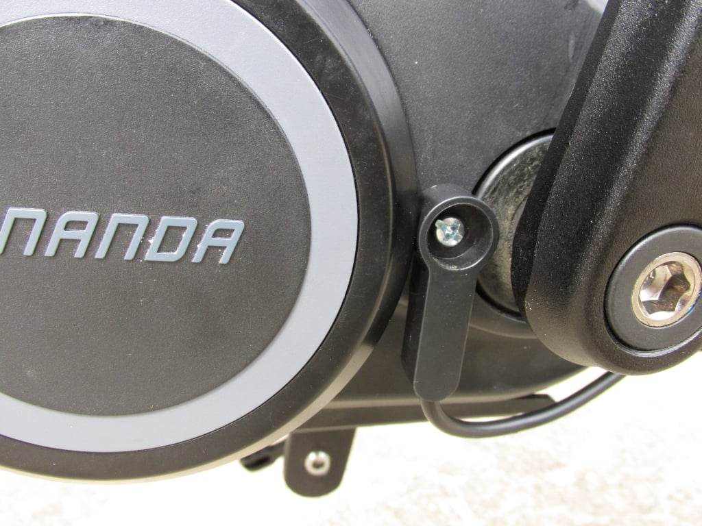

Ananda M100 speed unlock.
I voided my warranty the day I opened the box so might as well share my unlocking modification to remove the nonsense 25kph Australian limit and bring the bike up to the New Zealand 32kph limit.

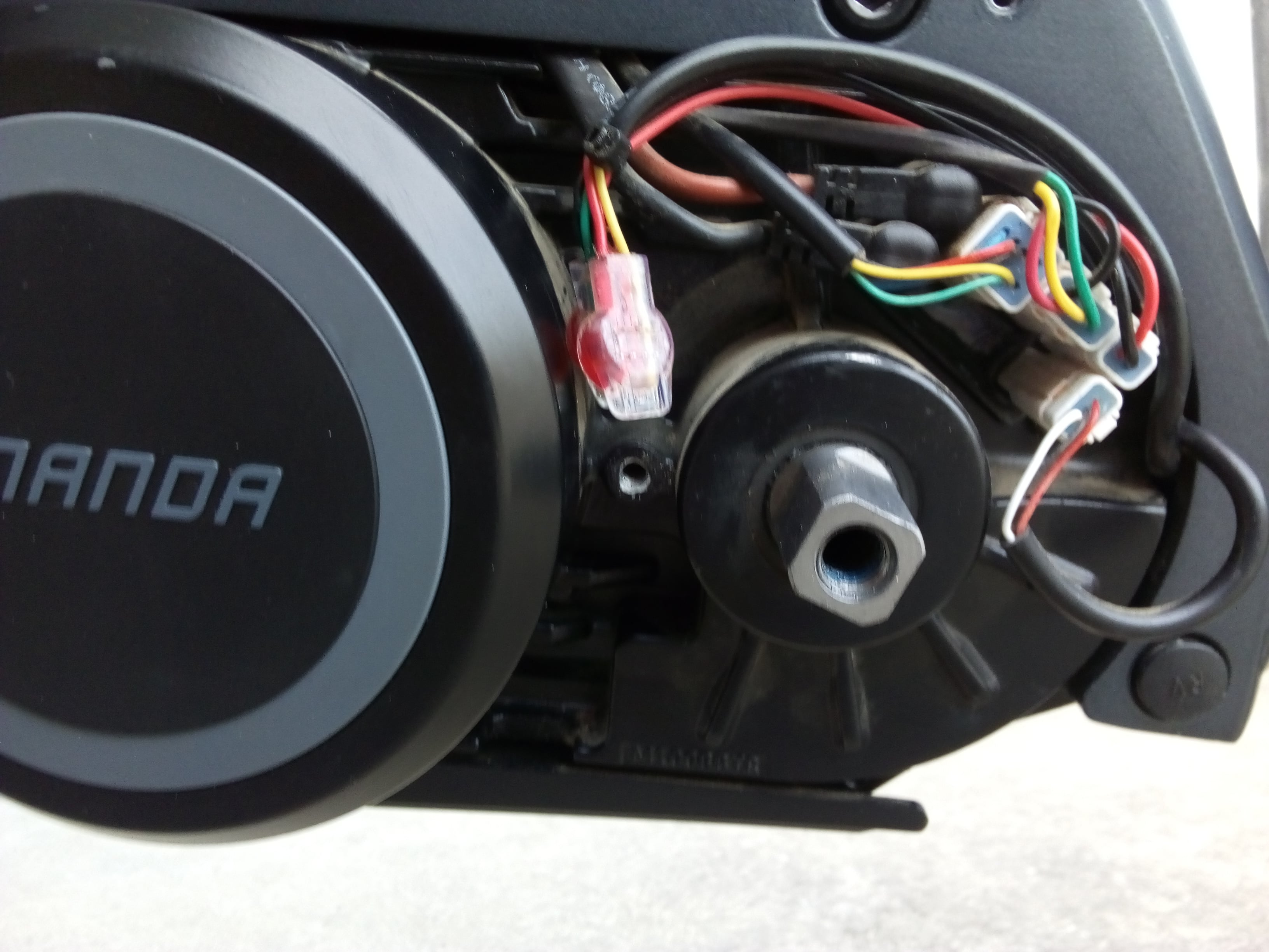

Relocate the speed sensor from the rear wheel to the side of the motor. This confuses the motor firmware to think you are moving slower and the speed limit cut out threshold is not reached, letting the motor spin higher giving you more speed.
The Ananda M100 has a very convenient screw point on the left hand plastic motor cover. Remove the short M4 hex head bolt and attach the sensor using a longer 15-20mm bolt and washer. The cable run back to the motor 'port hole' is same run length.
Remove magnet from back wheel and attach to inside of left crank arm with some Blue-Tac, glue or silicone. Get the distance between magnet and sensor similar to original position. You can also add a black cable tie for extra security or use any suitable magnet that will be strong enough to activate the Hall effect poles in the sensor.
The upside is a potential speed limit approaching 60kph if you can pedal hard enough. Even in the lowest 50% 1/5 setting I easily achieve 32kph with little effort. (The M100 is stupidly powerful).
Downside is losing accurate speed and distant measurements on the LCD display which generally equates to a third of actual measurements. But the loss of these features are quickly overcome with a bicycle that becomes a far more practical transport option.

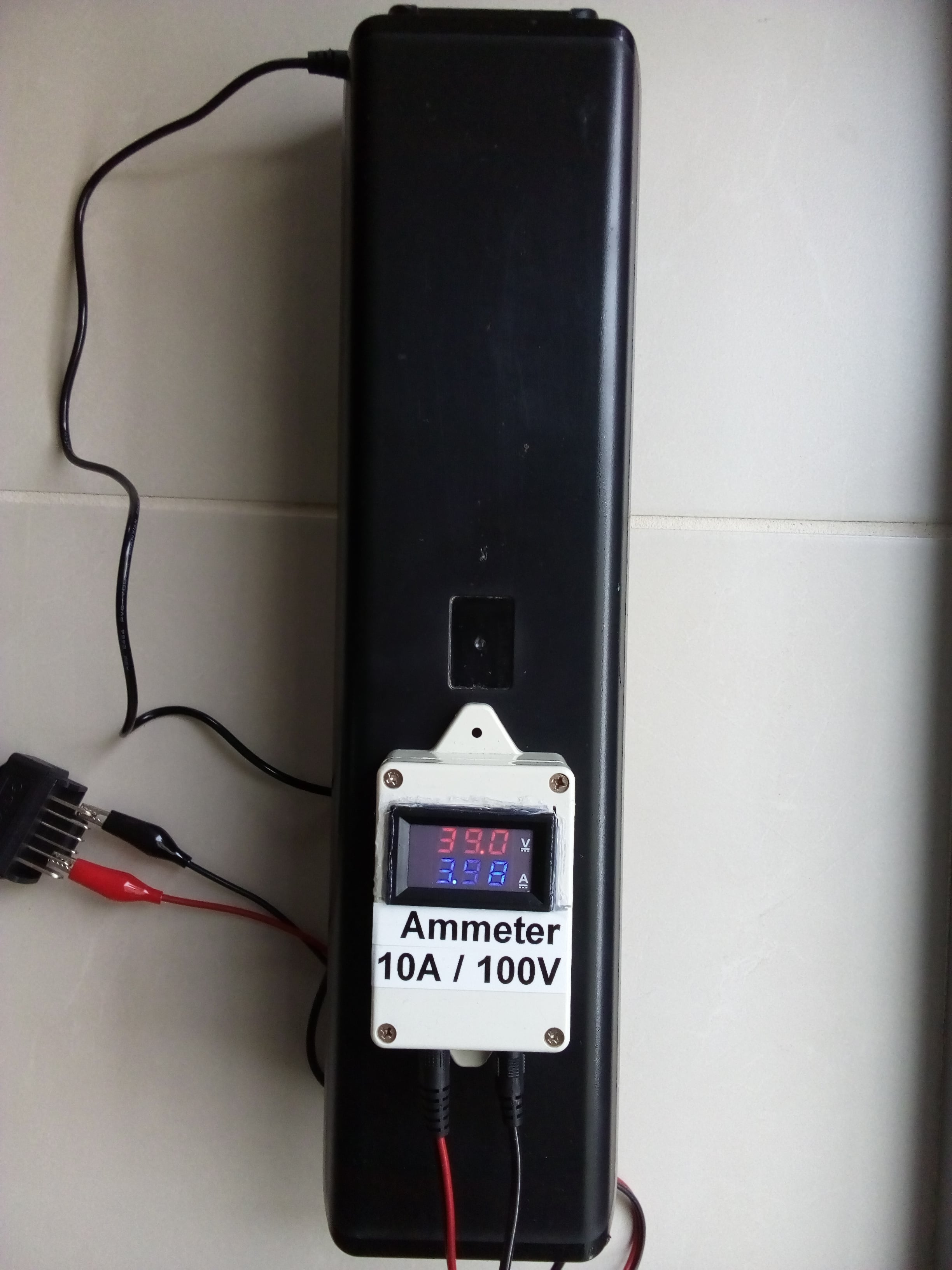

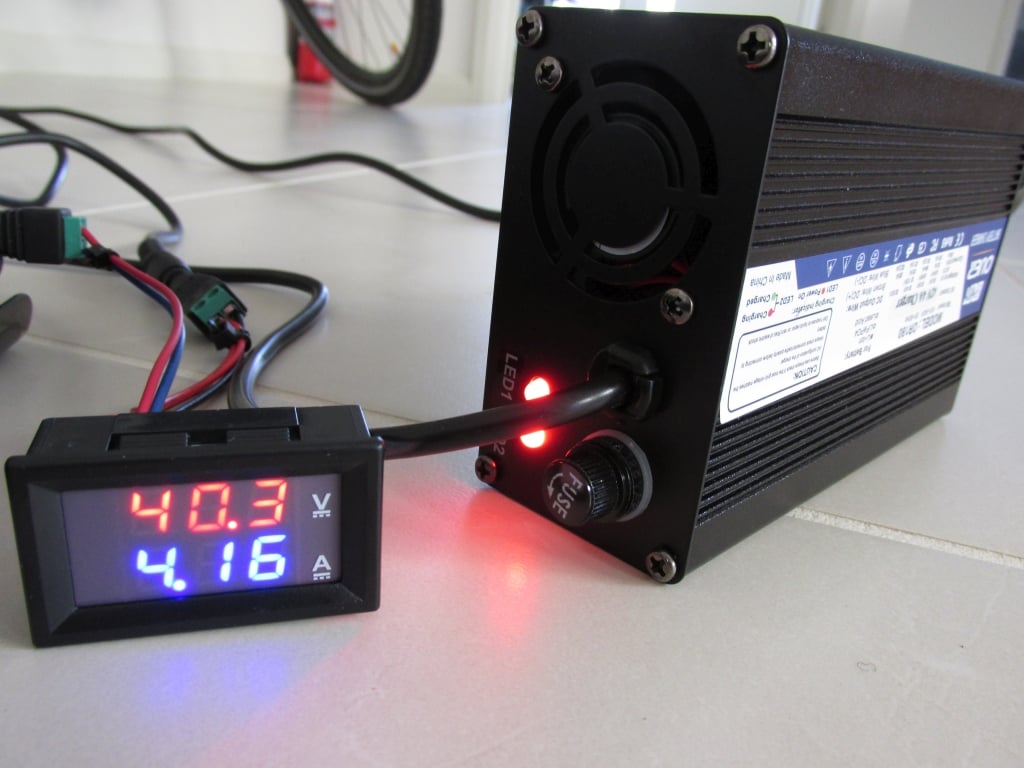

The supplied 2A (1.85) charger gets frightfully hot. I measured the plastic case at a blistering 57'c. I have replaced it with a 4A aluminium case charger with fan for peace of mind. The Ananda B17 battery will happily draw around 3.9-4.1A maximum which shortens a full charge from 6 hours to around 3-3.5 hours.

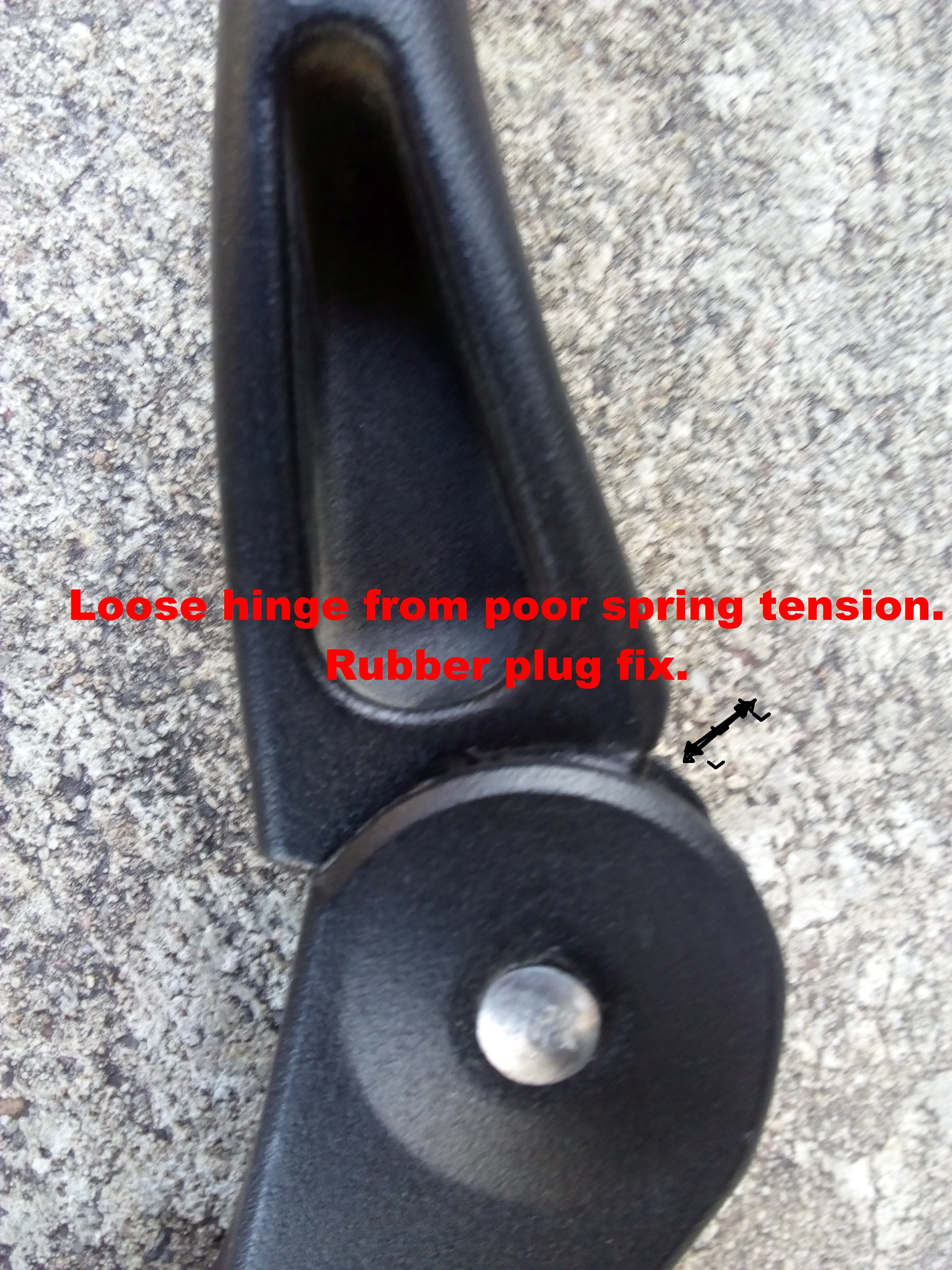

The LOUD 'motor knock' is finally sorted thanks to owner in East Gippsland who had same problem. Would you believe the kick stand (WTF) ? Turns out the spring has little tension in up position, so it bangs on the mount over every bump and the vibration transferred along the frame to the left motor side where the noise comes out ! A bit like referred pain in humans.
Cannot believe this stupid oversight, but other owners caught out the same. 4mm rubber strip glued to arm at hinge point temporary solution. Angle grinder to remove hinge rivet and spring steel bent outwards to provide more tension. The bike is now near silent and a PLEASURE to ride FINALLY !

Sadly the clunky Altus derailleur and shifters remain. But best news is TEKTRO brakes, possibly M285 to replace the low quality Nutt units and price tag AUD2800 07/23.

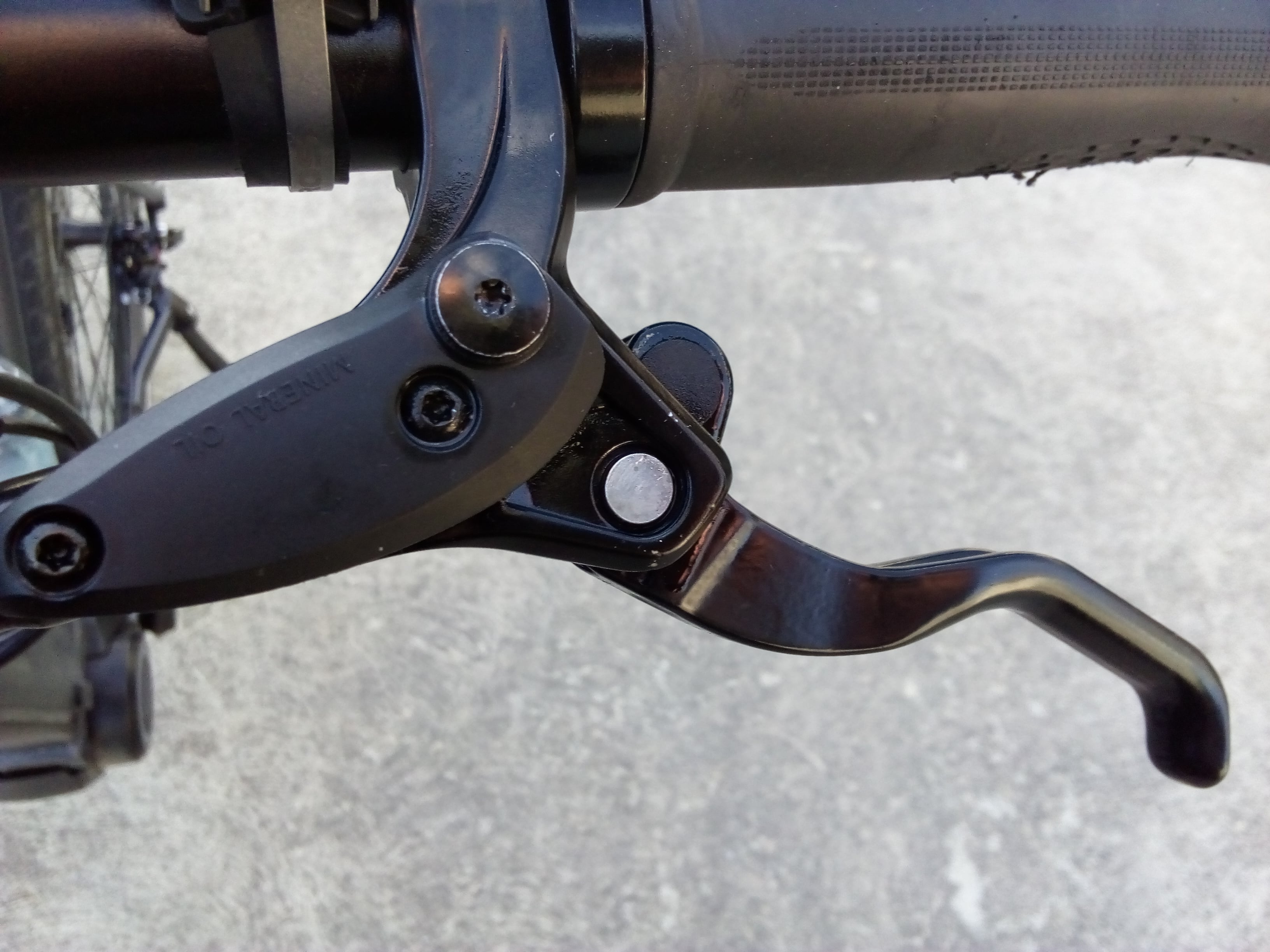

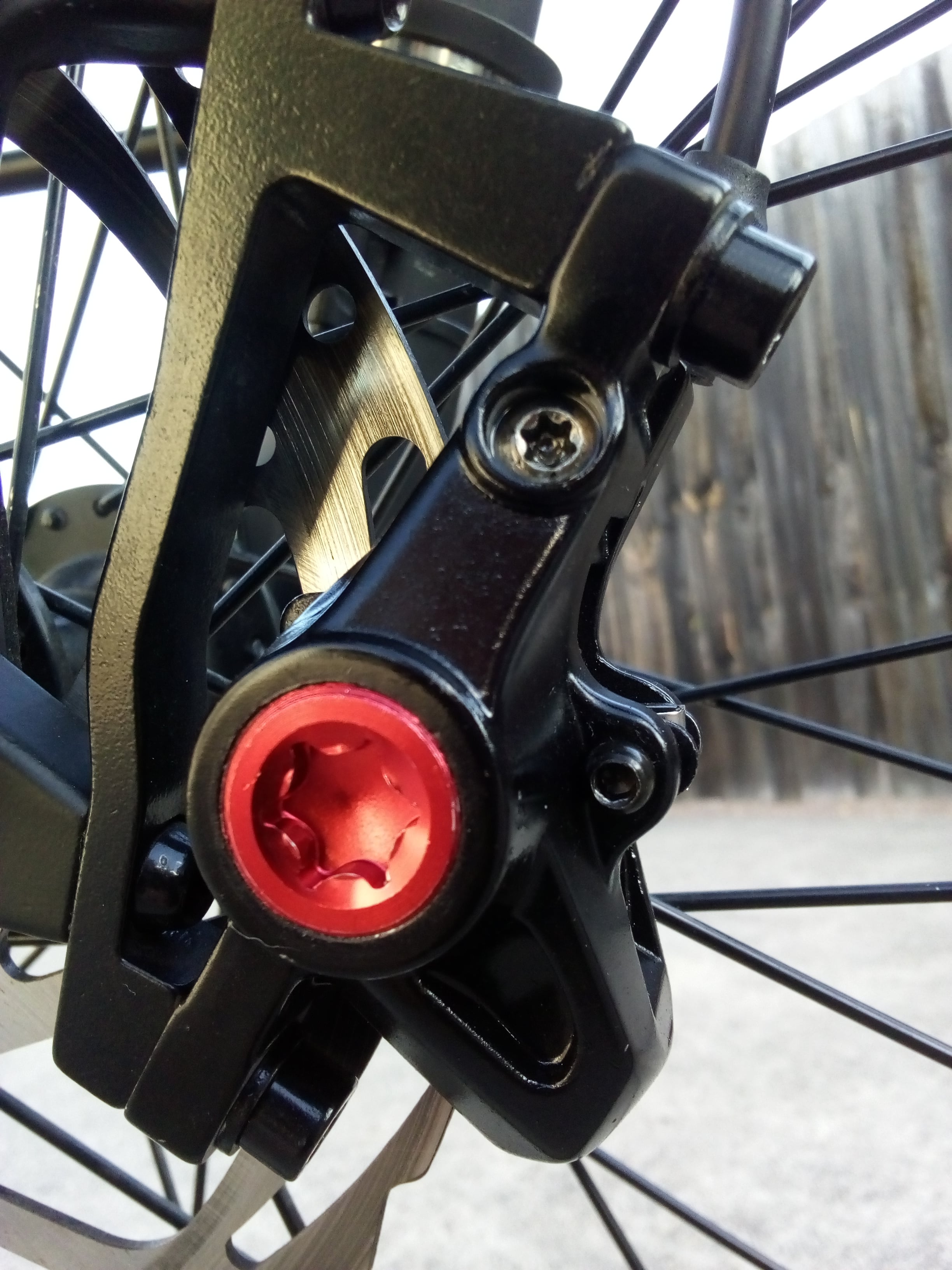

Gone Nutty - I see red.

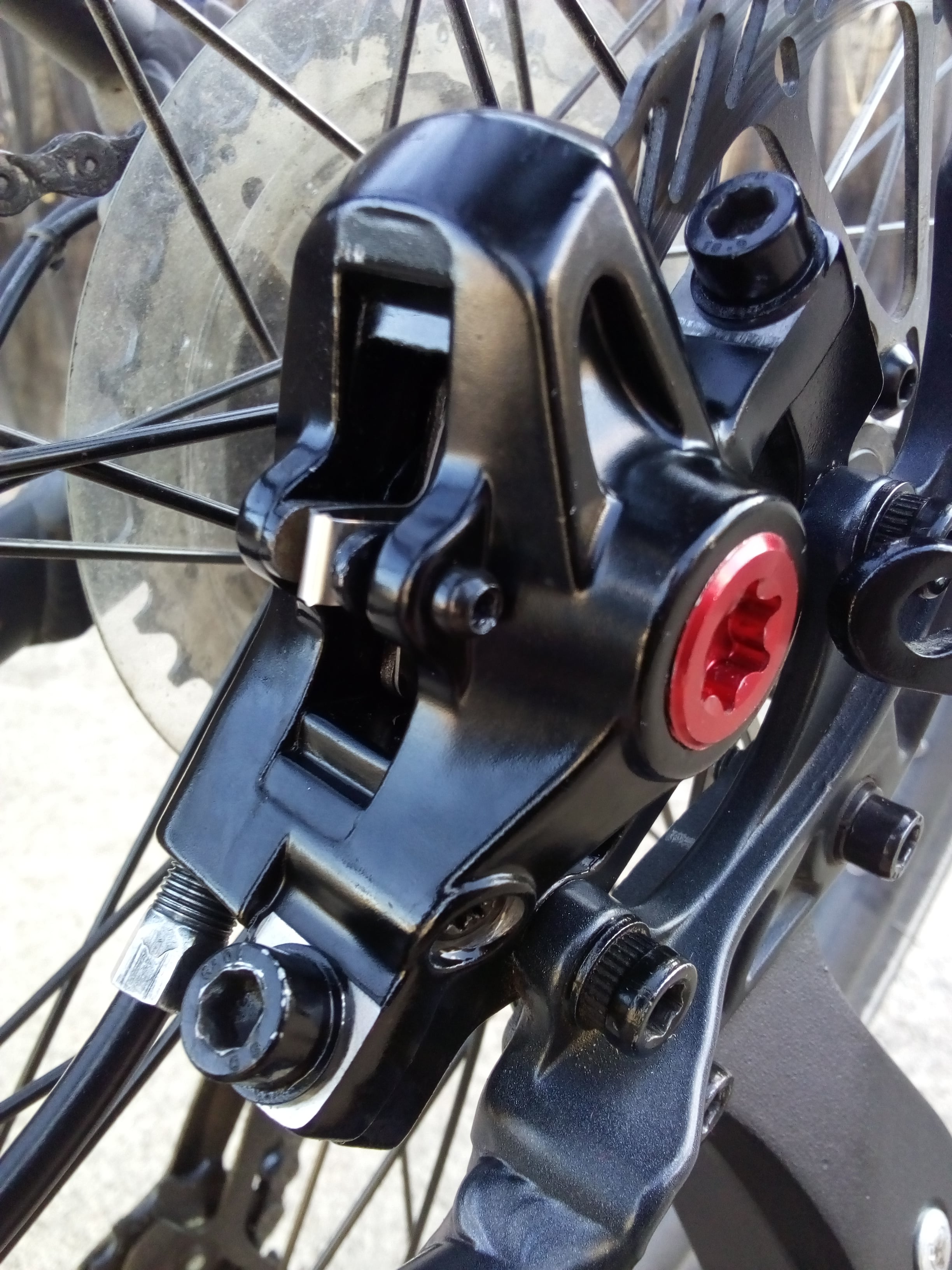

The problematic low quality poor performance Nutt brakes are finally gone ! Replaced with Shimano compatible units from JSHOU BIKE complete with front 180mm disc for NZD51 landed. Bargain. Standard Shimano / Tektro B01s pads, lines, olives , needles and pad bolts. One piece cast caliper and nice one finger ergo alloy levers. Master cylinder has big raised bleed port. Bike now stops 'on a dime'.
eBikes are heavy and generally faster and the Nutt units spec'd by Reid unsuitable, hence why they dumped them on 2023 model for Tektro units.

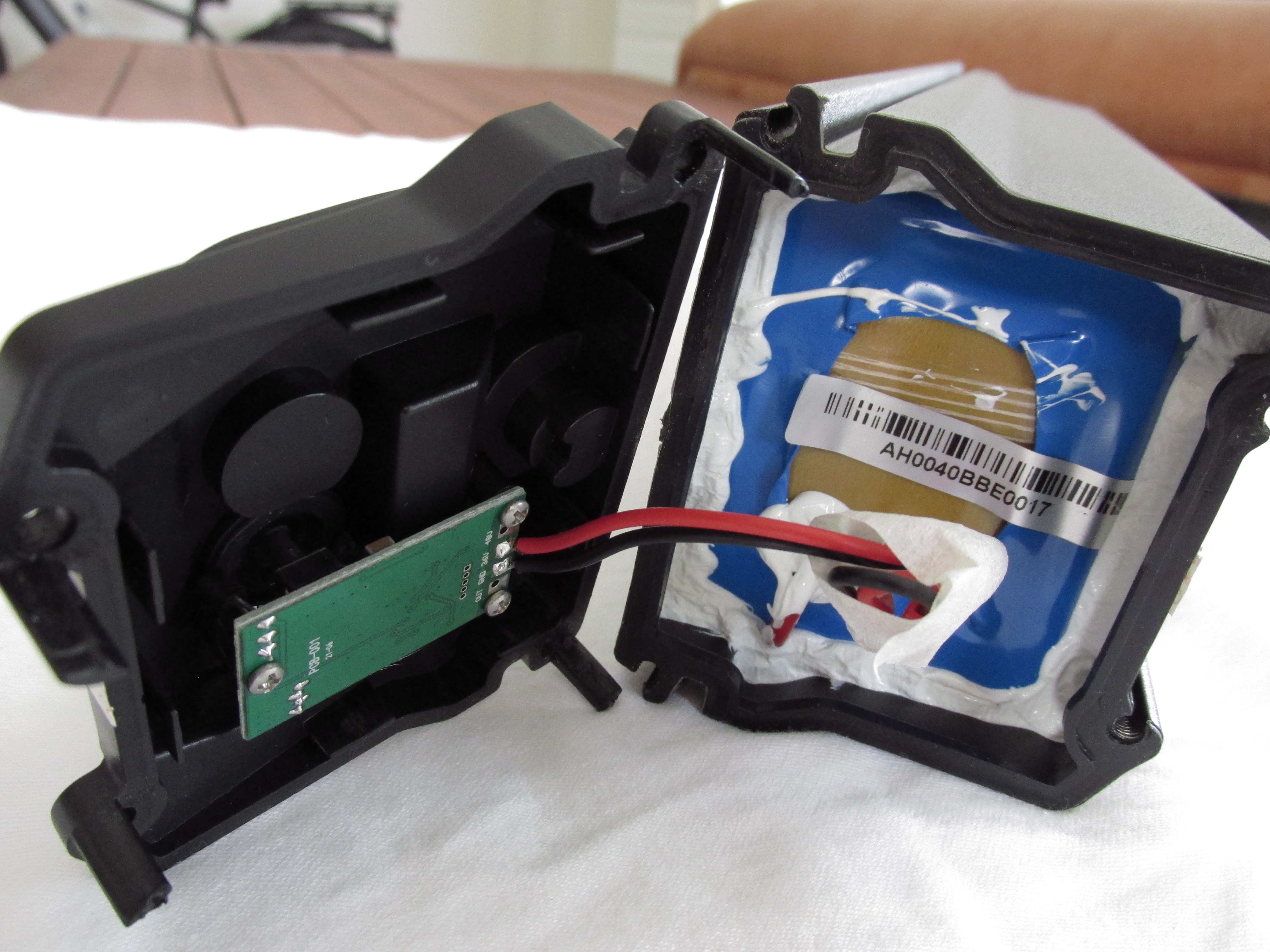

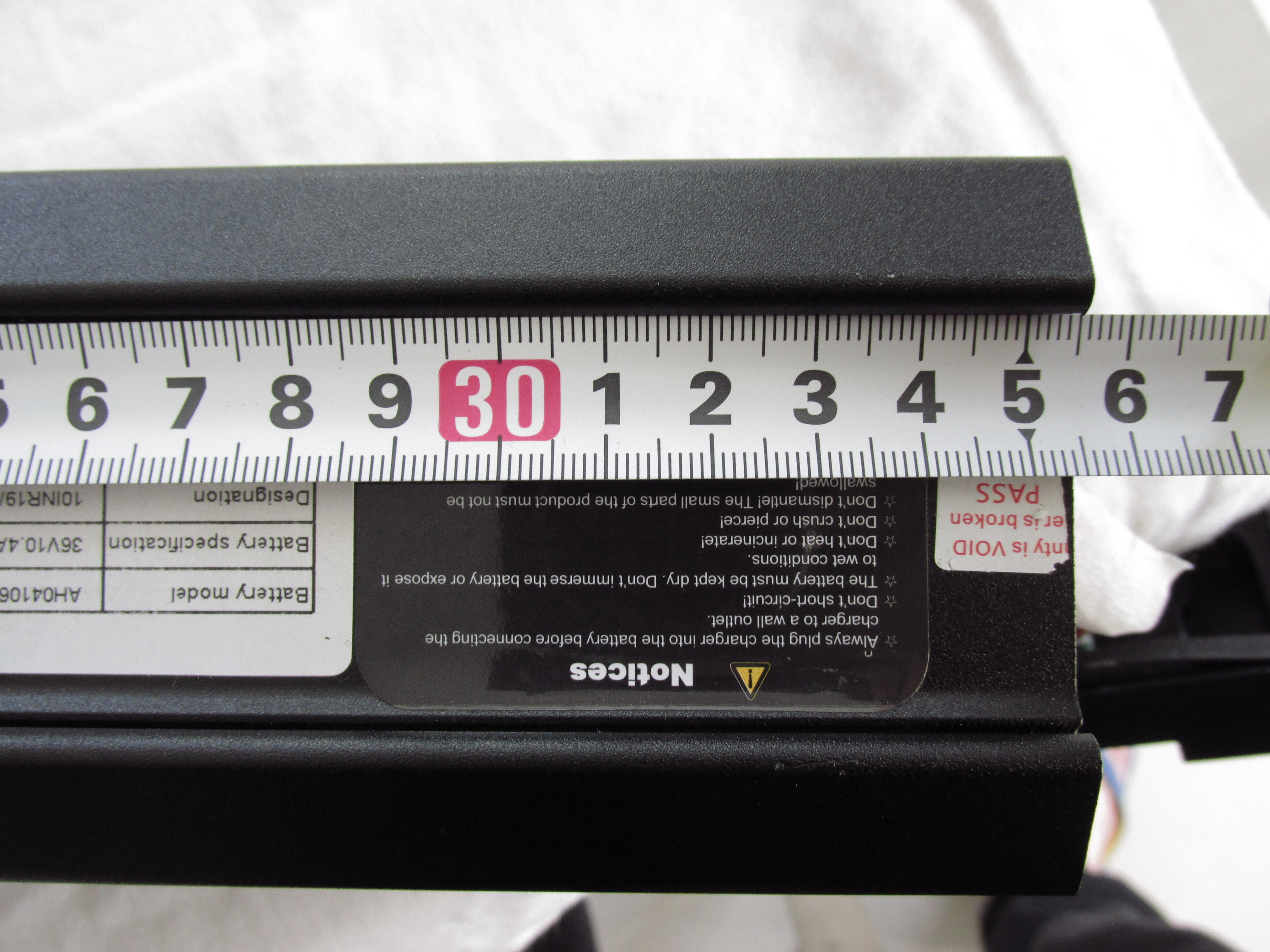

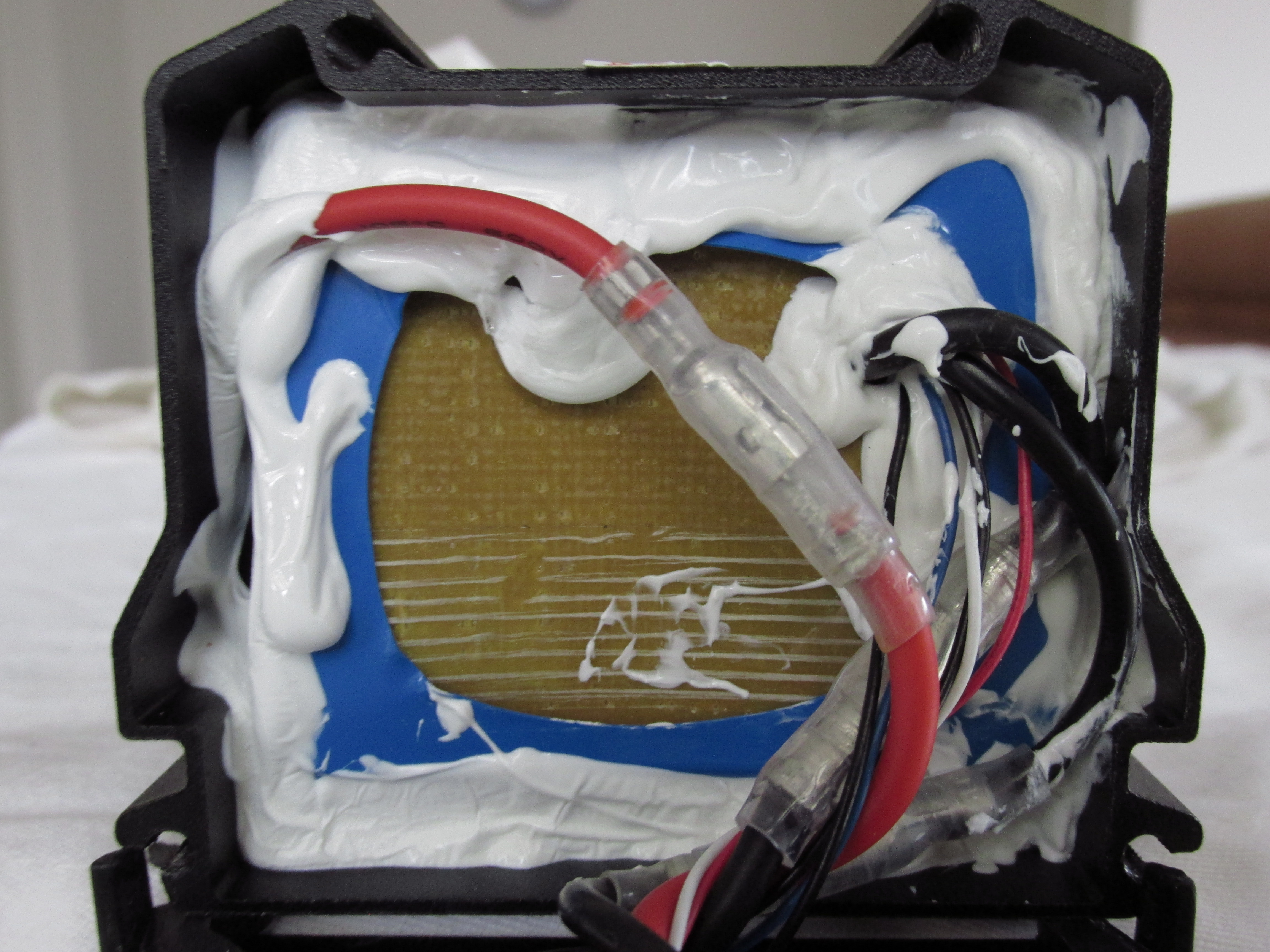

Project Ten - battery upgrade. 10.4A is small these days and the battery cavity is to blame. Battery is 10S4P configuration. 10 x 3.6V = 36V / 40 cells x 2600mAH.
Aluminium extrusion is (LWH) 350mm x 60mm x 70mm. Replacing 2600mAH cells with 3500mAH cells will make 14 AH battery with upgraded Daly 10S BMS but it's a considerable challenge and cost and is the effort worthwhile for a 'low end' bike ?
The 2023 model appears to have a longer down tube to accommodate longer battery rated at 14.5AH battery and it appears a 10S5P configuration.

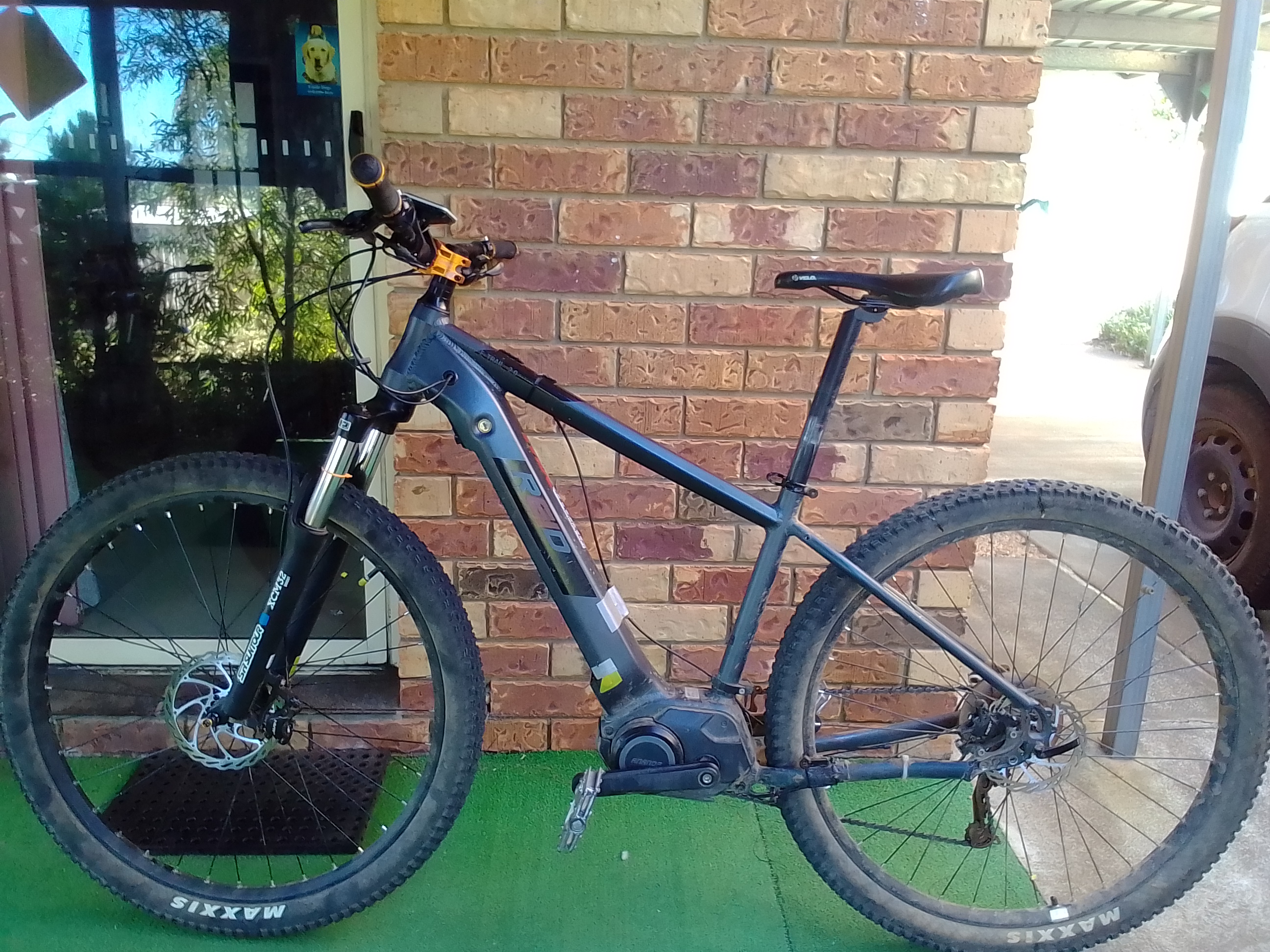

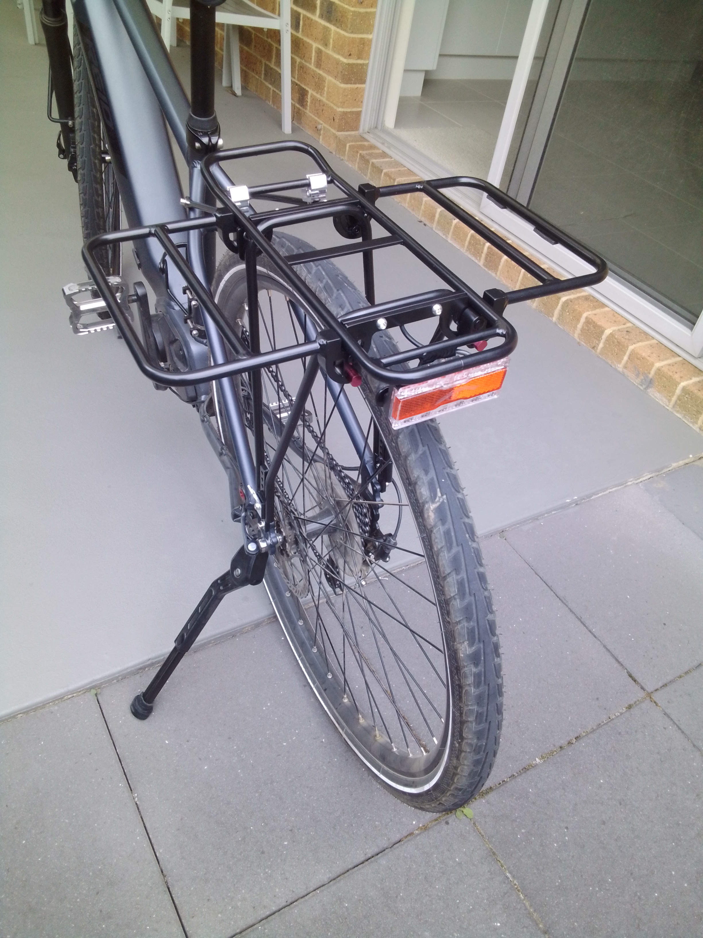

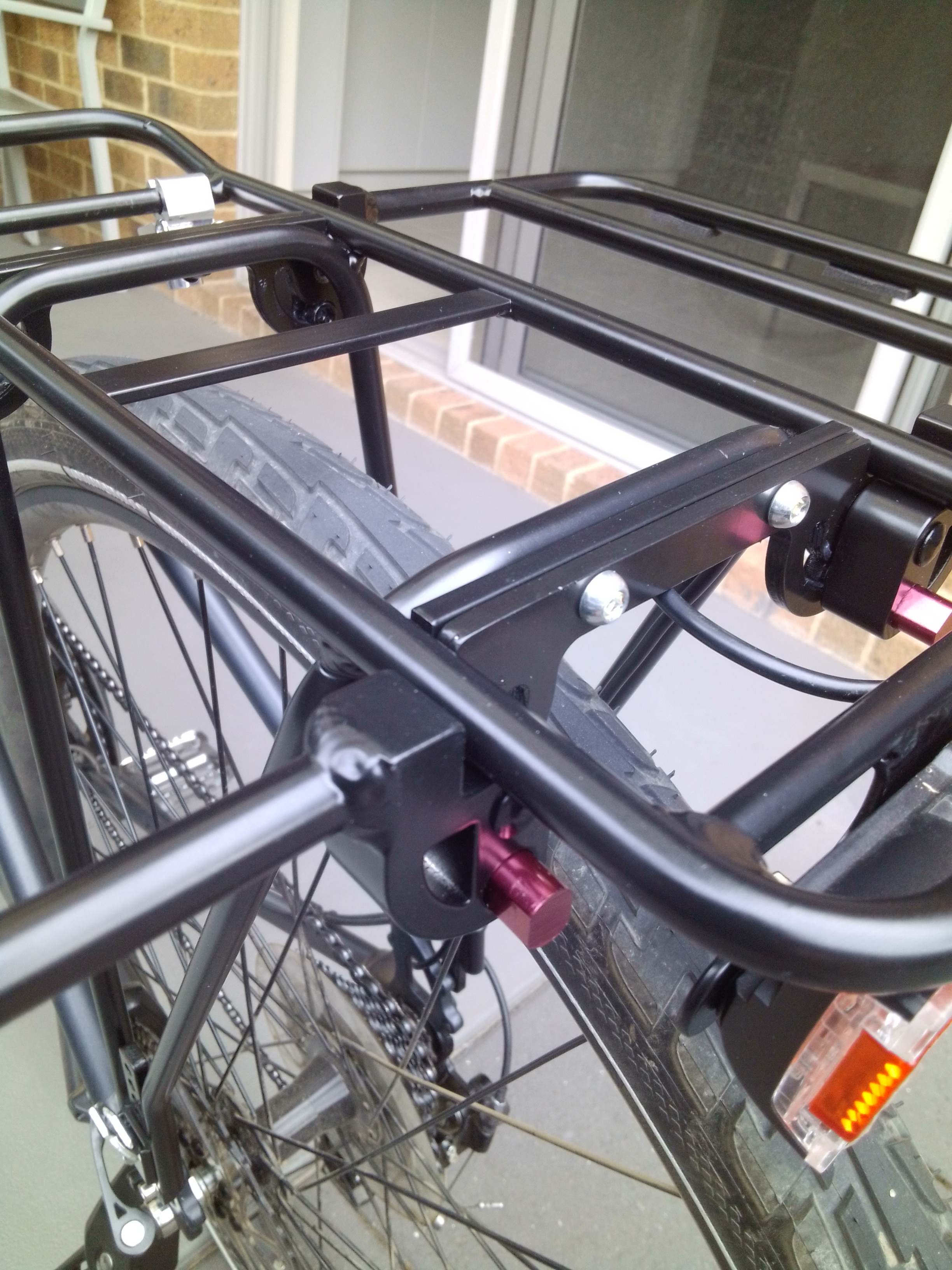

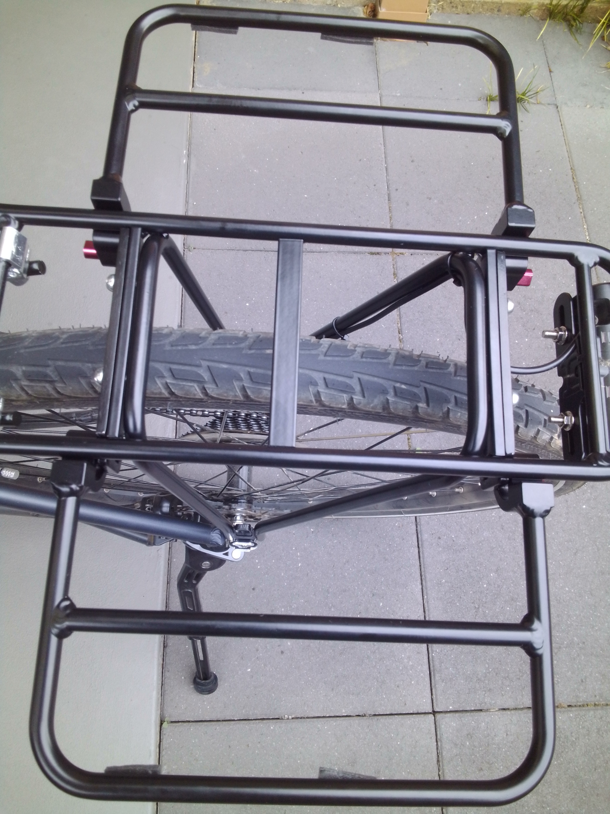

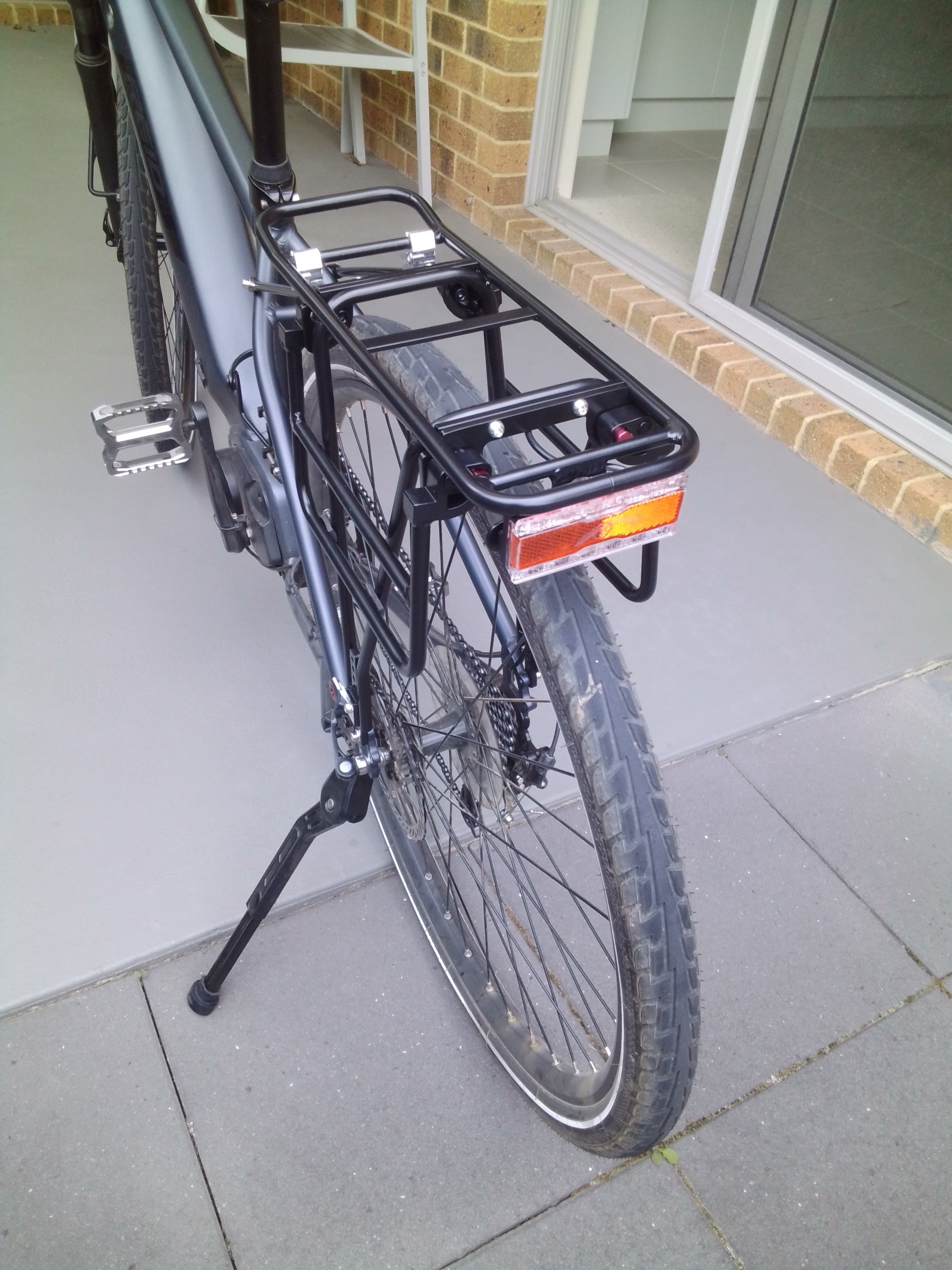

Finally found my perfect rear rack after a 'global' search spanning months... turns out it was right in my own backyard. NZD60 from CyclingDeal. Sturdy well made aluminium frame with lift up wings either side. Perfect for carrying wide loads and offers 3 height levels for panniers. The mechanical lift and click mechanism works a gem and all aluminium. Tail light recess well positioned.
ari
Mar 1, 2024
21
8

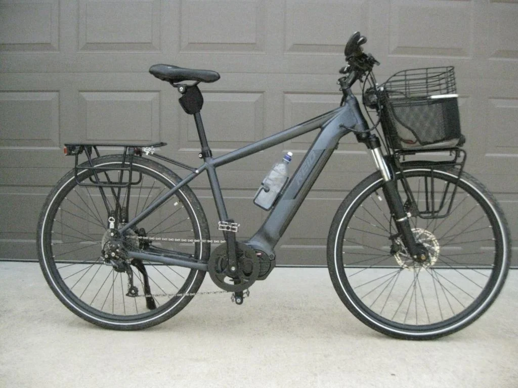

I v been riding and racing one for a year now and 100% agree on your findings, have made dozens of mods just to keep it on the track, so far unbeaten no mater who turns up to race , even on $15000 top end bikes, crazy over powereded motor with terrible everything else..:sick:

Well worn eTrail ! You need to move that speed sensor to the crank (as above) then nobody will get near you on the track ! (Hello 40kph).
Curious about the cable, wire from top tube to rear of motor, is that some mod you would like to share ?

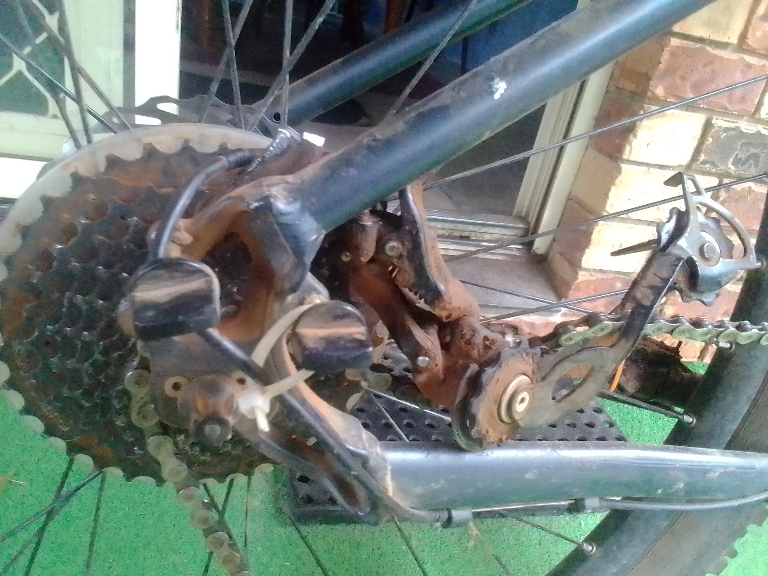

Thats just the shifter cable , because of the kink where it exits behind the motor[straight route ], and also faster to change as it does not last very long .

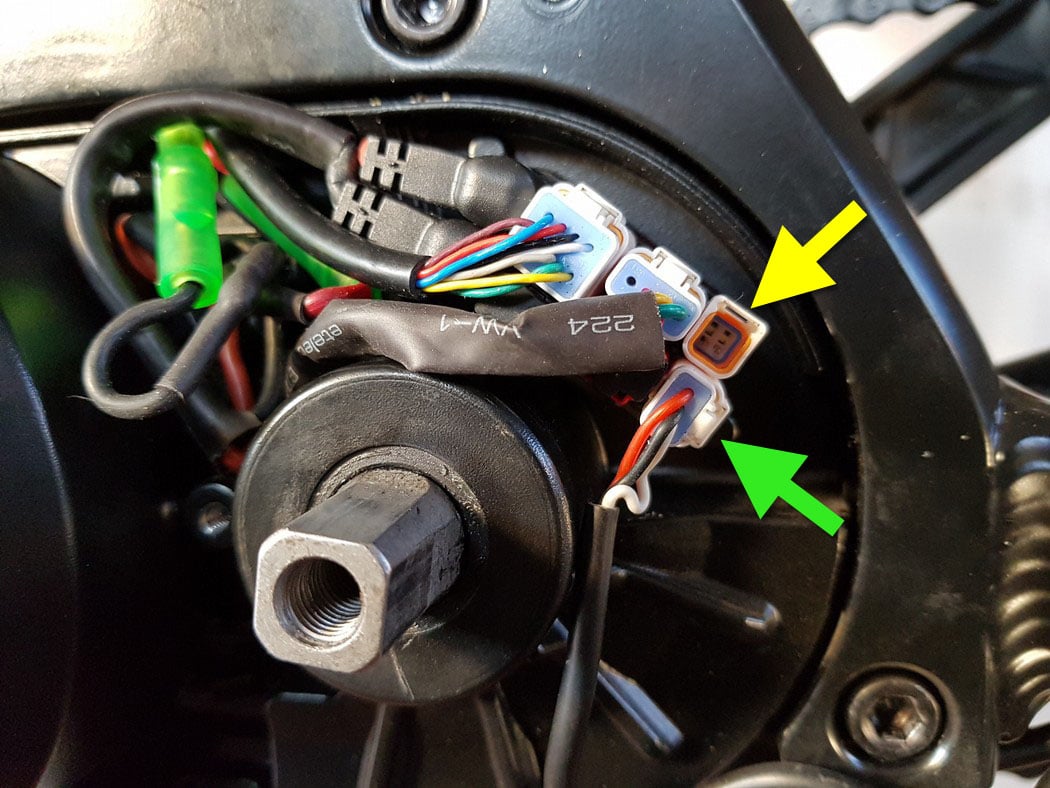

The speed sensor plugs directly into the M100 motor which has a bank of JST sockets which are soldered to the motherboard and then epoxy glued through a 'window' behind LHS plastic motor cover. Not a bad setup actually. Easy access for diagnostics and modifications. Only issue, if board needs replacing, removing the epoxy resin will be challenging. Speed sensor cable appears standard Giant, 3 pin JST. (Green arrow sensor, yellow arrow 2 pin 6v lights).
Awesome , thank you very much. I ordered a universal sensor from ebay[ $15] and the plug looks the same, i might be lucky and it will work.
