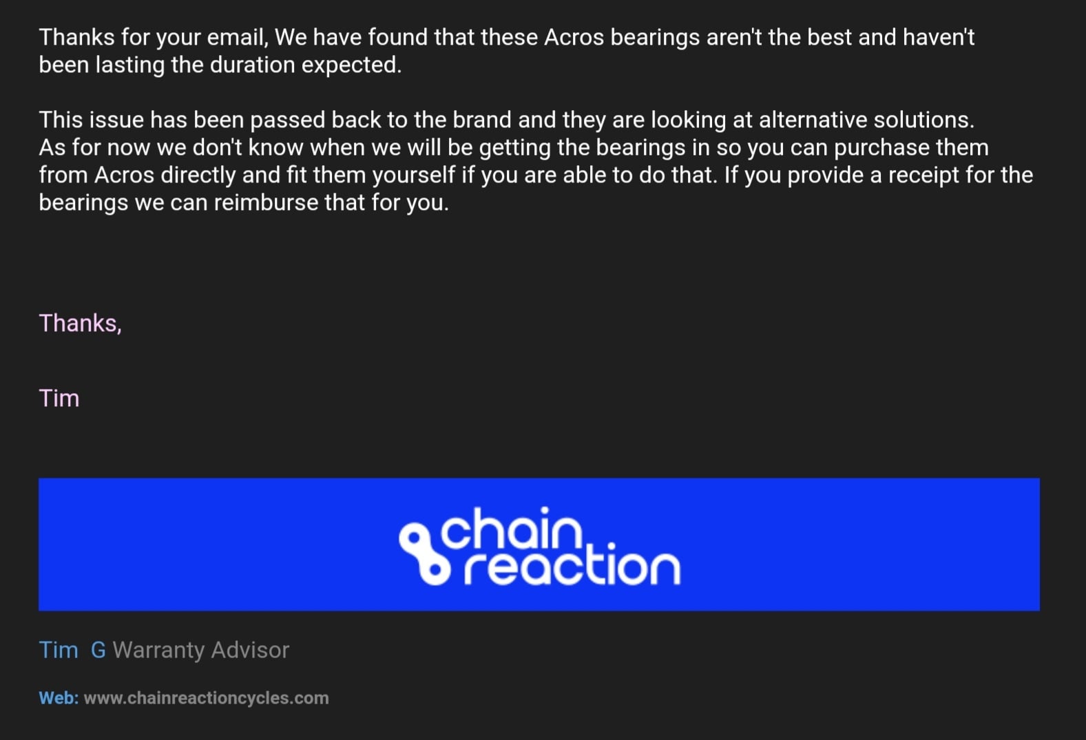

Crc know this is an issue, they admitted it.
I'd give them a shout and ask for a refund.

When you say CRC admitted this, where and is it accessible to all?
