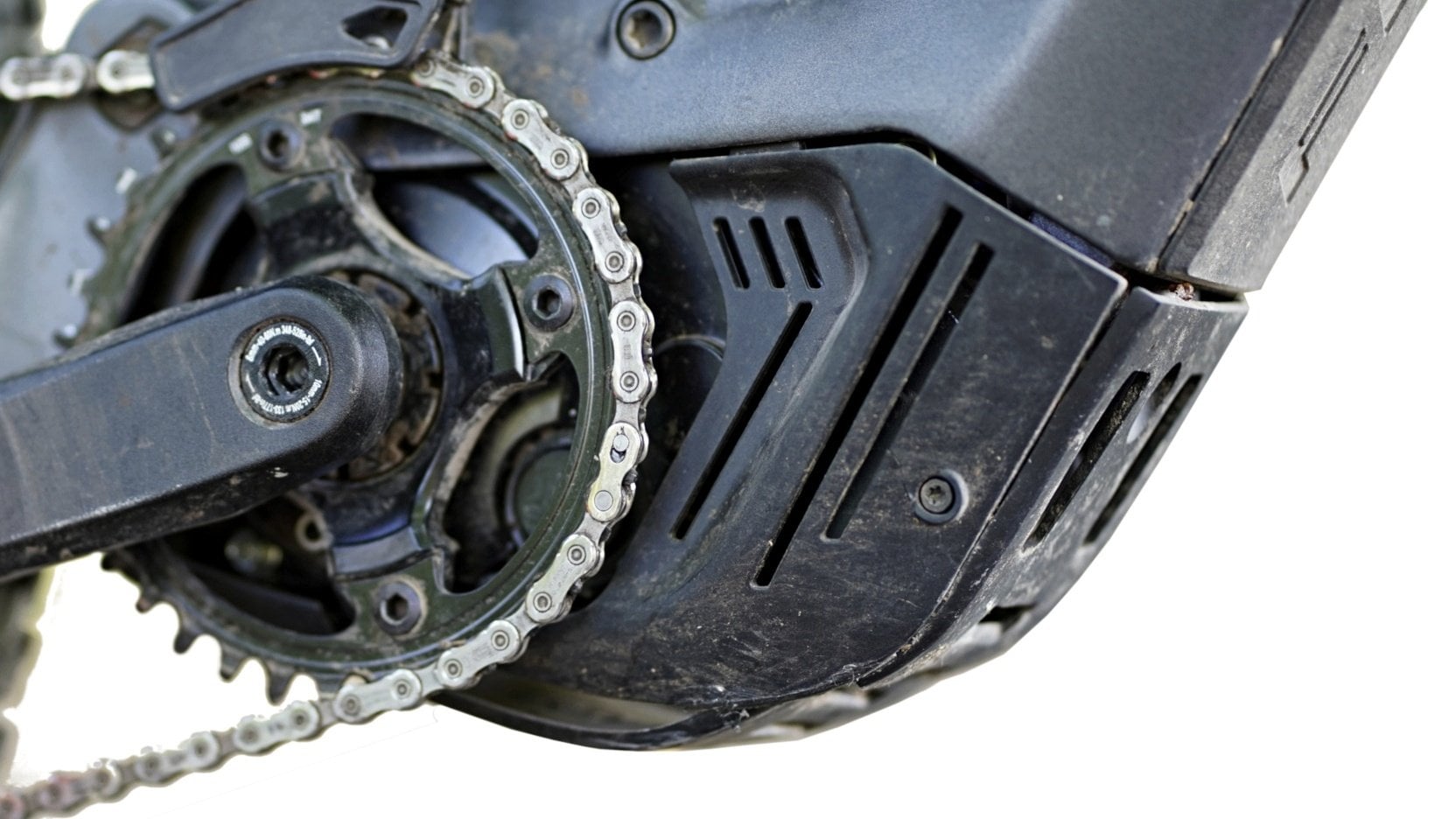

We've tested Panasonic motors twice before. We recognize the motor characteristics from the older motors, but there are some significant differences too. The old motors were powerful, but they were also a bit chunky. The GX Ultimate is more lightweight and compact. The q-factor, the distance between the crank arms, is down to a normal 165.8 mm. This 2.95 kg motor is rated at 95 Nm, making both power and weight highly competitive.
Panasonic motor specs

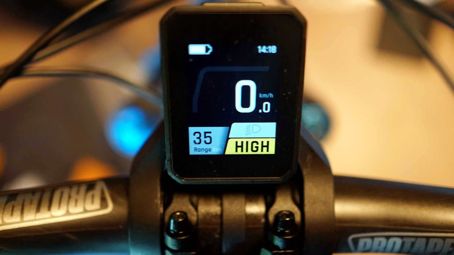

Panasonic color display
