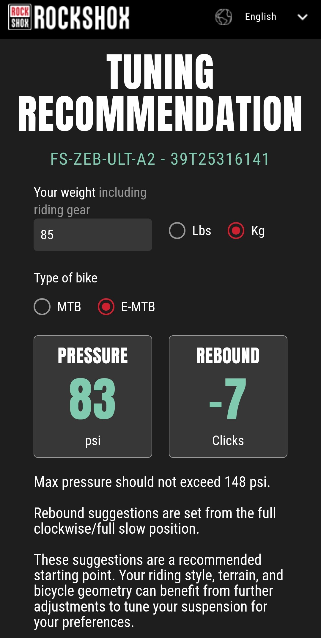

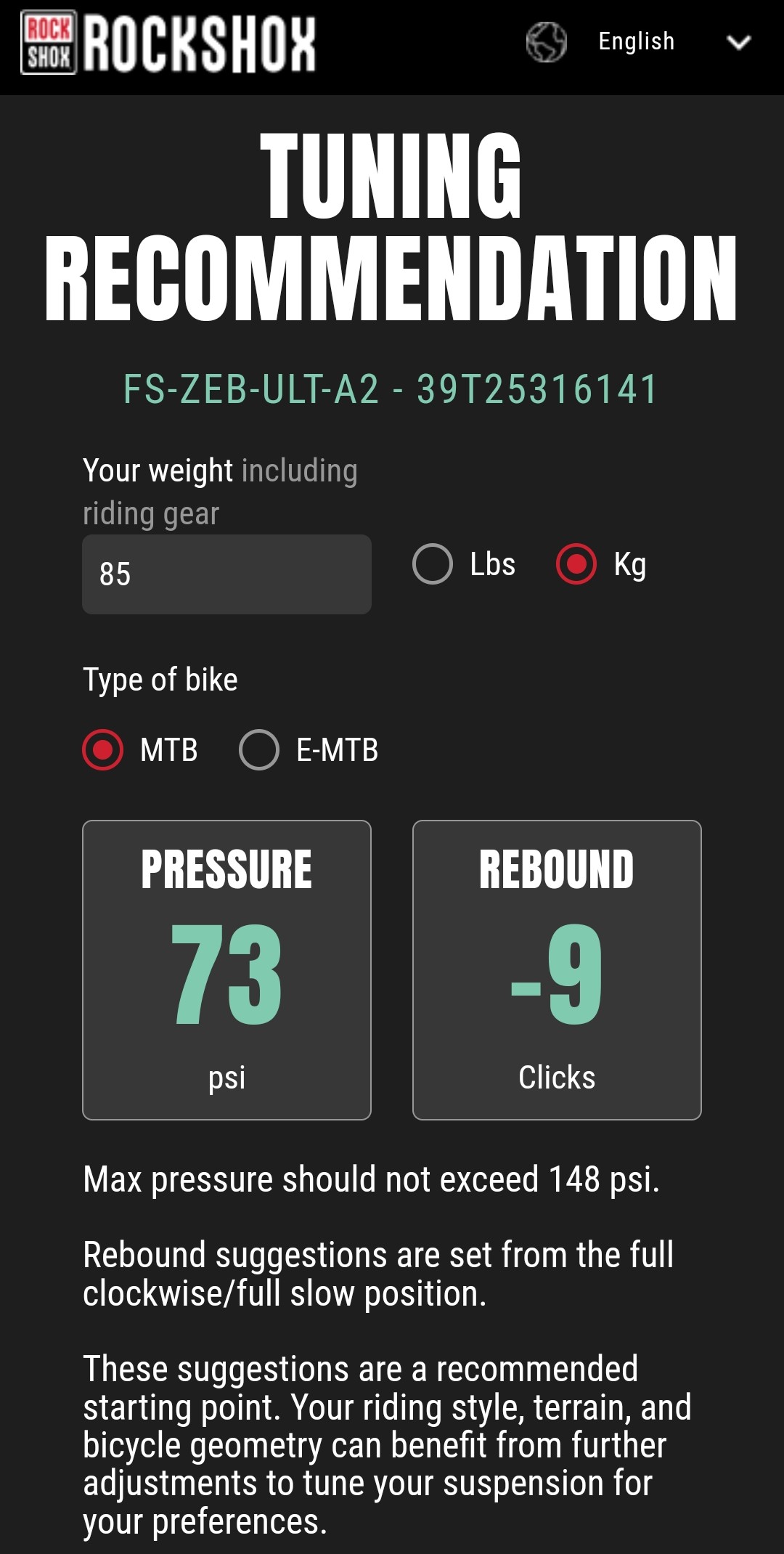

Download the Rock Shox app, gives you a base setting for air and rebound.
If you use Rockshox Trailhead, stick in your forks serial number then go to tuning, the recommended base air pressure setting for eMTB for your weight is so high that you end up with ridiculously stiff forks!

I am 85kg/187lb ready to ride (you are 109kg). As you can see for me Rockshox Trailhead recommended 73psi with MTB and 83 psi with eMTB. Same result for online and the App.
ZEB Ultimate tuning recommendation - MTB.jpg ZEB Ultimate tuning recommendation - eMTB.jpg
