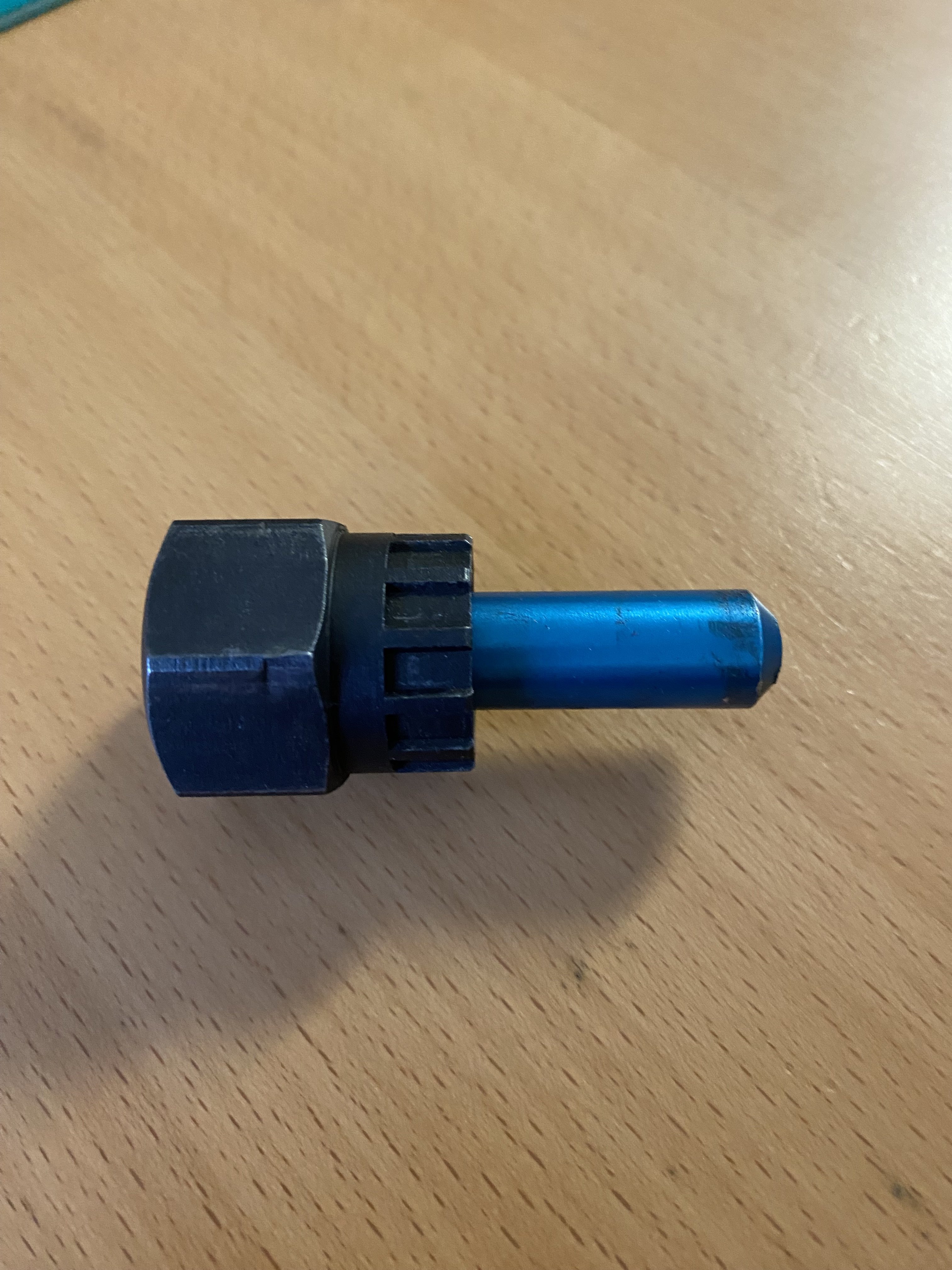

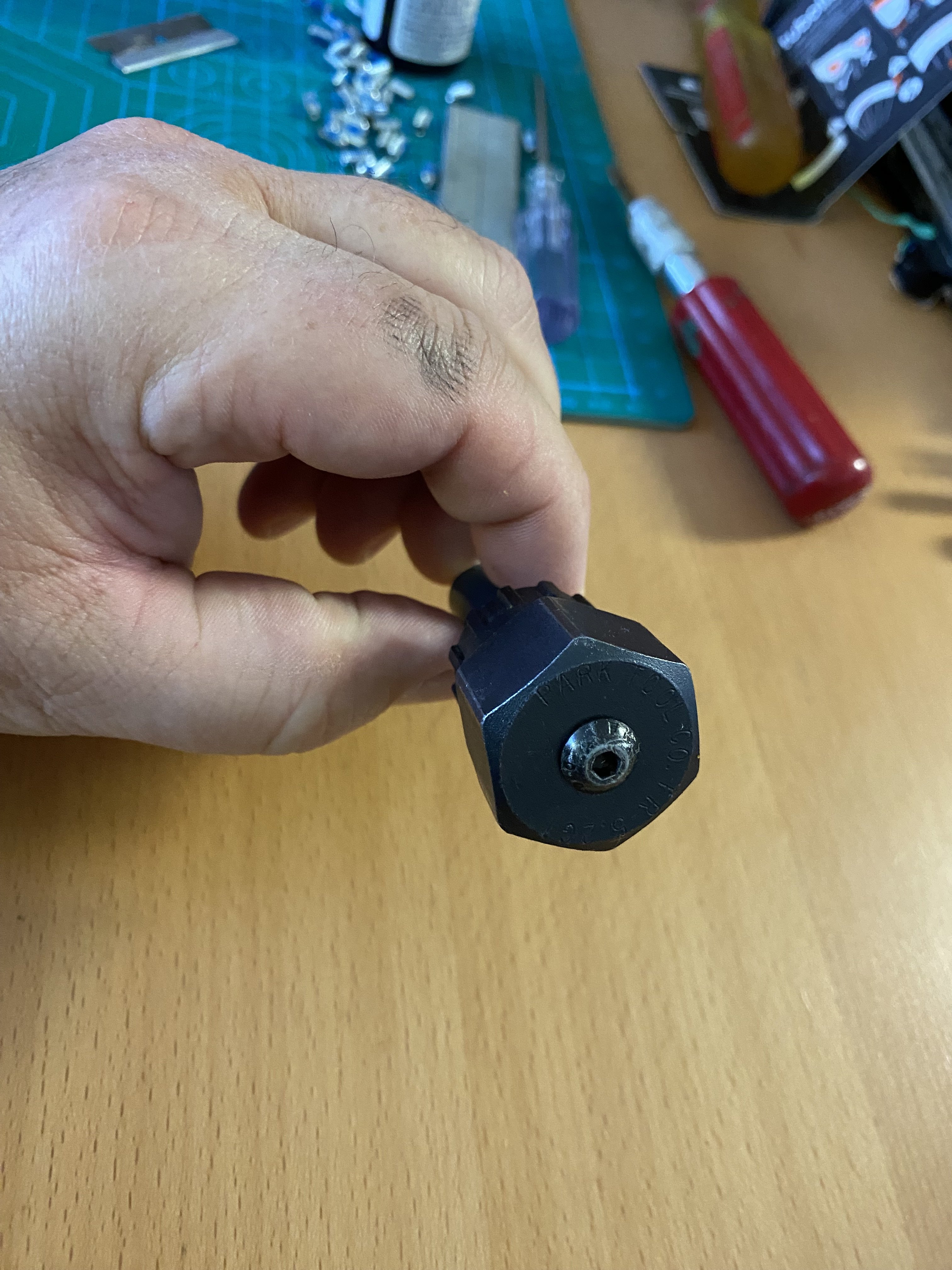

Oh and be careful with the O ring, easy to snag and damage (from experience ?)
Hang on, have the Zeb manual here....Top caps...24 mm socket or RockShox Top Cap/Cassette Tool (or standard cassette tool)...28 N•m (250 in-lb).
So, just a standard 24 mm socket will do it?
My 24 mm cassette tool has a centering rod for the cassette and is useless for my ZEB top cap. Easier to get a socket at my local hardware store than order online for RS top cap tool.
Thanks again for the confirmation.💪

Those using a standard socket to loosen the top cap on the fork, be cautious! The flats on the top cap are not very big at all, whereas the inside chamfer on the socket is quite large. That chamfer is to clear the radius on steel bolts. What you have left for engagement is really small and the top cap is soft aluminium! The last thing you want to do is to round off the top cap!:eek:
Take great care, press down on the socket to ensure max engagement. But best of all, grind the socket flat and remove the internal chamfer. I borrowed a mate's hand-held grinder and I thought it would take ages. It took less than a minute and I was being really careful. It took longer to rub the socket across a honing stone to smooth out the grinding marks.
TCFlowClyde
Feb 26, 2022
1,326
861
Mesa, AZ
Those using a standard socket to loosen the top cap on the fork, be cautious! The flats on the top cap are not very big at all, whereas the inside chamfer on the socket is quite large. That chamfer is to clear the radius on steel bolts. What you have left for engagement is really small and the top cap is soft aluminium! The last thing you want to do is to rpounjd off the top cap!:eek:
So, wiser to go for the RS tool itself? I'm fairly clumsy.
Thinking easier to go to the proprietary tool out of caution.💪
