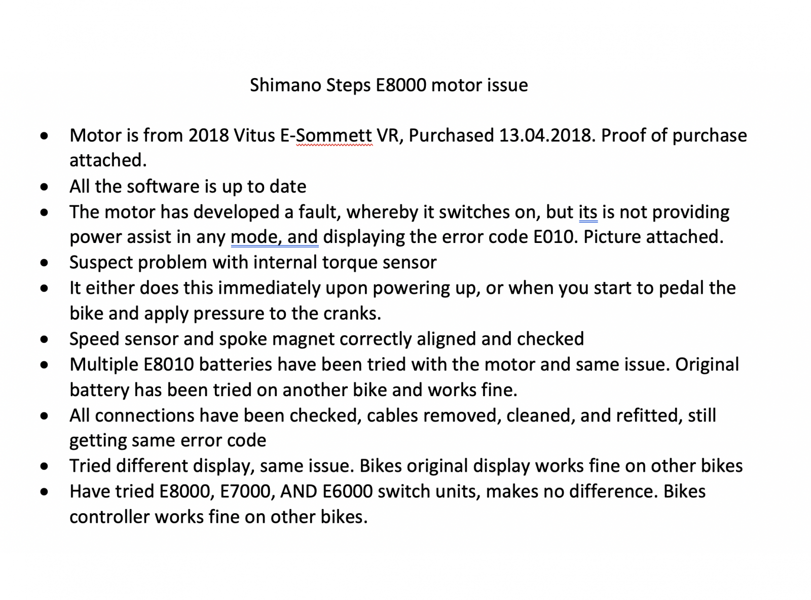

From recollection when I had my motors warrantied the LBS had to go through a set series of checks of each element of the system to eliminate problems that could be fixed at the LBS , before the motor gets sent off. A key one is checking the battery isn't the issue
This is the note that went off with my motor, that I did for my friendly LBS as I did all the checks myself, but the warranty had to go through an LBS with a Madison Account. Its a pretty accurate description of the on site test an LBS should do.

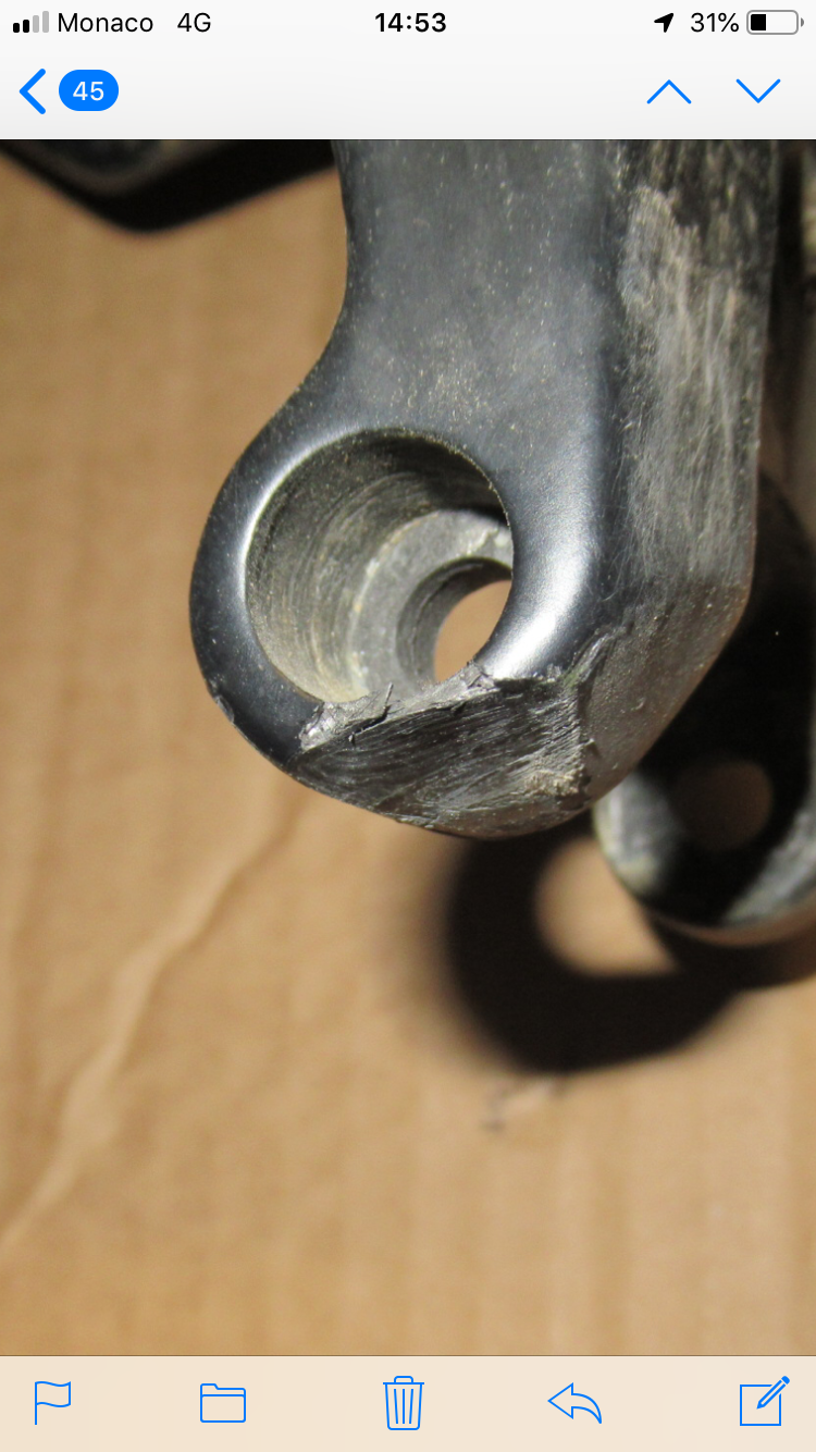

Not sure from your photo what part of the frame is damaged but, without trying to resolve from a legal point of view, could not that damage be repaired by a competent ally welder?

I had 3 YT Capra frames, all cracked. They lost my Bos shock, and forks went away for service and disapeared while at YT. I got a full refund after 9 month.
...without not...that should have read
Its carbon.

yeah, a far easier repair
It likely wouldn't fail there anyway but that is not the point I suppose.
Nobody knows how it was transported or how well packaged. If it was dropped by YT or damaged by courier. 7 weeks is insane and it's their liability in more ways than one.
