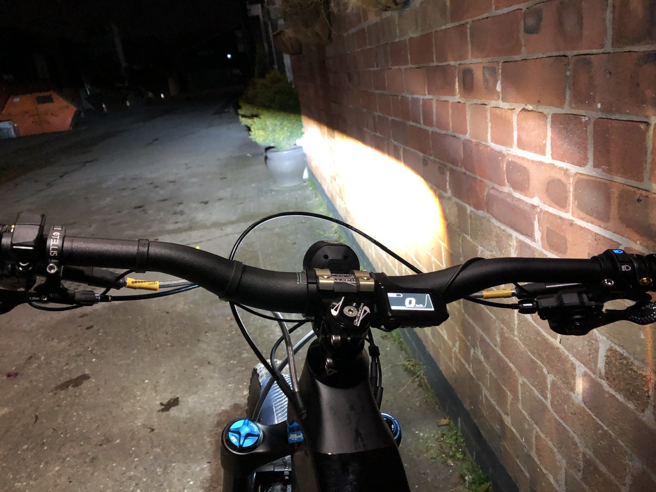

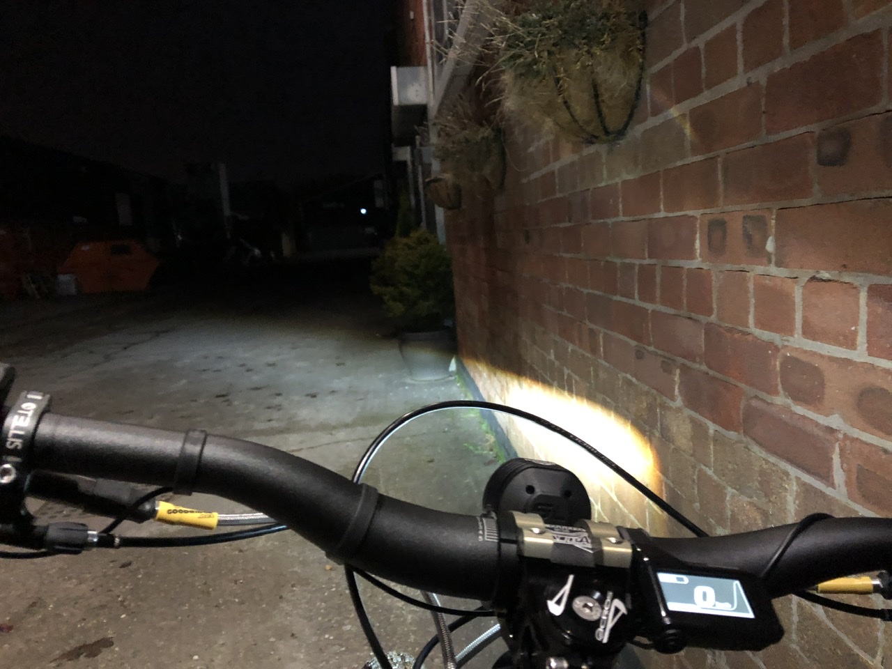

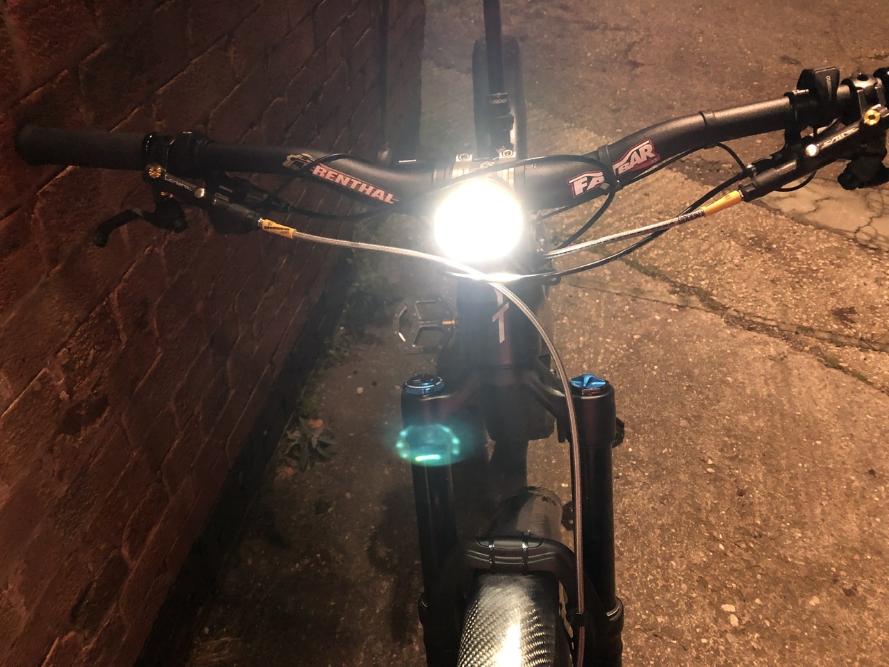

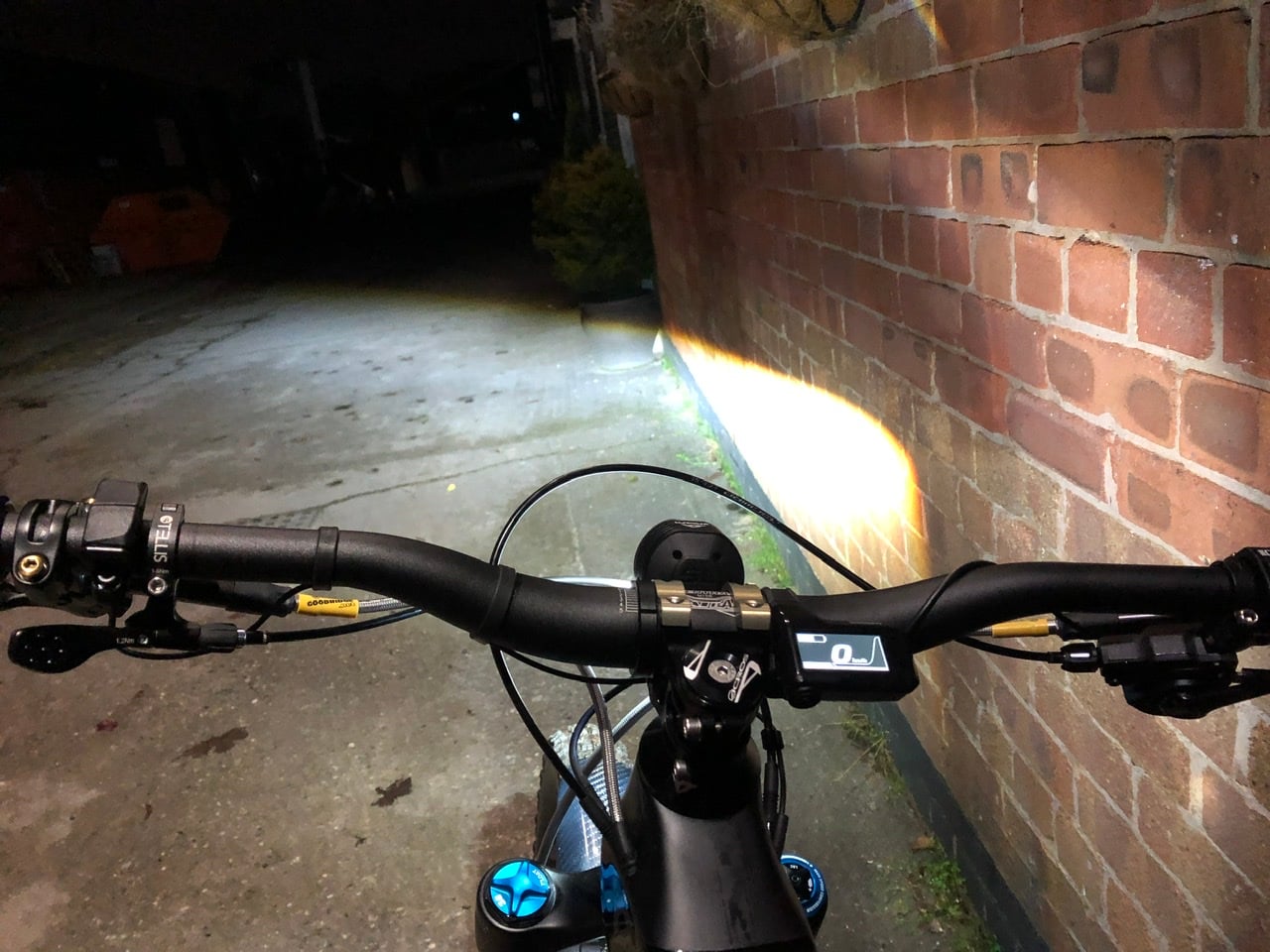

Been running the light this week and it’s ok definitely not the brightest but I like the way it works and it’s great and not dazzling on-comers. The only thing I don’t like is the light comes on automatically when you turn on the bike, maybe there’s a way to stop that? Anyway the pics below are the 3 levels.

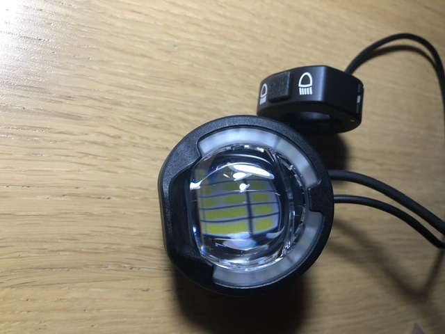

Got my light and installed today. Order 1st day in US. Didn't have a spare YT grommet for wire so just made 3 layers of shrink tube. Bar mount is on left of stem and have Garmin 830 next to that.
Must enable light in app and also then also on 7000 display....then light will come on.
Bit expensive, but fits and works great. Perfect for my needs.
