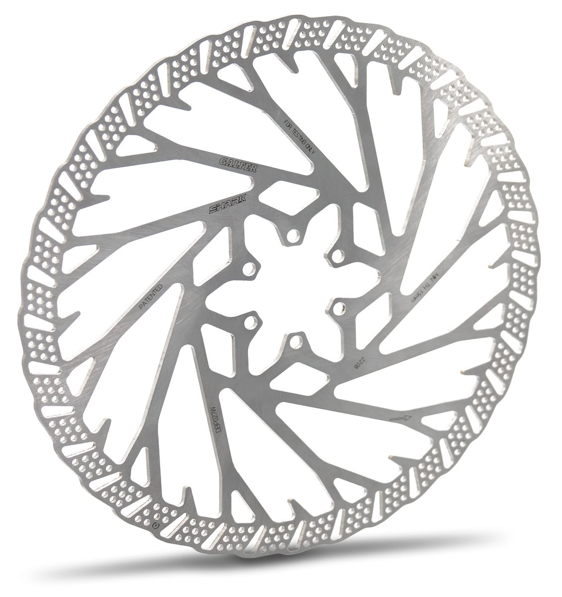

Has anyone tried the newest Galfer "Shark" fixed brake rotors? πŸ€·β€β™€οΈπŸ€·β€β™‚οΈ
Galfer claims these rotors offer increased braking power, more stability/stiffness, and better resistance to heat/fading.
They are fairly expensive (~$90), come with 2mm thickness in multiple sizes (180, 203, 223mm), and they seem to be targetted for higher-end DH/Enduro markets. They also have a very distinctive (attractive?) shark fin like design! :cool:
I couldn't find many reviews out there yet. So very curious If anyone fitted them and how they compare with other high-end rotor models from other brands.

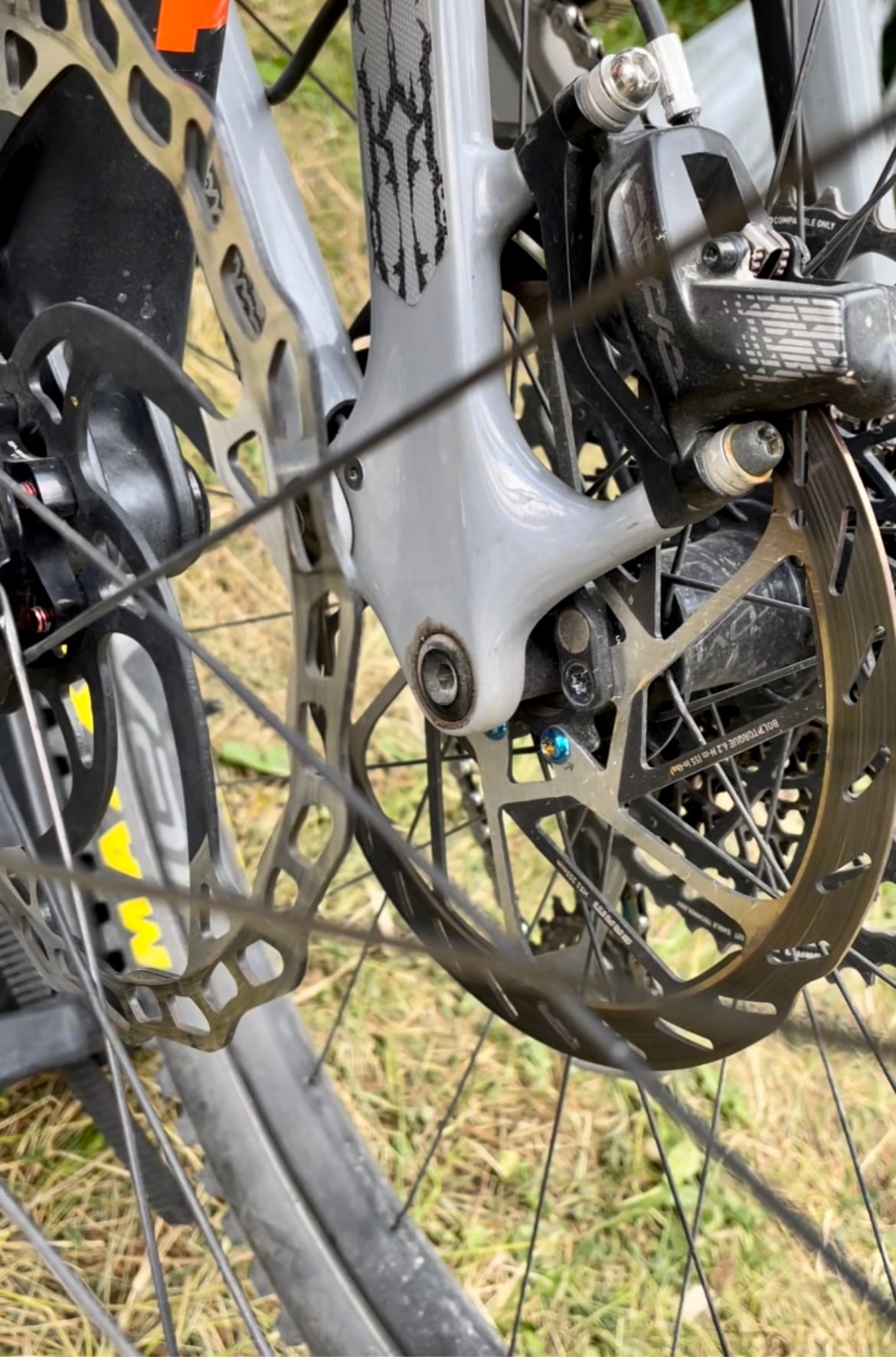

I have been using Galfer rotors for several years. Here's a good picture after the 2022 Alp trip Galfer vs. Sram HS2. The color of the Sram has already changed quite a bit, i.e. burnt.
But I have no experience with the new shark fin model, is that much better than the price suggests.

@steve_sordy, on the material they used for the Sharks, here are the specs I found:
  • Made from a proprietary mix of virgin High Carbon 420 stainless steel
  • Heat treated
  • Precise laser cut
  • 2mm thickness
  • Friction ring width 15mm
  • 237g for 223mm disc
  • 168g for 203mm disc
  • Actually made in Spain!
galfer is in front wheel, sram disc is in rear wheel, so its normal to be more overheated in the rear.
