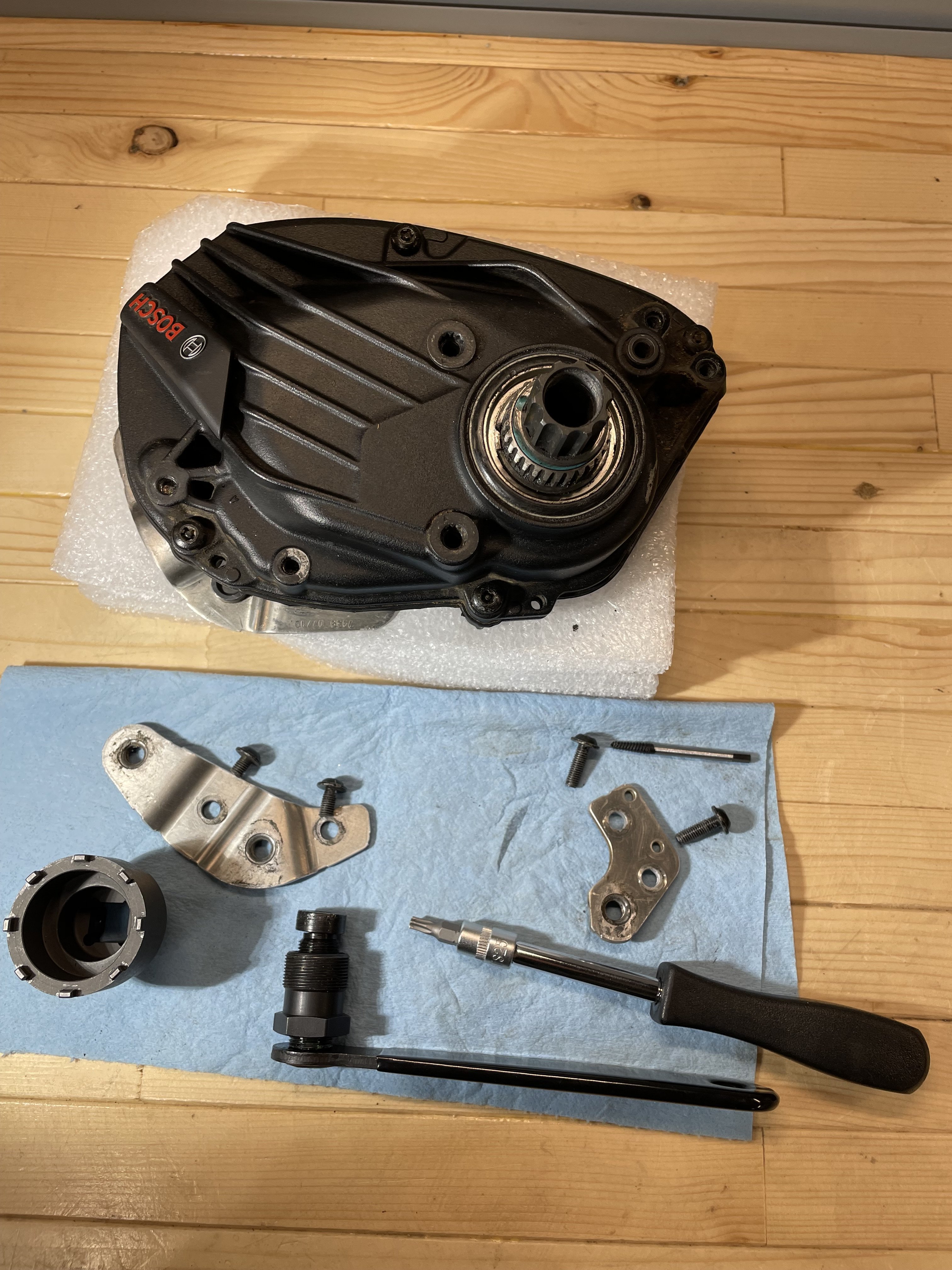

I can confirm that this happens. This is my neibours original motor where the bracket bolts sheared off on the drive side only. He had to replace the entire motor without warranty. Trek Corporate claimed this was a result of peddle strikes.
I intend on replacing the motor housing and the brackets on the drive side but so far the parts are not available to me (CDN). Btw, $800 for a replacement motor.

Can you not just extract the broken screws ?. Then replace.
Easier said than done. I have several easy-outs but not one small enough. It seems as though the threads are damaged also. Likely from movement until the bolts finally sheared off. The mounting holes in the bracket appear to be reamed out also.
It doesn’t seem like removing the broken bolts are/is possible. The casing is white metal or magnesium I think and the holes are very small.
I intend on replacing the motor housing and the brackets on the drive side but so far the parts are not available to me (CDN). Btw, $800 for a replacement motor. View attachment 112739
Does anyone know if there is anything specific to trek here or if its effecting all the brackets that are bolted to Bosch gen 4 motors as the 3 bikes ive had with this motor cube ,orbea , trek all have had brackets bolted to the motor in this way
They are pathetic looking bolts considering that the bracket to frame bolts are substantial in comparison .

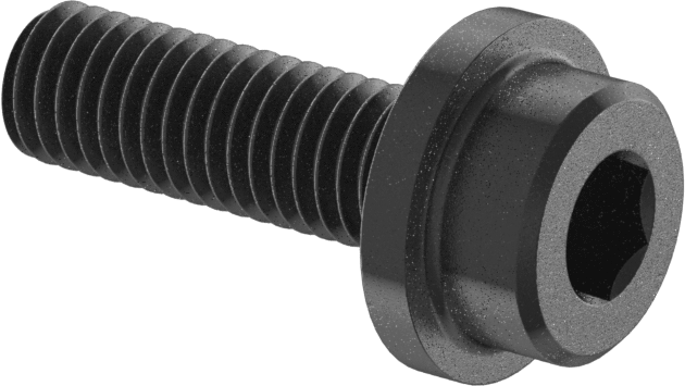

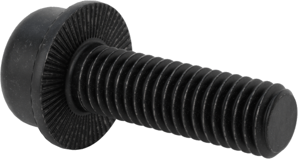

I had two bolts cracked. I'm confident to say that it's not about the bolts getting loose. It's more that the M5 is too thin for the use. The new version of the motor has M6 bolts.
Getting the bolt off the motor can be very challenging. I had to put helicoil to the other thread. The alumininum/magnesium cover is very soft around the bolt.

The hardest part for a average forum member could be to get hold on the security PLUS torx bit that you need for tightening.
Btw the brackets are part of the Bosch system, not Trek specific.
