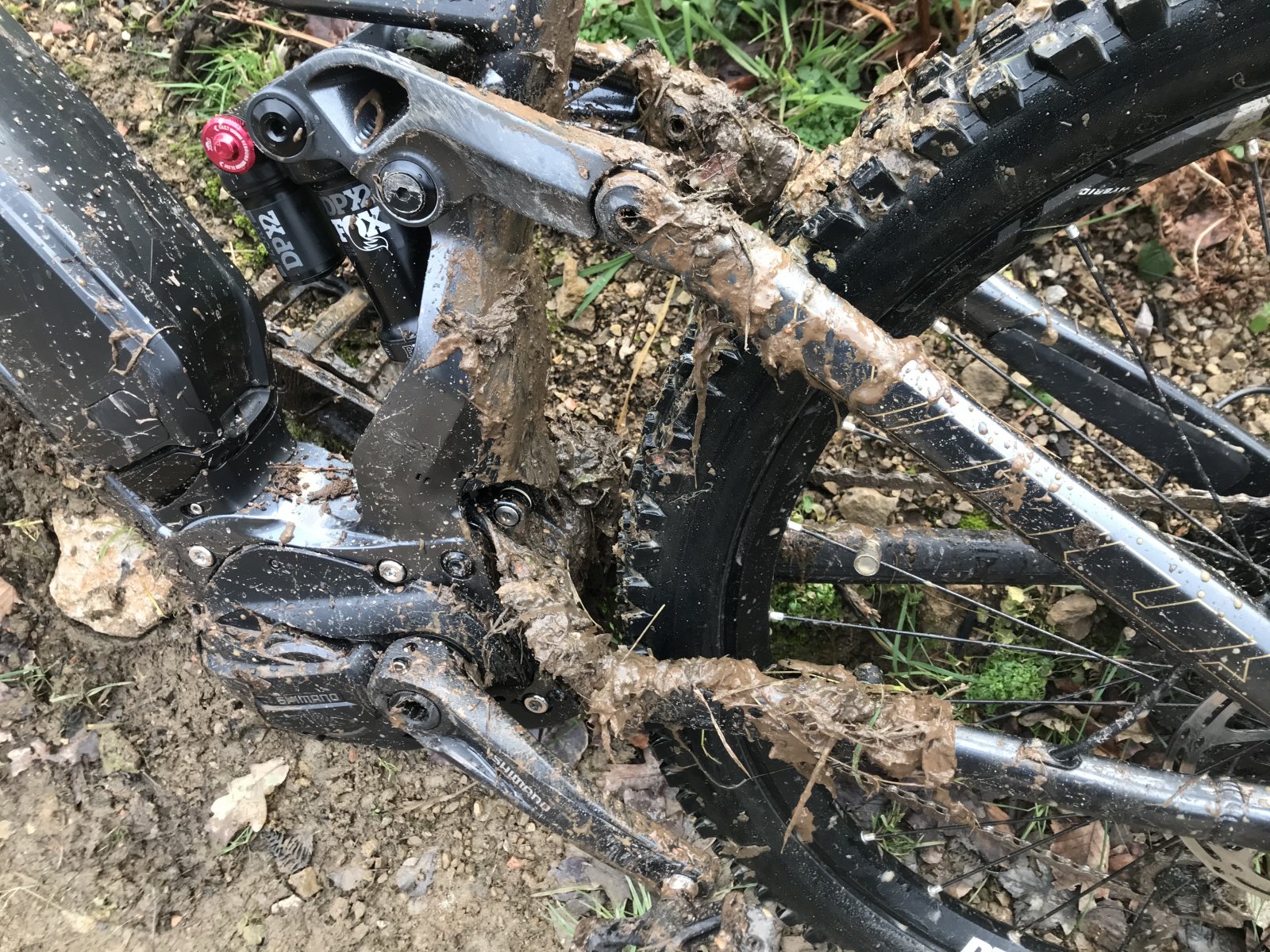

After a few rides like this...

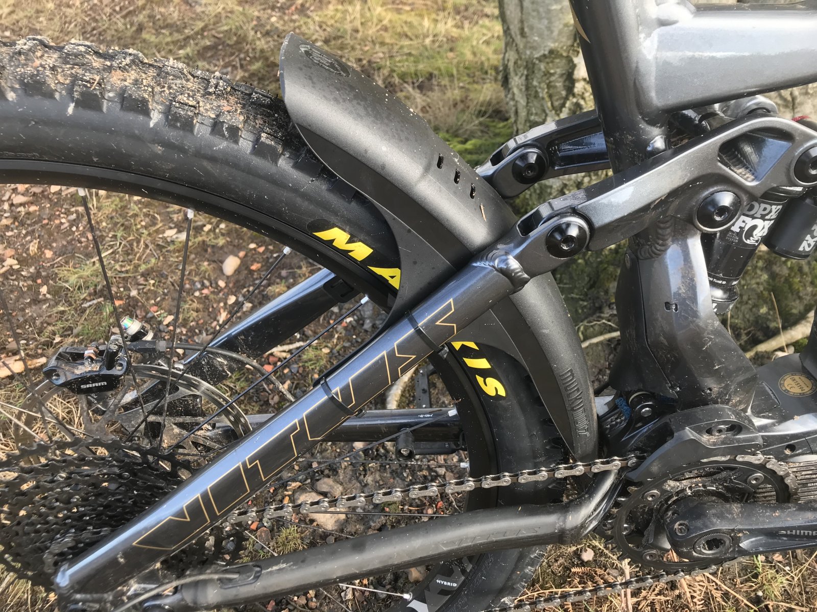

I was having severe motor anxiety and getting well bored at trying to clean/remove two thousand bits of debris out of the mud pocket ( despite moto foam and rubber shield) and around the motor area so fitted this
Its a Mucky Nutz short front guard turned backwards. Its not to keep my back crack :eek: dry but to protect the motor and bearing area. I've added heli tape where the guard touches and so far it seems pretty good. No pics to prove as yet so we'll see how it goes.

Sweet.
I have a RRP front mounted similarly. I've also added 3M mastic between the the inside of the stays and the guard plastic as no matter how well ziptied it is it WILL move if conditions get so muddy/sticky that the rear wheel clogs between the tyre and guard.
