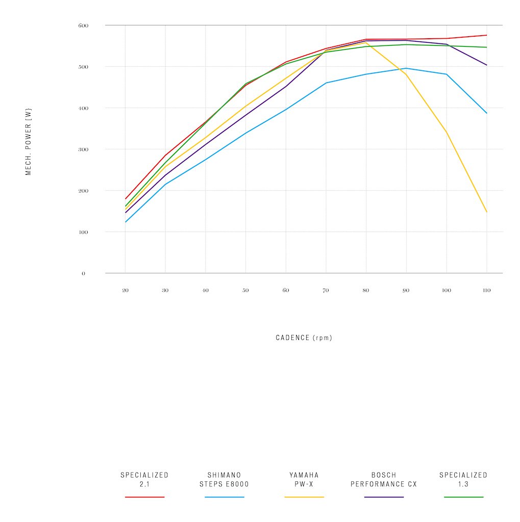

Thanks for the measurements. I agree with your conclusion as I hate spinning as well but it feels more powerful at a higher cadence. I'm guessing the PW-X2 curve doesn't drop as quickly as the PW-X shown in this graph from Specialized;
There are so many variables: weight, terrain, pedalling style, tyre pressure etc. so everyone is going to experience things differently. I'm happy anyway!
