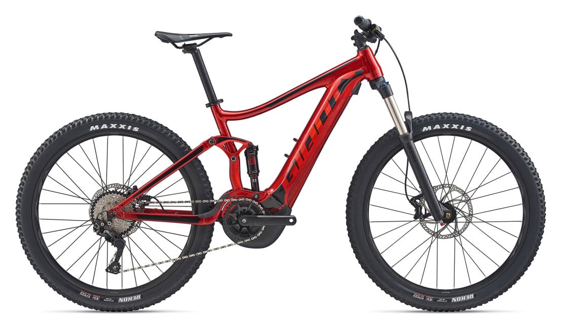

HOW is Auto Mode enabled?
Not clear in manual.
What indicates that it is ‘on’ ?
I got it from my excellent bike shop yesterday & my initial impression is only marred by my ear to ear grin!!
Press the left bottom button after you turn the bike on - like expecting to reduce power assist level - and after going to zero, press again and a led will light up between the battery and assist led displays. It’s not logical but you soon get used to it. Let us know what you think ?

Worked first try!
I don’t think I would ever have decoded the manual’s instructions to the actual procedure!
Many Thanks!

Found this via Google. It's not an exact match but might go some way to explaining it
Power assist ‘AUTO’: The motor automatically detects the amount of support the rider needs. The combination of the PedalPlus 6-sensor technology and the instantaneous response of the SyncDrive Life motor creates a smooth and powerful riding experience. It maximizes energy efficiency for both the rider and the battery system, optimizing power depending on the slope and saving power on flats and descents..... ‘AUTO’ assist level is indicated on Charge and EVO displays via power assist indication (G). On RideControl ONE, only the middle power assist indication LED is constantly engaged.
