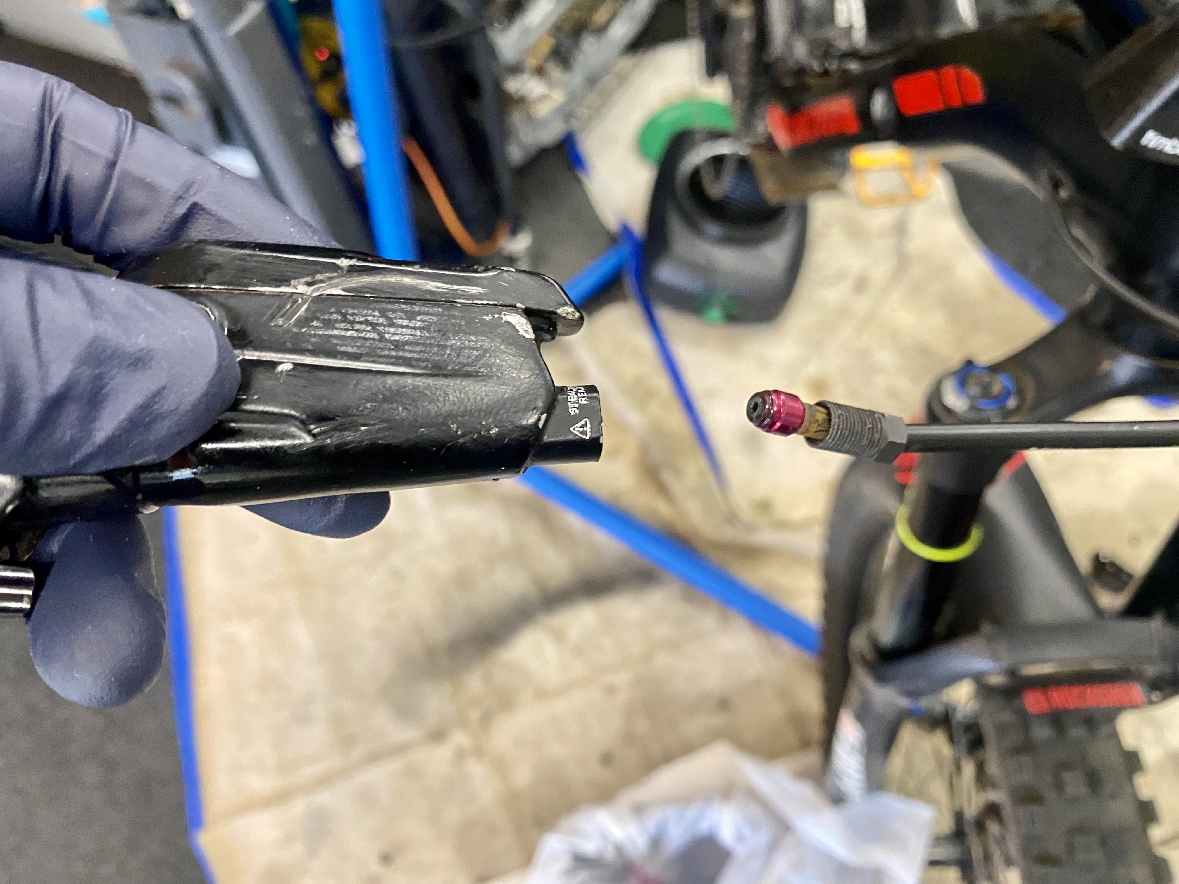

I just pulled the RSCs off my Levo Pro, they got replaced with Hope Tech 4 V4s. I haven’t ridden them yet as I screwed up when I cut the hose so I’m waiting on a new olive/Barb. I had ordered TRP DHR Evos but after a screw up with shipping I canceled and went with my other choice.

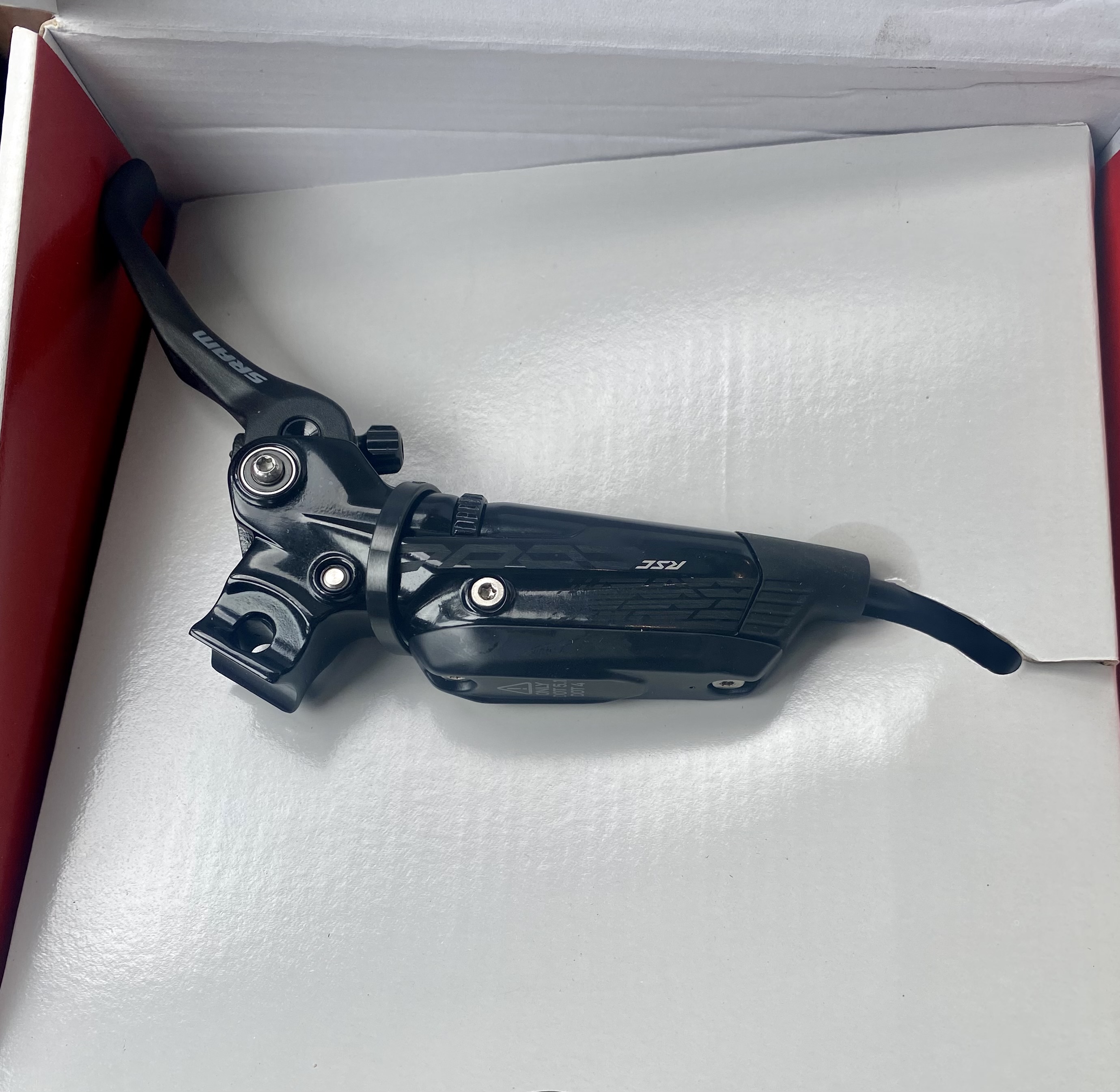

On my Gen 1 Kenevo I replaced the OEM Code R which had over 11k miles with RSC take offs but new and should have done it years ago. As you can see I definitely got a lot of use out of the OEMs but regret not changing from the start.. @Mikerb gives a great description of why, but especially on eMTB where the pad wear is so much faster (sometimes only 400 miles on rear) the bite point adjust is critical. The RSCs are the first positive experience I’ve had with SRAM brakes having suffered on other bikes with Guides seizing up in hot temps and has almost redeemed Sram in my eyes….Almost🤣 With the Code R, their best benefit of modulation meant nothing since the bite point would wander so much despite frequent bleeds and pad changes. Now I would even consider keeping the RSCs if they come on my next bike and if these continue to perform may stop me from badmouthing SRAM brakes. Best $300 I’ve spent on the Kenevo!

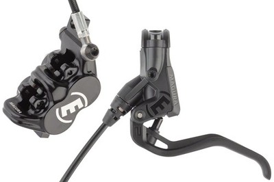

Just get some decent brakes. The easiest/cheapest way is go to eBay and buy a set of Magua MT thirty for around $75 each side (approx half off). 4 pots on each end with great lever feel and breaking power. I got the MT trail sports initially and then desired to have a 4 pot on the rear, so I got a set of these cheap and used the calipers. Then I needed another set for a back up bike, so I bought a couple more. Feel just as good as the MT7 on my brothers bike, but for a fraction of the cost.
