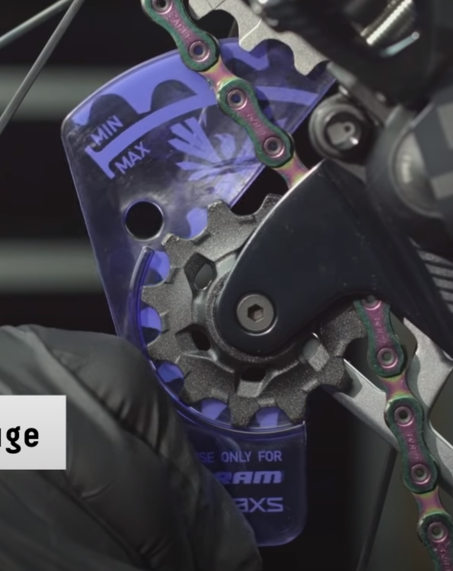

On the Axs, I had similar issue get the alignment tool for it.https://youtu.be/Tj-jDKuz5z0 make sure you have someone else help you you need to have someone adjust while you sit on the bike.

And if it isn't that, it will be a misaligned hanger. I use one of these to sort mine out - good luck

The old b tension gap doesn't work for the 52 t cog? I have that one...

Your AXS problem sounds like mine - before the correct b-tension was set.
Did you use the b-tension tool that came with AXS and follow the instructions?
In sag position, chain on the largest gear (this changed) and using the supplied tool.

I also have the 52 t cog, and my shifting has been flawless ever since using alignment tool. But he should eliminate all possibilities by check hanger alignment.
