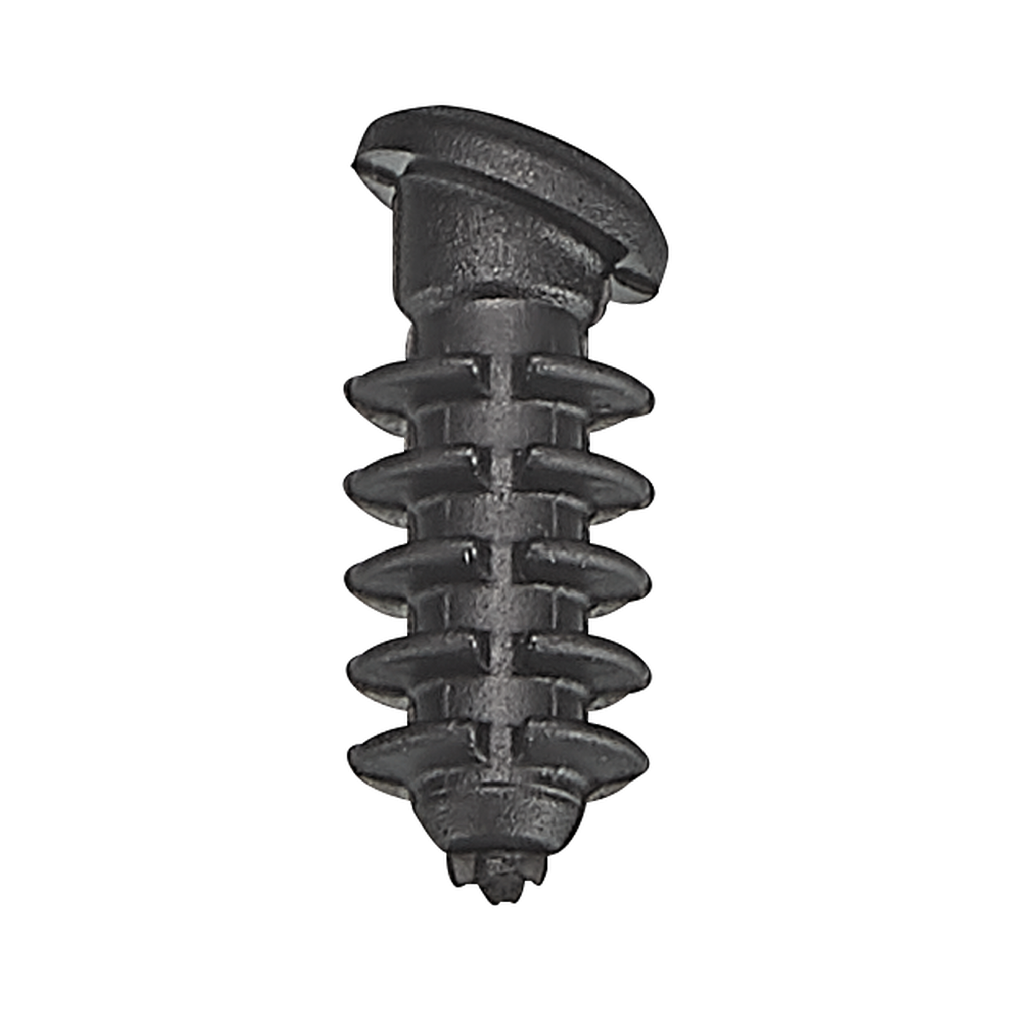

Have you plugged the holes - if so what's the best and easiest way to do it without getting the stock plugs?

Where the cable exits the top tube, near the headset, there will be one small hole. There may be a plug available but I just, carefully, filled the hole with clear bathroom silicone. Keeps any water/debris out …and it’s all I had at the time. 🤷‍♂️
I guess that’s a bodge fix…but I haven’t thought about it since.

This plug sold out for the last few years. Suppose it's a better and cheaper way to fix it but unsure how important it is.

We're talking about the round hole through which the housing goes? Get a tube of black silicone RTV gasket sealer. Get the quick drying if you can. Put a dab on your finger, and rub your finger over the hole. A little goes in the hole, your finger wipes it smooth, and it's not even noticeable when you're looking at it. If you change your mind in the future, you can poke out the silicone plug. Easy peasy.
