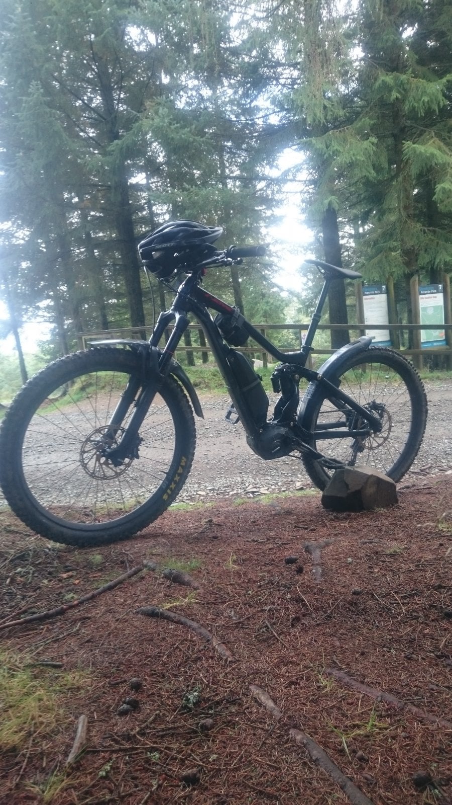

I fitted a Mudhugger FR to the rear of my new Whyte emtb. Fitted like a dream, no cutting or chopping required. I think others have successfully fitted these to the rear of their bikes with a bit of fettling, seems to be the go to mudguard to protect the motor from clagging up.

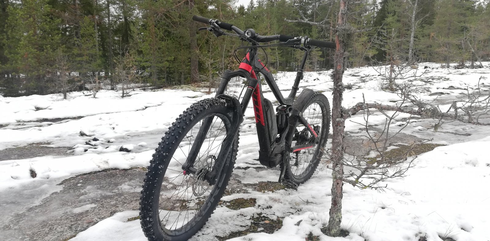

I have Rrp "Front" at rear.
Also use AssSaver on the seat when commuting.
And yes, it was too soon for studded tires

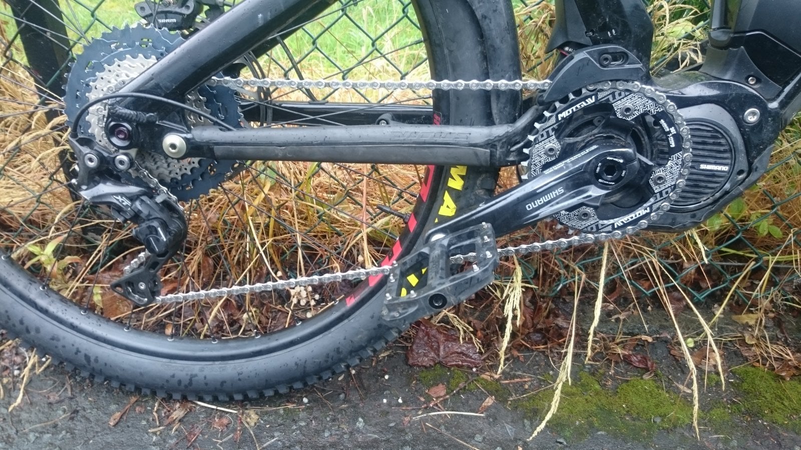

fitting a front RRP proguard max (long version) mudguard fitted where R120 has his rear guard does a far better job of protecting the chain chain guide, lower pivots, shock and motor as it extends right down to the chainstay yoke. As you can see in R120s pic his chainguide and chainstay yoke area (and presumably lower shock mount/pivot) are covered in slush fired in there by the guard. sort of the opposite of what you want a guard to do. Shit pics but hopefully you get the idea...
View attachment 21446 View attachment 21447 View attachment 21448
I didn't drop my motor to fit the motofoam on my current Esommet (I've fitted moto foam to quite a few Vitus' and did drop some). it's fitted under the wiring nest and I also have a plastic flap over the top of that stopping spray getting in. I fitted more to plug the gap to the top of the motor when you have the wiring connection bay open. and my motor bay cover is silicone sealed and taped (one piece of electrical tape.
Pretty sure if you search the forum you'd find pics I posted of all this somewhere.

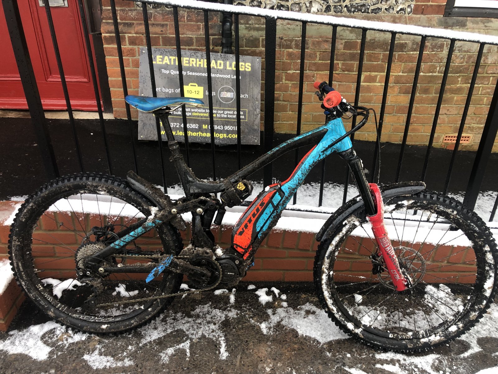

Which front guard is that ? Doesn't look like the crud catcher XL, similar maybe, but not the same. I still sometimes get a face full of crap with the front mudhugger, but it stops most of it.
I have the mud hugger front also on the rear of the kenevo to protect the linkages, it helps, but not as much as it should. I also tend to run a cube race guard off the bottom of the seat post, otherwise I get covered and a lot gets flung forwards.
Like this :
I don't particularly like running the cube rear as it flaps about and can bottom out. Tried it two days ago without to refresh my memory and within 200 meters my arse was dripping and 90% of the bike was caked in mud from forward throw - including my phone in it's mount (was running a test). The RR Proguard max (on the rear) appears to extend further round the wheel and has the extra lip, so this should in theory considerably reduce forward flick and linkage gunking. You can see from the picture that the mudhugger front on the rear won't stop much forward flick.
