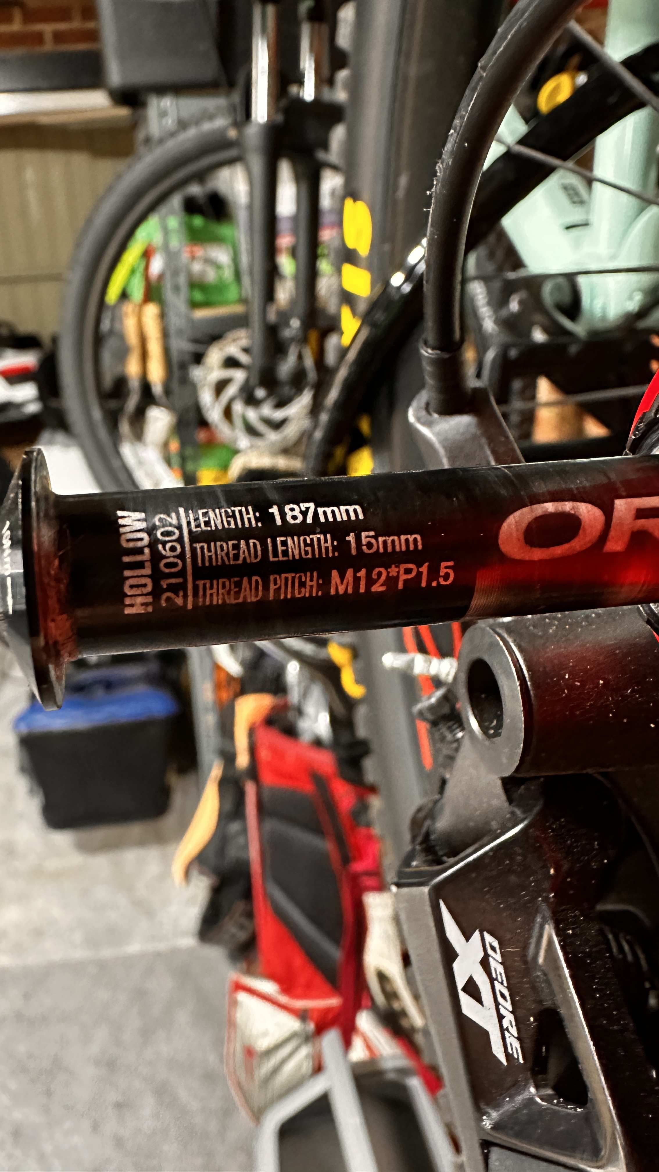

If I have the shimano mt410 hub which after searching has the microspline fixing, I also have the thru axle pictured and want to buy new wheels the
Nukeproof Horizon Pro Rear Wheel 148mm Boost 148mm x 12mm​
Will everything fit back together is my question?

If those wheels are the Microspline rear wheel then yes they will fit boost 12X148

Yes I would get the micro spline nukeproof wheels. Ok thanks buddy, I didn’t know if the thru axle would still fit in.
