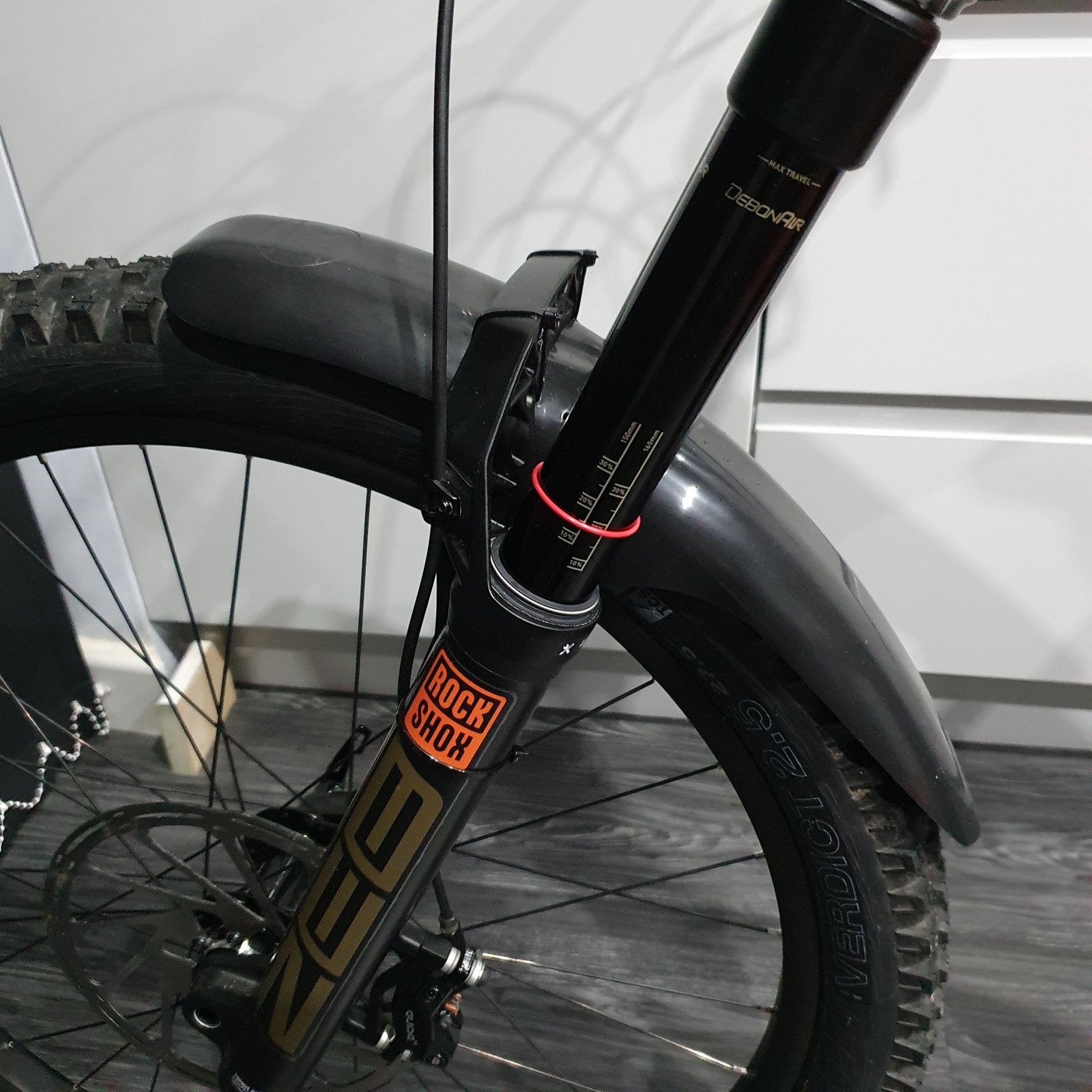

I added a mudhugger front like this
Gmt
Nov 21, 2020
13
Carnforth
The normal one, same on the front
Great thanks for that I will order one. Hopefully I can get rid of the mud which is hard to avoid at the moment. Are you enjoying your whyte having a great time on mine and realised what I have been missing on my analogue bike. They are heavy though. Best wishes for Christmas and New Year and hope we can get out of tier 3 so I can get back into Cumbria and Yorkshire dales.

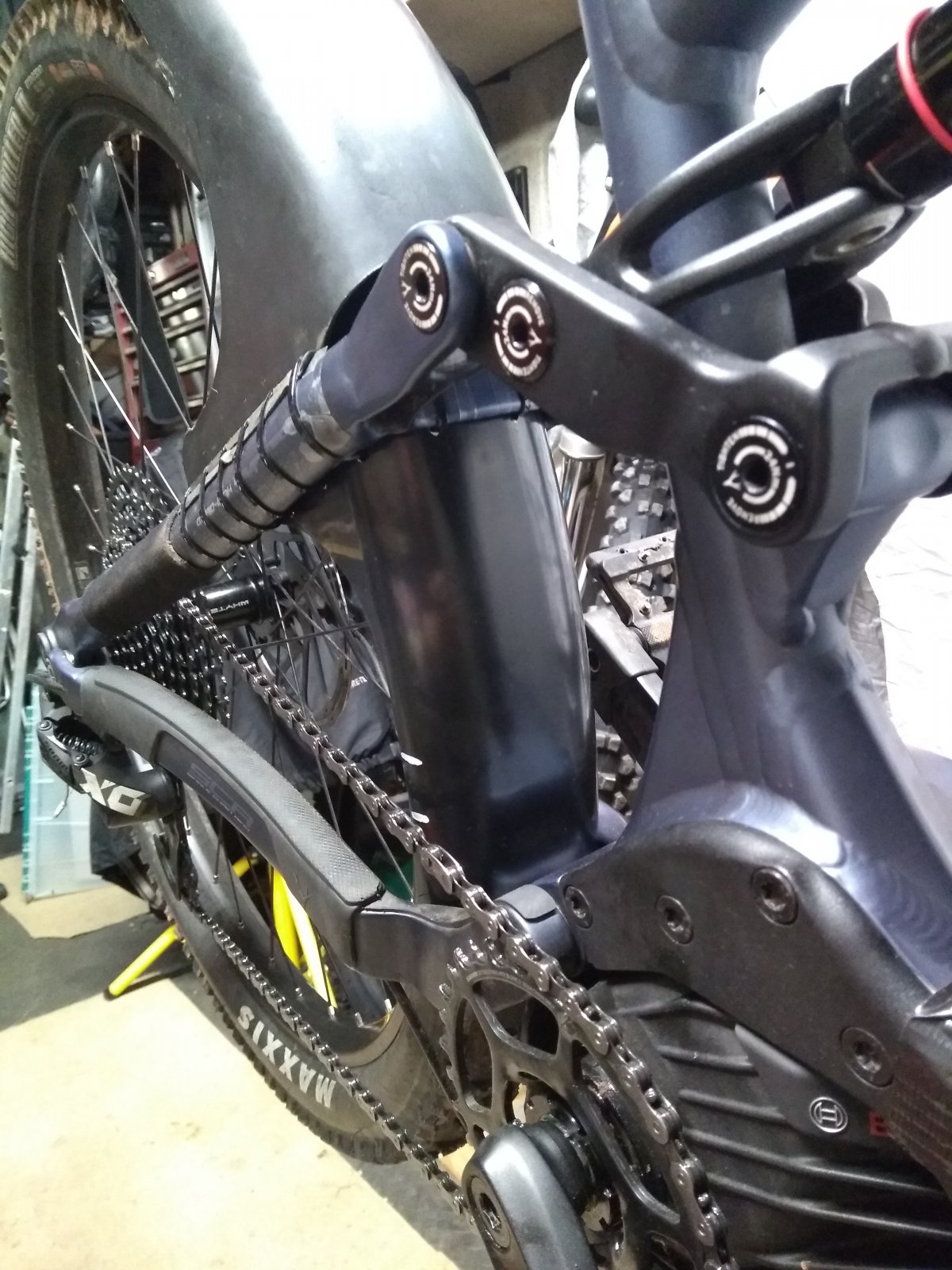

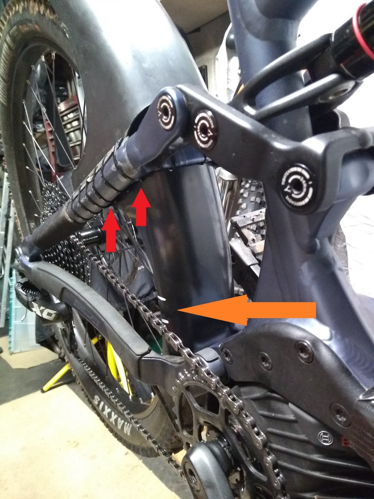

Yes I’ve coupled a couple of rear mudguards together. I used a MuckY Nutz front guard. Firstly I cut off the part of the guard that attaches to the fork leg along the contour line to give a neat overall shape. Also I faffed on a bit at the pivot bearing end so as to cut the sides off the bottom part of the mudguard so that it went below the pivot bearing that way no crud builds up around it. I drilled holes in the guard so as to fix it to the upper chain stay brace to hold it in place. The guard follows the wheel 150mm. This is going to stay on the bike.
the Mudhugger is flexible enough to fit over this and is secured in the normal way. Just take your time and remember......measure twice, cut once. Cheers ?

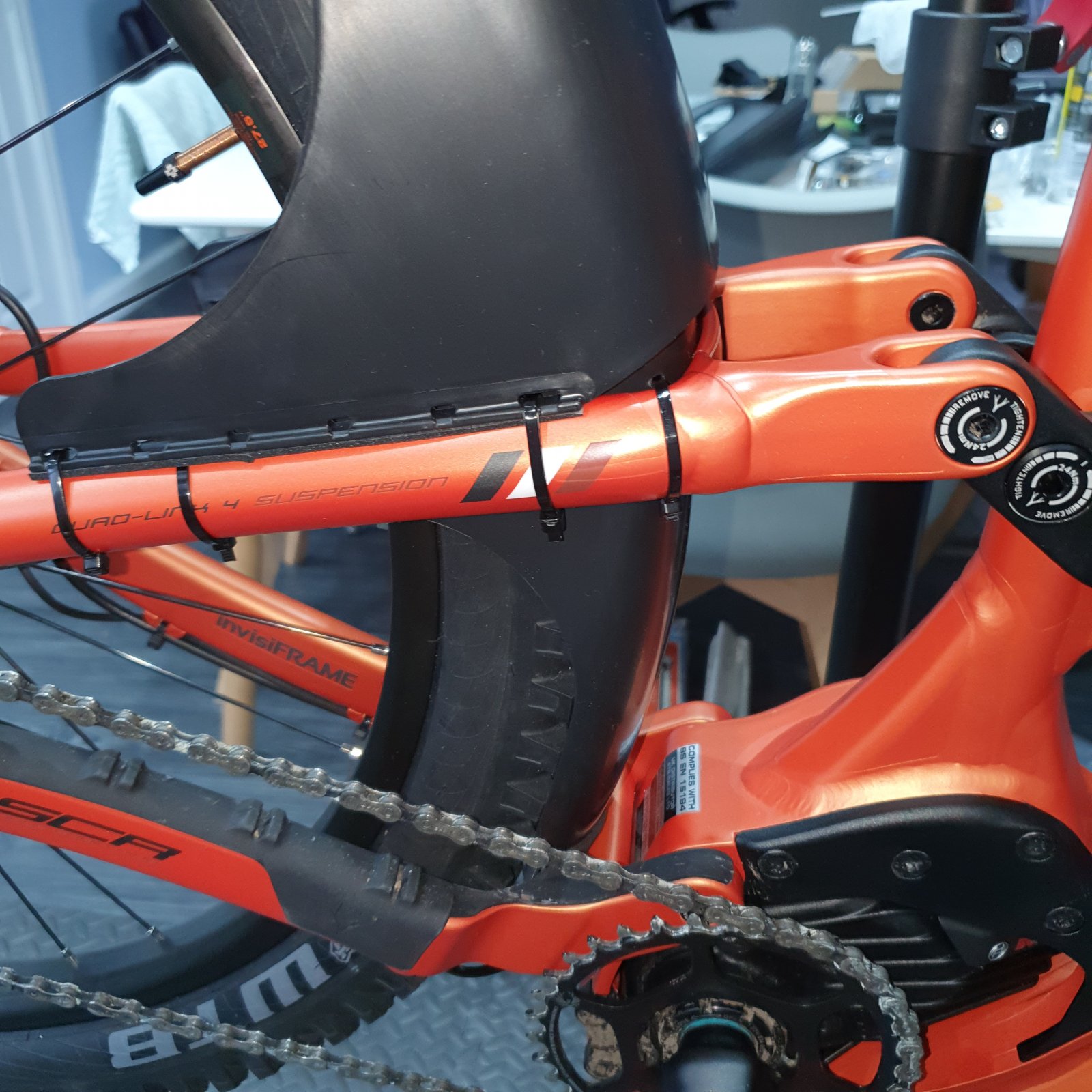

Same here, 2 at the rear, large MH and a FRX front under it. A couple of extra holes in the FRX to cable tie it to the cross brace, and it continues down to just below the swing arm. Otherwise no trimming or extra work required.
I've mounted the MH a bit high, so I had to place a piece of tape over the underside join of the two guards, but you can't see it.
It's about riding, not what it looks like. Keeps my back clean, and no kilo of mud on the pivot.

Actually I might have drilled some more holes in the FRx so that the rear MD cables ties went through both guards. It's been on for more than 12 months, I don't even take if off in the summer. The white marks on the FRX are where I thought I'd have to trim the guard for chain clearance, but it clears fine.

I've done the same as @Tribey and will be adding some extra zip ties that go through both the guards where they meet as the legs on the FRX do bulge out a bit towards the tyre.
As for the FRX being enough to keep your back and dropper post clean, it might keep the latter clean but not your back - you can always add the XL later.
Just in case it isn't clear don't put any zip ties around the bottom of the FRX and bottom axle bolt as that would restrict movement.

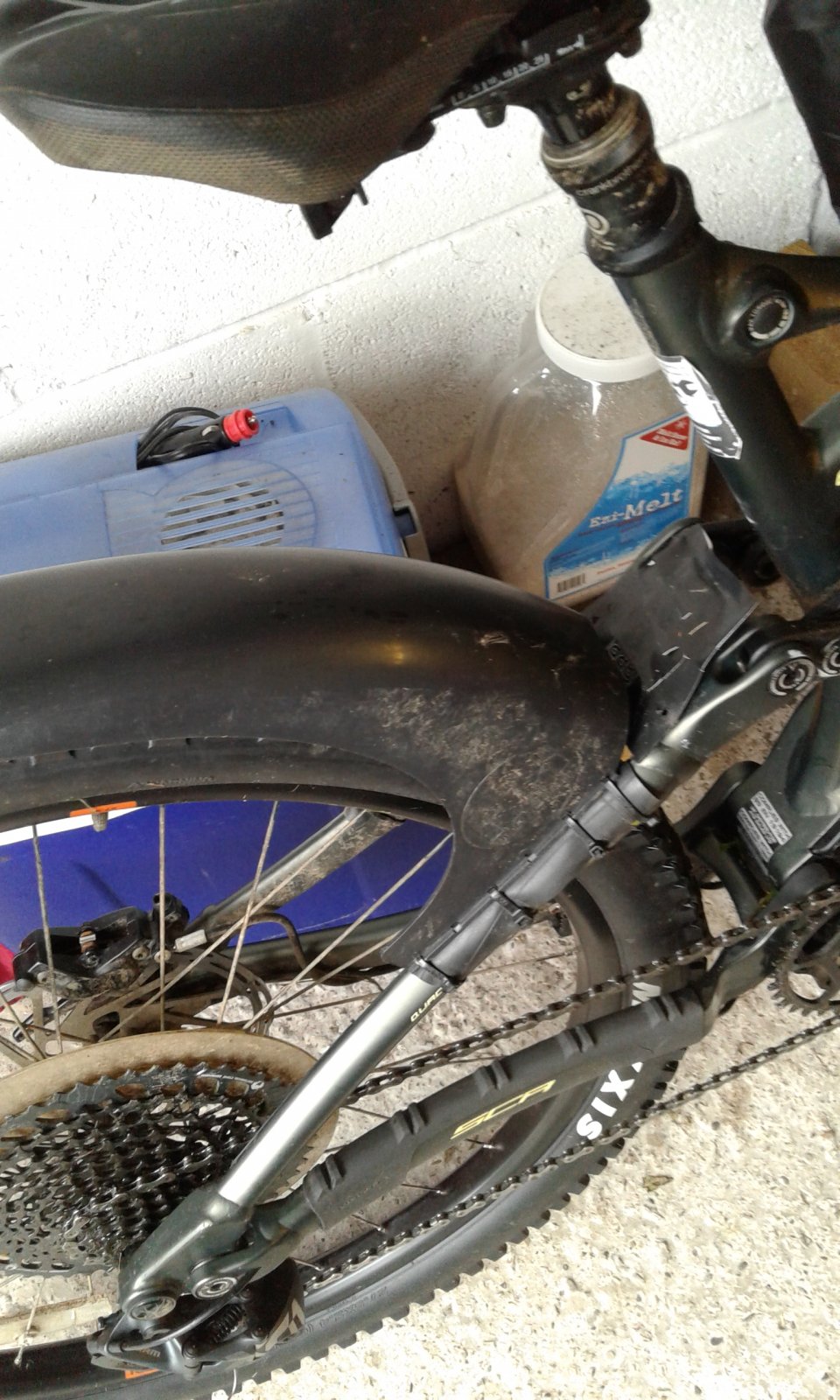

Following on from E160RS rear mudguard problems. After making the modifications as suggested I found I was still getting coated in mud so I have added a mudhugger extender which seems to have solved the problem.
