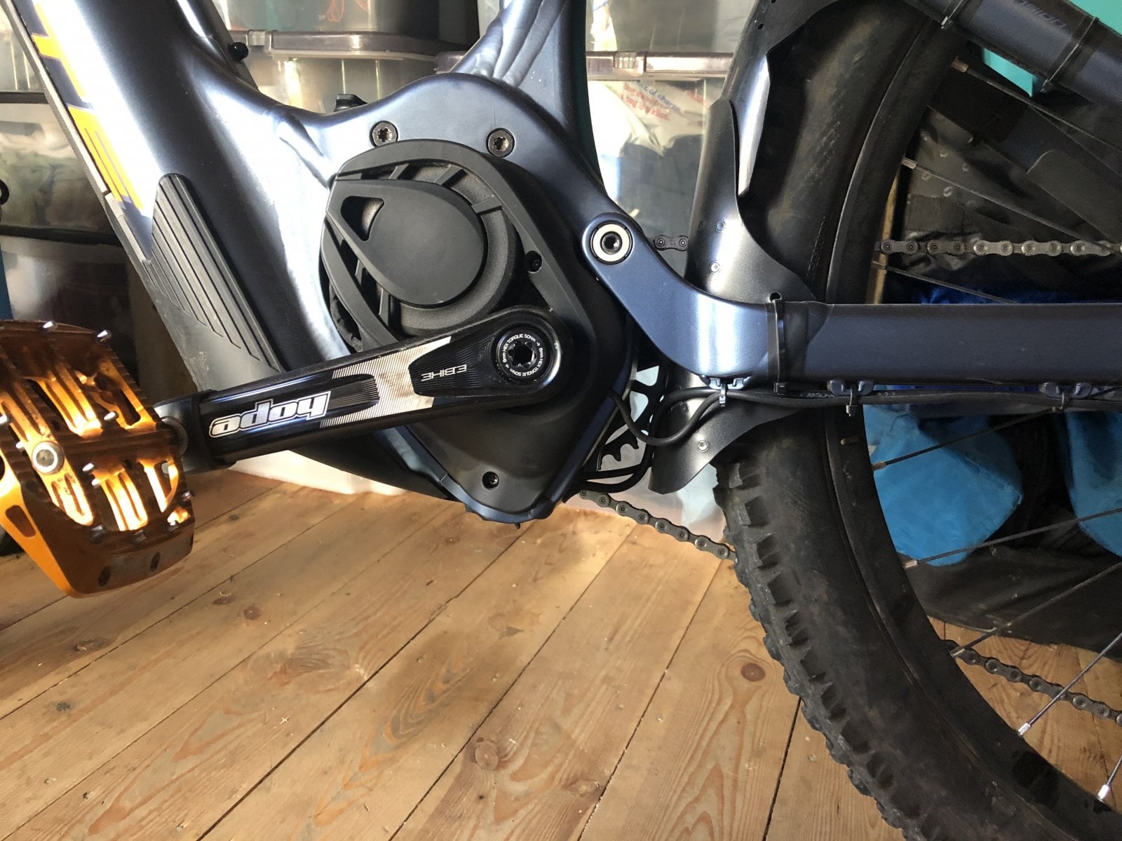

Here is an example of how the lbs have routed the cables. It requiers a small hole/dent on the left foot side of the motor. New 2021 models should have cable routing sorted. This is not my bike, I'm about to do my cable routing on upcoming weeks when I have a day off.

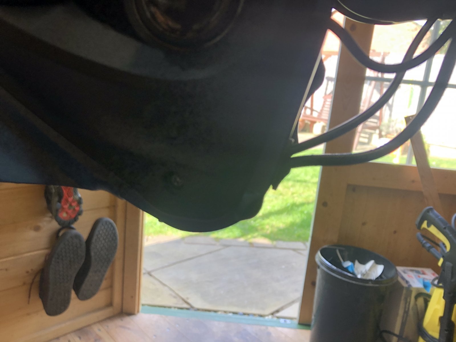

That looks really odd, my bike had the re-route but they put the brake hose through the rear hole and moved the sensor wire out of the side.
That still left the gear cable hanging so I have done an update myself and got both the brake hose and gear cable through the rear hole, leaving nothing hanging out the bottom.

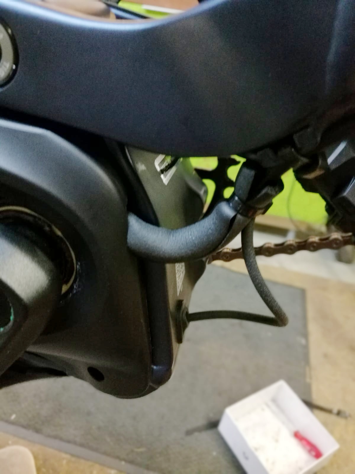

Great job! How easy job was it to route the gear cable? Do you have to take the motor out completely? I've just ordered the Rockguarz protector but feel your solution is much better. any problems so far?

Was probably the hardest part, I did remove the pivot bolt by the mech and then just fiddled a bit to get it out.
Ndp78
Apr 21, 2020
9
Bedfordshire
I did remove the motor fully, but others have managed it without removal, but a lot of fiddling, no way I could have with my fingers.
It’s all fairly straight forward to do, just take your time. Hardest bit was getting outer through the chainstay- took out the pivot to get a little more access.
Seen some pics of the Rockguardz cover, but offers no protection to the cable as it is cut out around it (bit of a shame really)
Only issue was cables do run close to the tyre so I add the guard to prevent possible snagging. Otherwise all good
