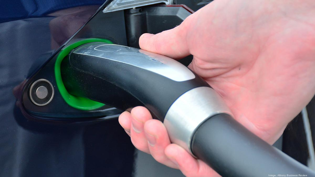

Isn't that why asking why a Tesla Supercharger plug looks like this:

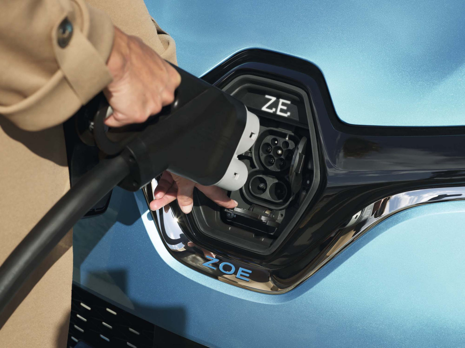

While all other car makers use a committee developed standard that looks like this:
Some companies don't care if the solution is elegant. Maybe that's why there are more Tesla Superchargers in the world than all the rest combined?

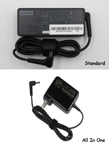

Rustyiron - I wouldn’t call an average laptop charger delicate
Lower voltages and lower power drawer with laptop chargers. Saying that, I would get 1 or 2 calls a week to see if we have a charger for some laptop or another in stock. The bigger ones always seem to outlast the small ones.
A good example is for a client I supplied 50 notebooks a couple years ago. They were for different retail markets and came with 3 different adapters. The traditional ones were a smallish one and a larger one. All of the larger ones are still going, several of the smaller ones have failed and most of the AiO type have failed.
Not really, the bigger plug allows flexibility for I/o connections where Tesla's one is proprietary. Tesla were ahead of the game and have invested heavily in their own super chargers. It's not apples for apples.
It's only "proprietary" in the sense that Tesla funded the development and engineering of it. They have offered it royalty free for over a decade to whoever wants to use it. I'm not sure the technical "ownership" is particularly relevant if anyone who wants can use it. It's a much more elegant standard than the committee developed CCS standard that was adopted later by legacy car manufacturers.
Tesla wisely combined the Level 1, level 2 conductors (home and destination charging) with the level 3 (DC fast charging) conductors for ease of use, elegance, and cost savings in the manufacture of both charging handles and vehicles. It's a superior standard but legacy auto thinks they can use a different standard (CCS) as a moat to try to isolate Tesla. Ironically, the Tesla standard is, by far, the most common EV charging standard because legacy auto has proven they don't want to make electric cars at high volumes or support EV's with charging infrastructure.

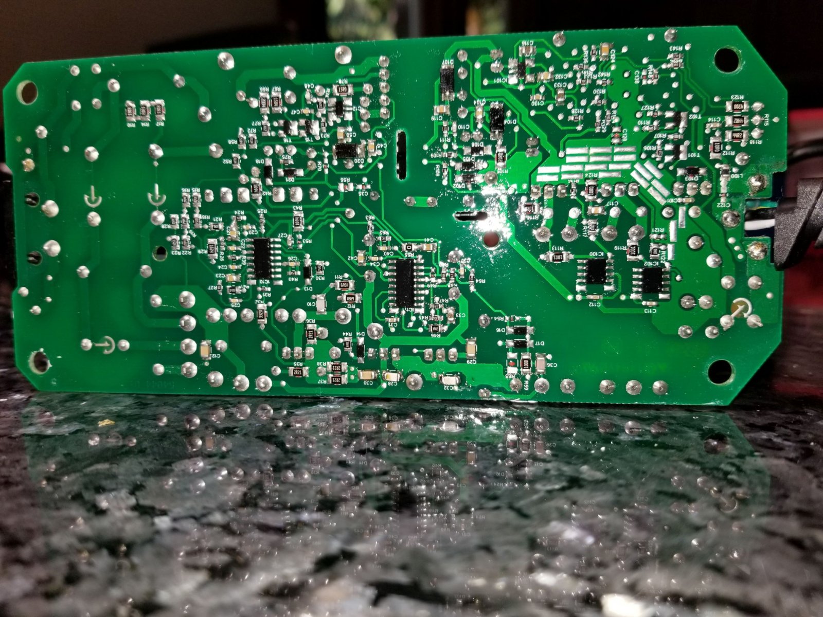

Is that the inside of a bosch charger?
Looks like a pretty run of the mill switching power supply.
I take it the switching chips are underneath?
Bosch's cost of building a switcher like this is peanuts, probably around a fiver or less each.
Oh, and yes, the larger the heatsink the better the reliability ... usually...
I'm surprised they didn't include a small fan, but , then again, that would have introduced a problem of crud blocking the fan vents and a point of failure.
I currently have the 2 amp version which gets pretty hot , but not hot enough to worry about.
Strapping an ali heatsink to the top is a nice simple way of increasing reliability.
Extending the internal heatsink outside the case is not such a good idea as it is probably at mains voltage!

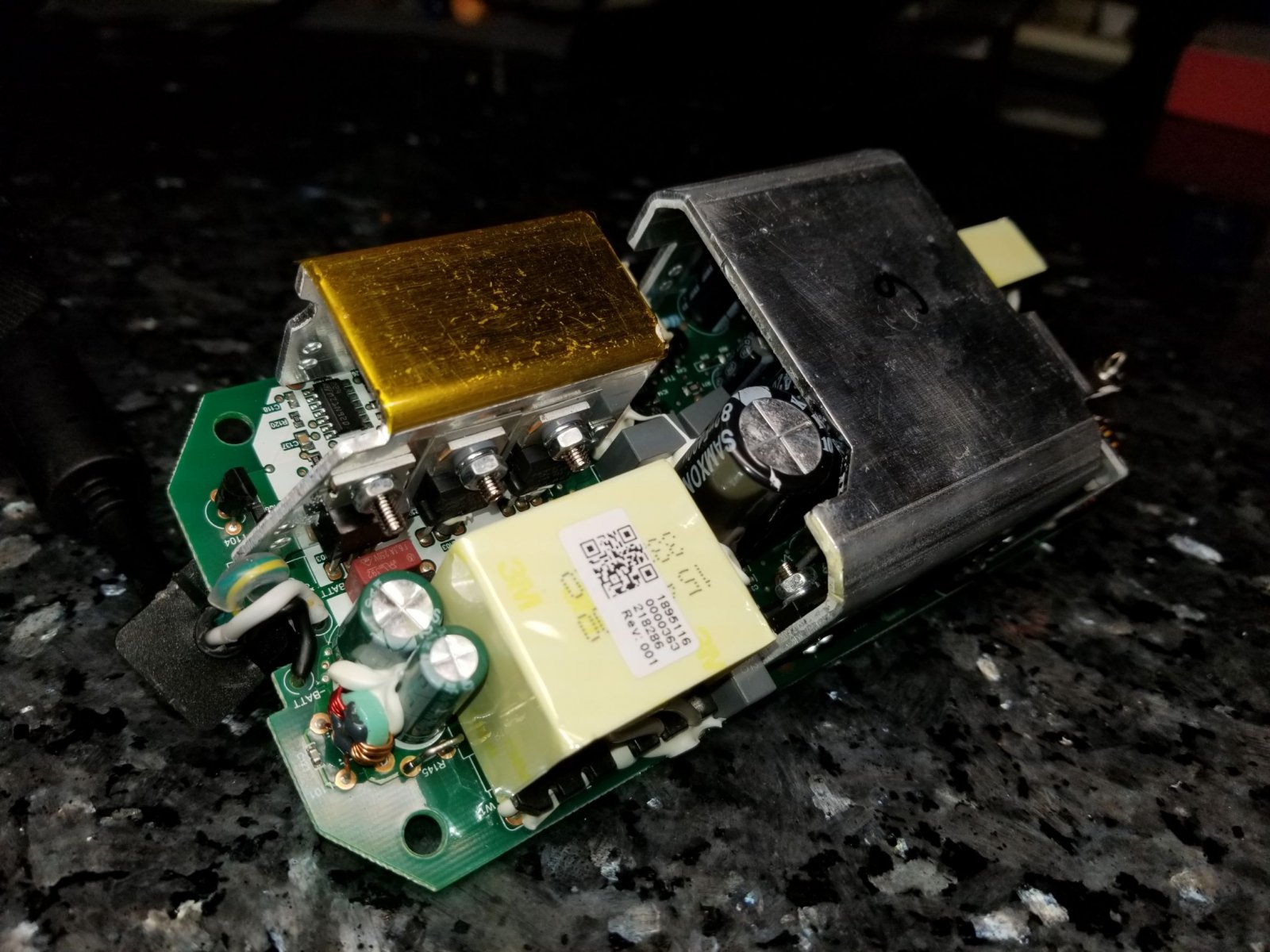

and of corse one of the hex bolts is a smaller size, and yes it still works ;)
I don't understand what you are saying here. I assume this might be an earlier generation Bosch charger but I have no way to know that. Or to tell its relative size. Or what the significance is of one hex bolt being a smaller size or what you are comparing it to.
Edit: I should have refreshed the page before I replied! So, the point is, it's been reliable?
It looks like they've done a substantial redesign between then and now. This is the charger that came with my Gen 4 system this year:
It's relatively dense inside the case with considerable heat sink material. I think they could make it 30% smaller and 30% more efficient with less heat to dissipate, by using higher quality components, for perhaps 50% more cost but do eBikers want to pay for that?

Both chargers look very well designed to me. They are both well packaged, the components are well supported and have proper heatsinking, with appropriate electrical separation & low ESR caps where needed. They're not mill spec by any means but appear to be decent commercial units, they will cost a fair bit more than a fiver to make as it's not the usual Chinese crap, but yeah bosch making a fortune out of them.
I'd imagine they've already worked hard on maximising efficiency given that they're passive cooled, as has already been said fans tend to cause trouble and of course you loose any semblance of IP rating. I think it's wise they're sealed units given they might be charging outside or jammed into a crud filled camelback.
It's very rare to find any modern electronics with heatsinks sat at line voltage, even in sealed units. The H&S police have generally put an end to all that and most of the time components are available (at the lower power end) that are fully encapsulated.
Yes you could shrink it down, probably to half the size or smaller, but the cost would absolutely rocket.

Saxon capacitors are a 2nd tier manufacturer at best.
Given the price of typical ebike chargers, I’d want to find Rubycon, United Chemi-Con, Nichicon, Elna or Samsungs, or good Panasonics being used.
Bet there has also been a cost down initiative and the most expensive active components are 2nd/3rd tier parts too. I notice the bridge rectifier is from TSMC so it’s not all bad.
Haven’t had to fix any bosch chargers yet. Many many are significantly worse then this. Love when the production manager okays the use of no name far eastern parts, like MOV’s that trip at 270vac, ignorant of IEC standards for mains voltage tolerances.
