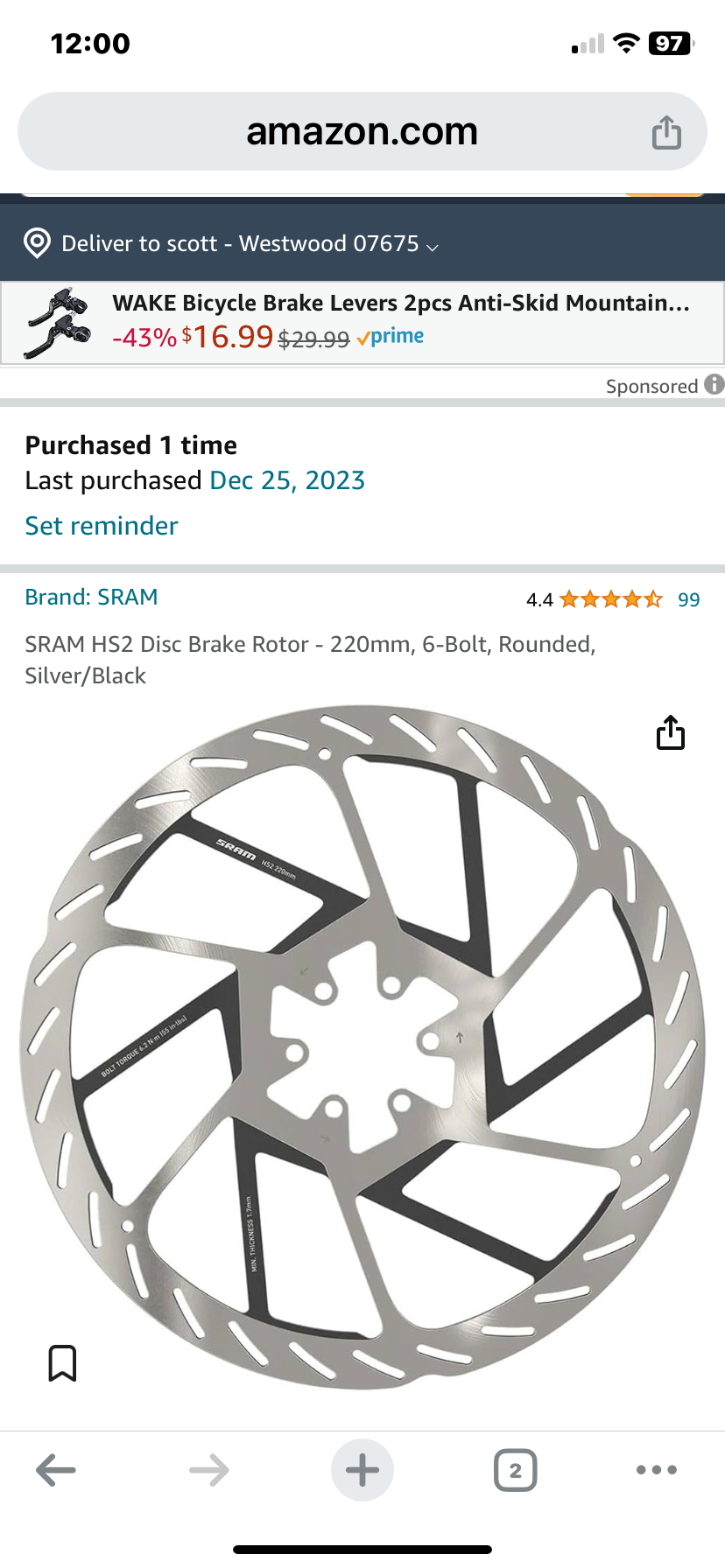

I highly recommend the thicker 220mm rotors for anyone that likes to stop when they hit the brakes. 2 down sides, they weigh more and being larger they are closer to rocks and stuff on the trail. Once they are bedded in they are the best brake upgrade you can do.
