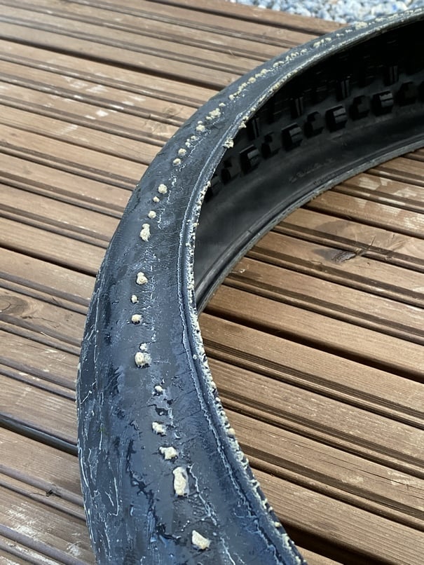

Following this with interest as my bottle of Caffelatex is just about empty. My LBS use Stans and when they rebuilt my wheel they used it when they refitted the tyre and it seemed to work fine. I say "seemed" because the tyre didn't lose significant pressure between rides and I never noticed a puncture if I got one. However, all was left in the tyre when I changed it was a ball of latex snot.

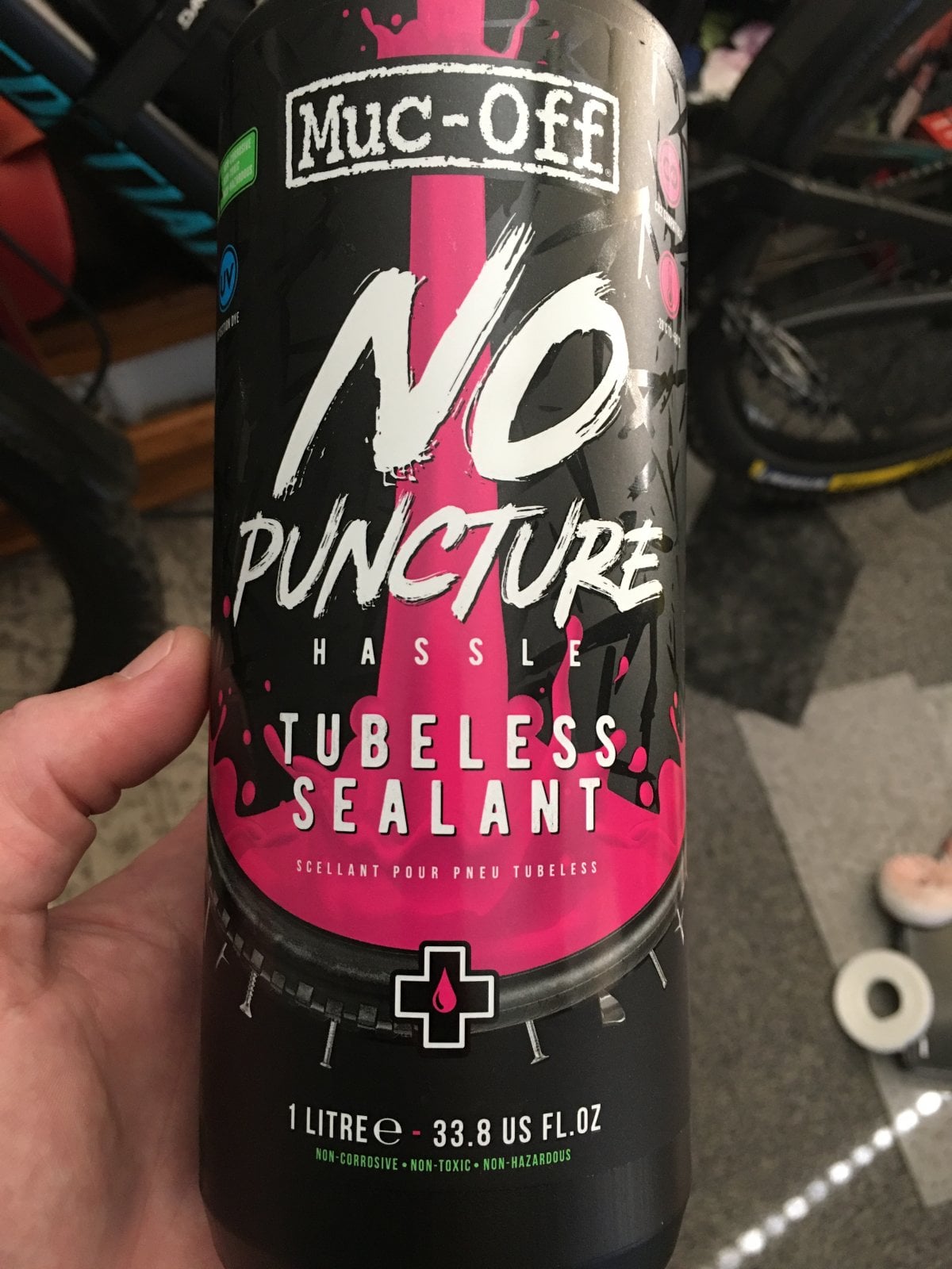

Stans. Used a load, keep coming back to Stans regular sealant. Muc Off was one of the worst IMO failed to seal on many occasions!! It looks and smells nice though..

strange that so many different experiences with the same sealant. I used stans for years but it just went solid in the tyre in no time at all, changed to muc off and its saved my bacon a few times without having to get a bacon strip in there to get me home.
it lasts well but the downside is its like this flourescent 'get everywhere' gloop that stains everything it touches unless you get it off straight away.

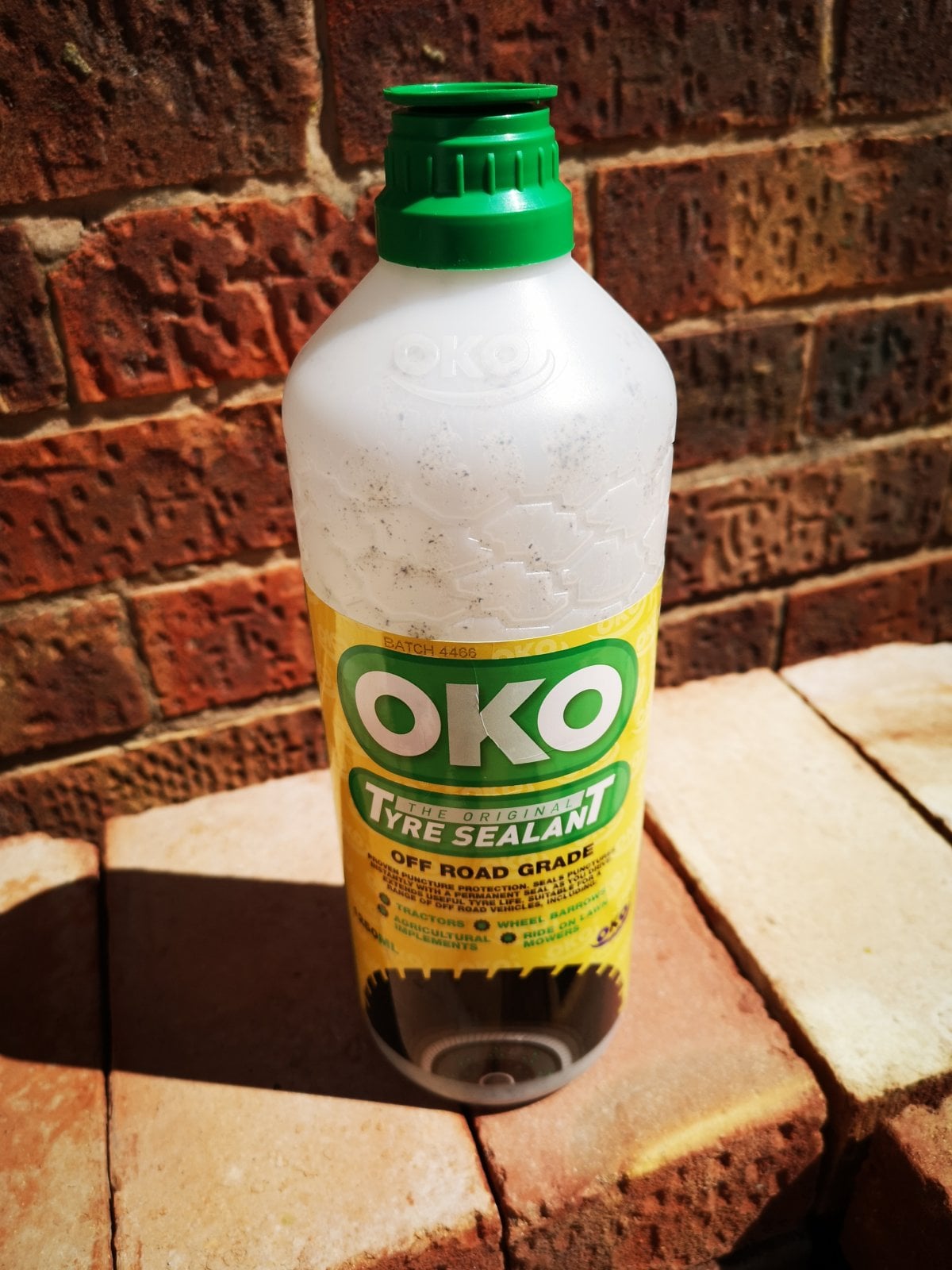

Get down to your local agricentre and get some OKO tyre sealant, (not the cycle stuff). It won't go through the valve but it'll seal any hole and wont go off in the tyre at all. Plus its loads cheaper, been using it for last 20 years.

Only used muc off so far.
Is it good? Idk.
Mainly chose it because of its compatibility with co2 and its ability to seal langer holes
Most of the punctures I had where to big to fix, although muc off says I should've been sealed but I still had to plug it.
In the hole it seemed that the muc off wouldn't dry and kept coming out.
The stans dart does it also react with muc off?

The first being Stans (regular) which does a great job of sealing the tyres and for a while stays liquid. After some time though, the particles in the sealant clump together and form a 'stanimal' which gets bigger and bigger until you remove it and start again.
The largest was in a fatbike tyre and was almost as big as my fist! you could hear it bumping around inside the tyre .

I find oko a bit thick so add 50% water to it.
Its £10 from my local Mole farm shop for the 1250ml bottle.

OKO Magic Milk did the job. Stans left strange balls to the tire. I'm running cushcore.
Will go back to OKO when the Stans bottle is empty.
