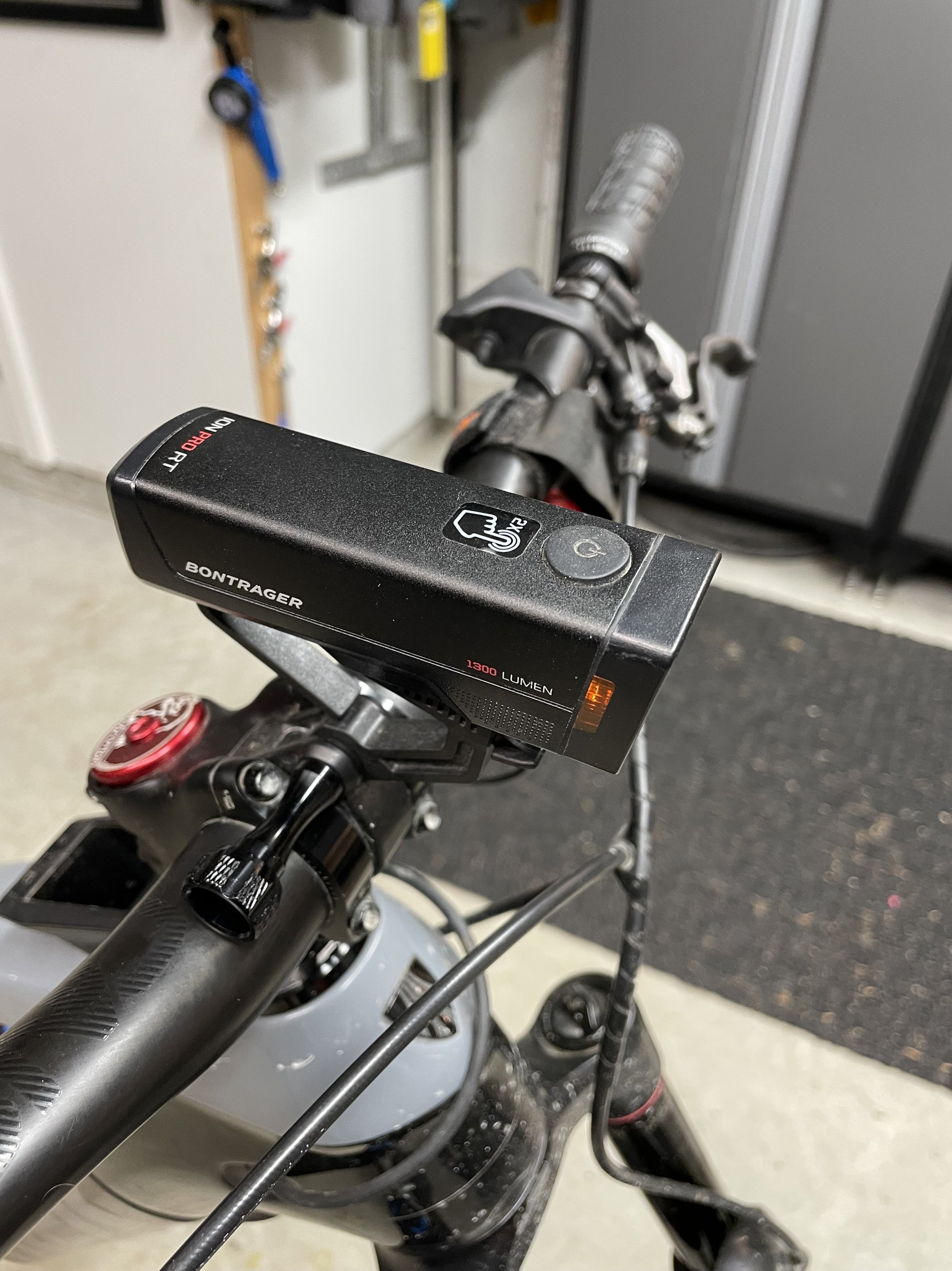

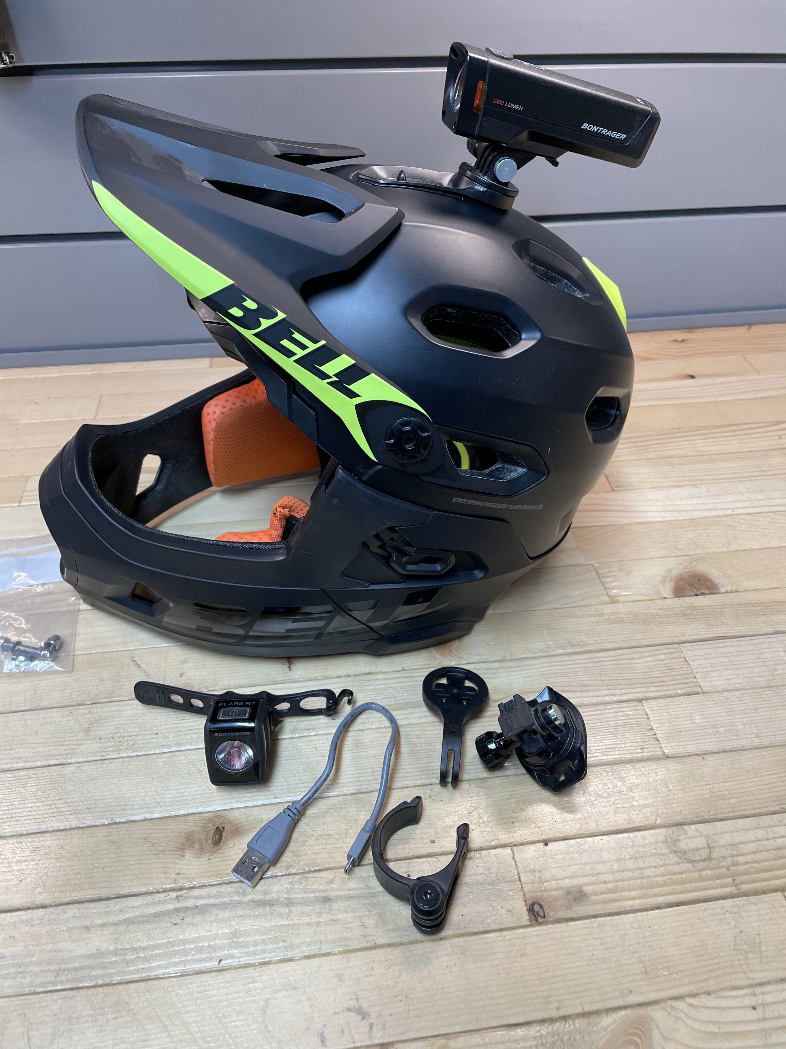

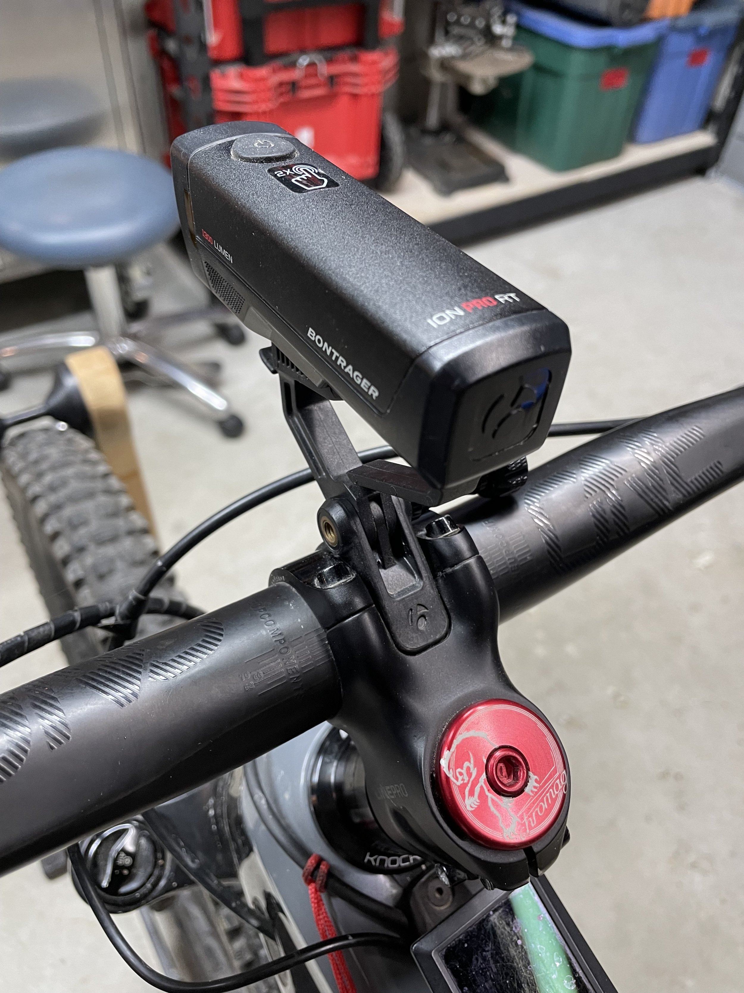

To your question and input by Stihldog: What light?
I use the Bontrager lighting system. GoPro cameras are also easily attached to the stem or helmet as well. The original stem on my Rail was 60mm and I wanted a shorter stem (45mm) that would accept a carbon bar. The shorter Bontrager stem allowed the lighting/camera to mount easily using a bar-clip. I can’t remember the name of the mounting system on the stem but I leave it in place all the time.
There’s multiple mounting options, and attaching or removing is fairly easy. The main lights have two intensities and a strobe. Same with the tail light.
They seem to be waterproof/resistant and charge up using a mini-usb connection. When I use them at night on the trails they seem to illuminate fairly well. Having lights on the stem and helmet works good for me. I don’t know the charge time or use time but I’ve never had an issue with three hours of riding.
