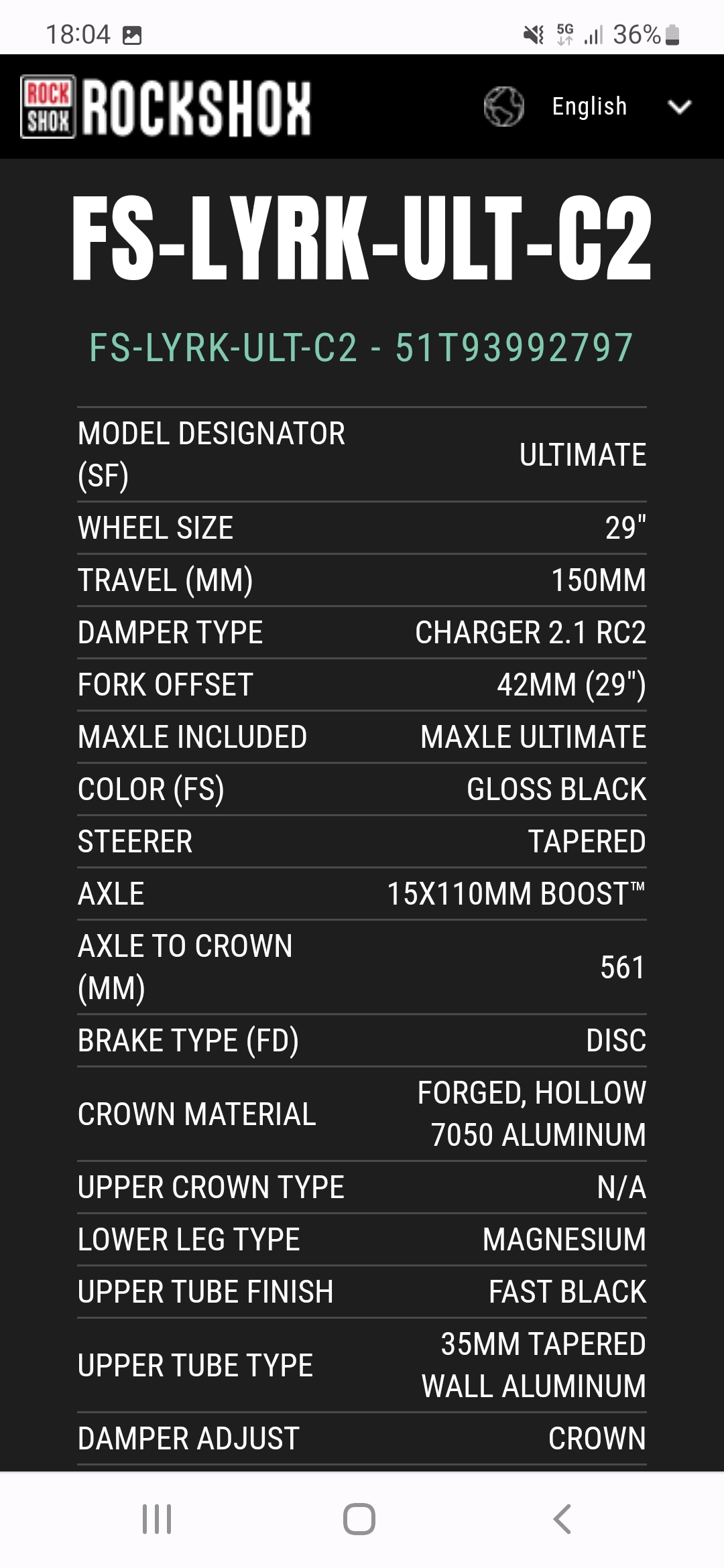

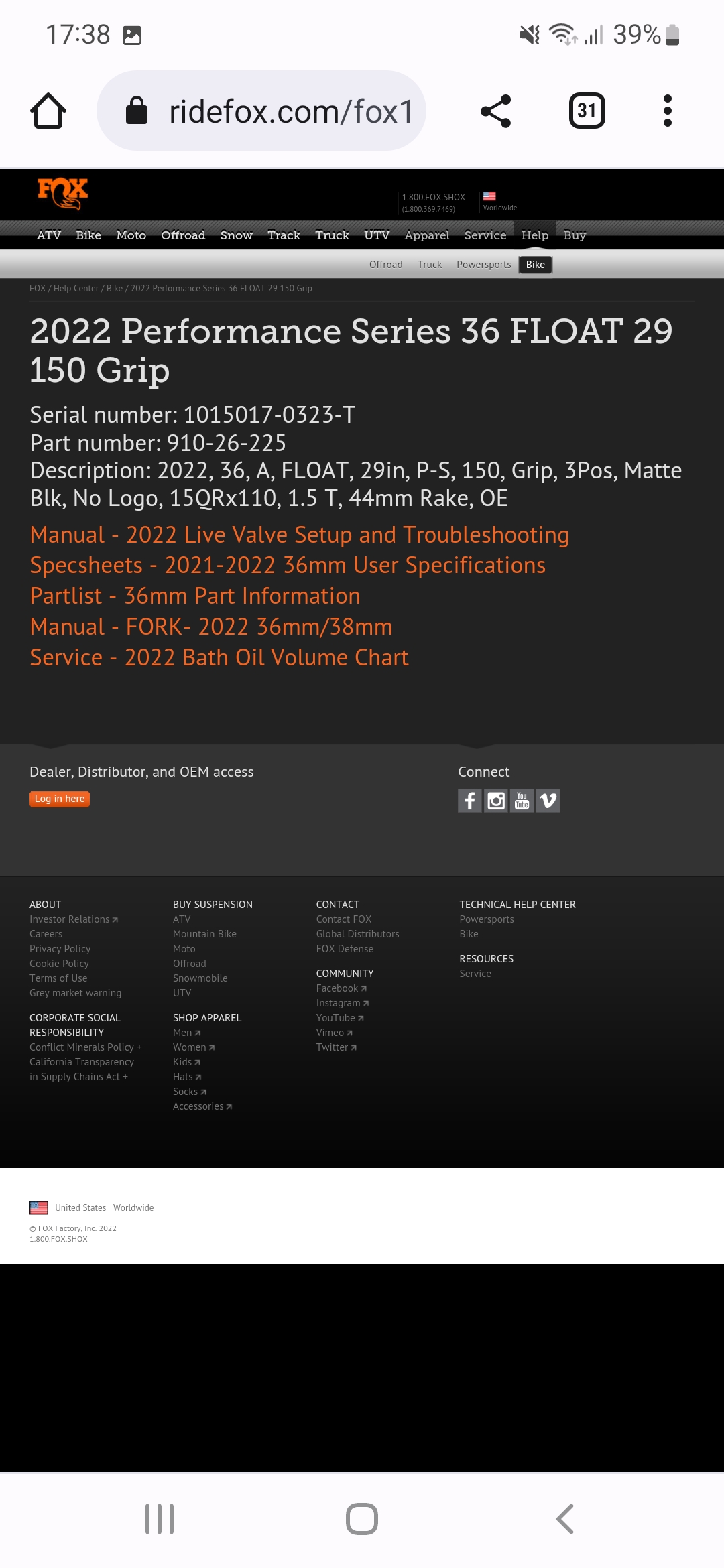

Currently I have Lyrik Ultimates which are also 150mm which I didn't I didn't realise, I always thought they were 160! Now. The Lyriks are 42 trail, the Orbea Fox 44mm. Which is ...better trailwise?

View attachment 99921 View attachment 99922

As you've noticed, Orbea uses Fox and Marzocchi forks with have 44mm fork offsets. The Rockshox Lyric has a 42mm offset. Theoretically, the Fox with it's 44mm offset means "Trail" has been increased and therefore it should offer a slightly more nimble steering feel. The Rochshox with it's 42mm offset increases "Trail" and therefore it offers a more stable steering feel.
