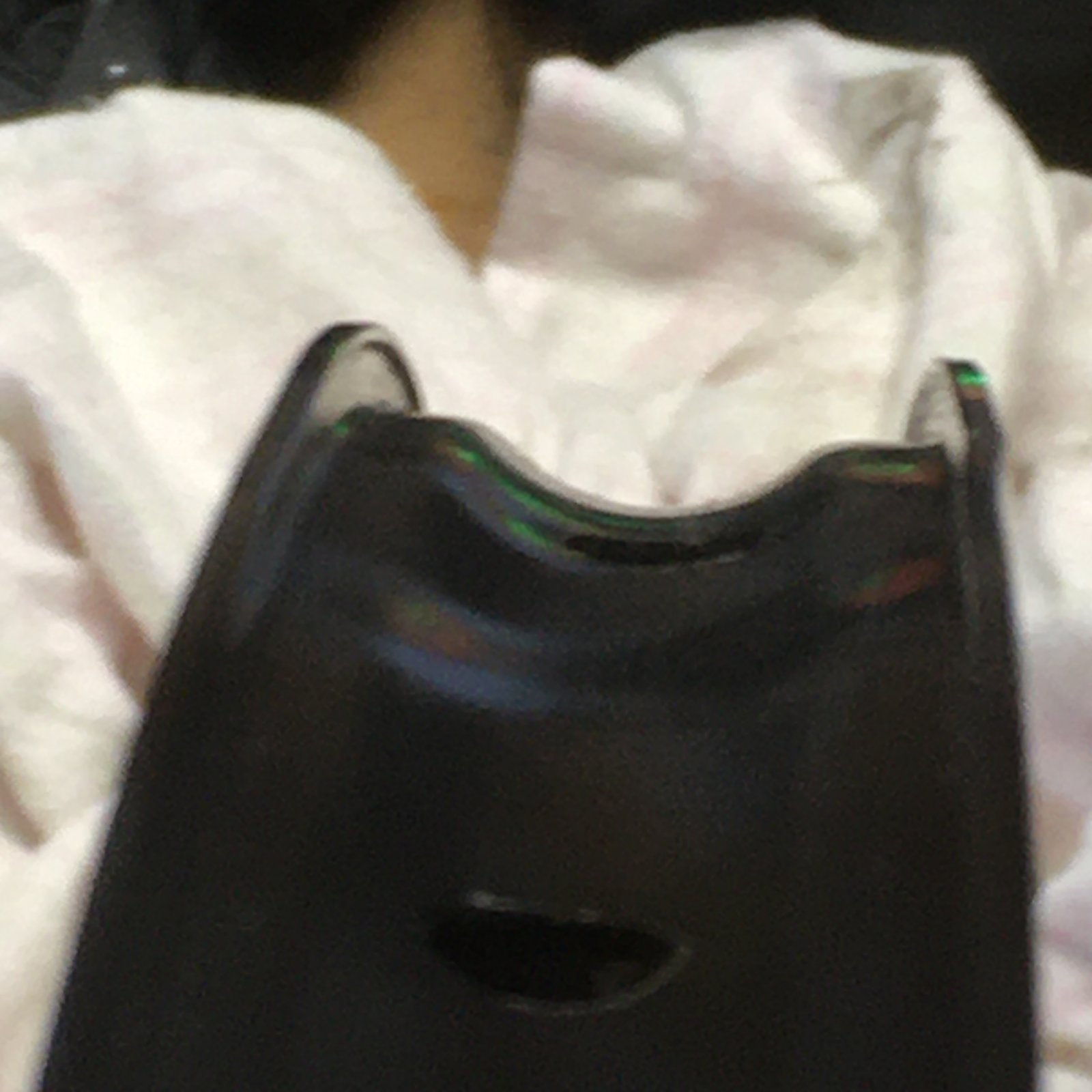

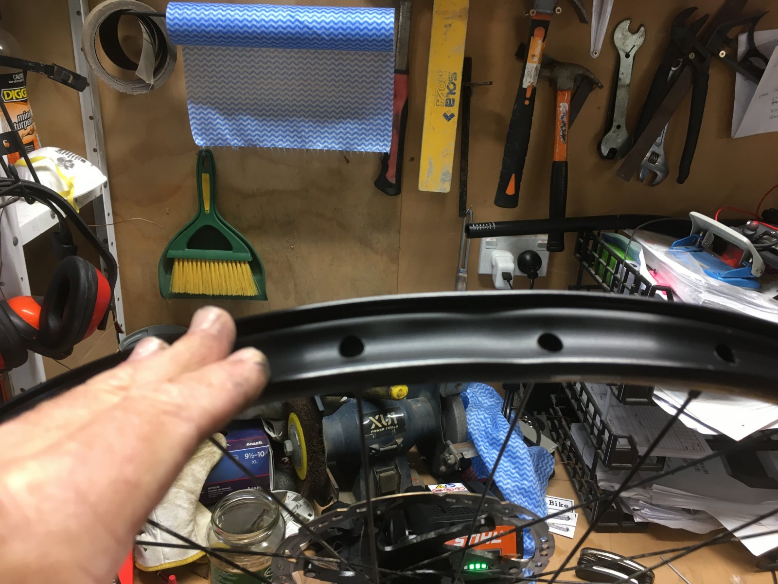

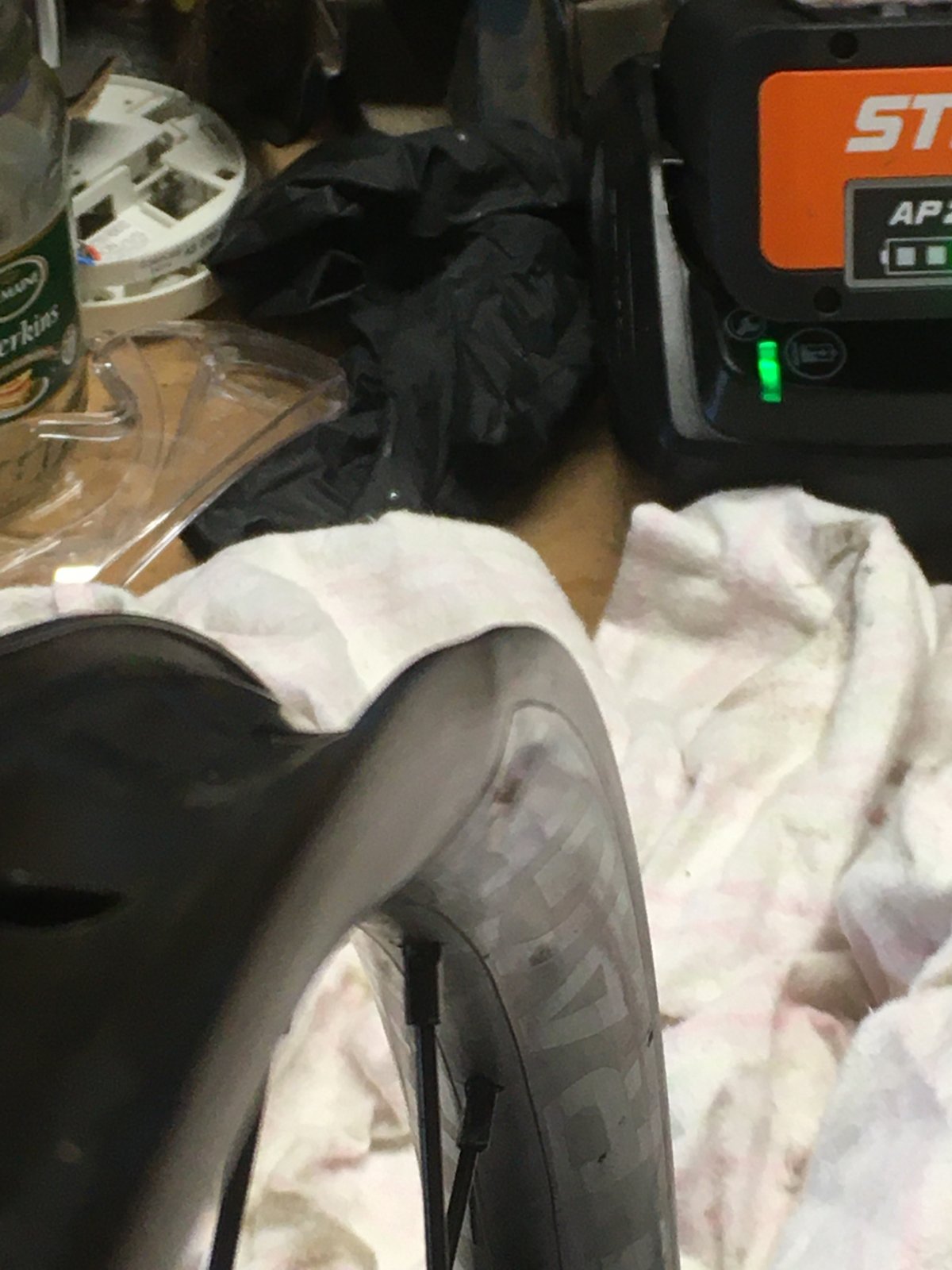

Noticed this damage to my rear rim while getting ready to install cushcores.
I have been riding on it with no noticeable effect.
I am now wondering if I can use it as justification to mullet my bike.
The only reason I really want to mullet it is to stop it ripping off the klingons during steep descents.
Not sure what to do - whether to just install the cushcores & run with it or change the rear wheel. Any advice or suggestions?

Since you've only just noticed it, it must still be rolling OK! You could install the cushcore and keep going, you might get away with it for quite a long time. Or it might fail you in the middle of a ride, miles from the car. Unfortunately, those wheels have a reputation for being made of cheese. It depends how hard you like to shred! If it was me, and I had the money for a new wheel, I would look at replacing it. If you do, I'd be keen to hear how you like running a mullet setup! Is your klingon reference to do with the sound of the freehub?

I found similar dents in my rim last week mid ride. Rode a bit more cautiously on the downs thereafter. When I got home I had a proper look at it, deflated the tyre, got some vice grips and a flat edge for the outer rim to brace it and bent the rim back into shape. Rode it again mid week and it’s fine. I would bend it back into shape and ride it until it fails.. but that’s just me.

Good replies. The shop was out of cushcores so I ended up getting rid of the rim insert & tapeing the rim instead. The original plastic (rubber really) insert wasn't as thick as I expected but having the tape is more reassuring in case I burp the tyre I can now fit a tube in to get me home. For those that remember I had a real hard time trying to get the DHF onto the rim when new - well after a few months riding it just about fell off the rim & fell back on easily again. I guess they do need a bit of stretching when new.
SO the tyre held air well enough on my ride so am still unsure what to do.
I tried the 27'5 from my giant on & rode around the block. It felt a somewhat more natural position than with the 29 but maybe that was due to me being 20mm closer to the ground.
There is 40mms more between my arse & the tyre which is the good thing as it would stop the tread scuffing my shorts (& detaching the klingons Phil)
I can see the downside with pedal strikes which at times are plenty enough over our rooty trails but I was wondering more the rear wheel would get hung up on stuff more with the less rollover effect from the smaller wheel
