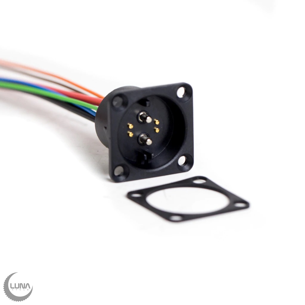

My connector on my 2018 battery is worn down after 8,000 km
The male part i to short and therefore sometimes disconnects during rides
(The 1.3 motor is running perfect and smooth)
I can only find one source for buying the part fitted to the battery - Luna Cycle - But they have no stock
Do any of You know of any retailer ?

1: Losen the 4 screws holding the plug
2: Take out old plug
3: Cut the wiring - not to short
4: Solder the wiring back on new plug
5: Isolate wiring and remount plug
6: Go shredding 🤘

Can you advise if there is a workable length of wire on the plug and plenty of space inside to tuck the soldered wires
Also, is the wires the same colour
Frank_Denmark
Dec 17, 2018
312
531
Denmark
Many thanks
I did this a year ago on both my batteries - and as i remember it the colors are the same. Look below from Spec manual.
There is room enough inside. But you have to cut wires close to the plug...

thanks for the link! , my '19 turbo levo started turning itself off during rides, and sometimes won't turn on after a lot of messing around with the connector. yesterday I took a close look to the battery connector and the main pins were like corroded, but from what you get when electrical arcing.
