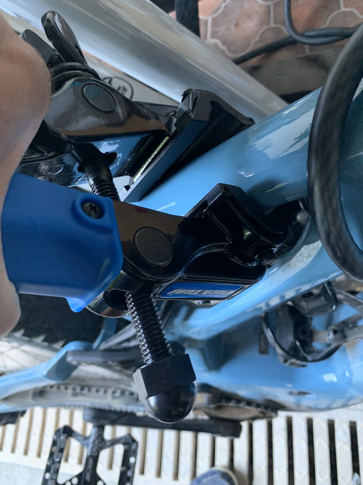

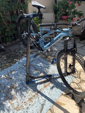

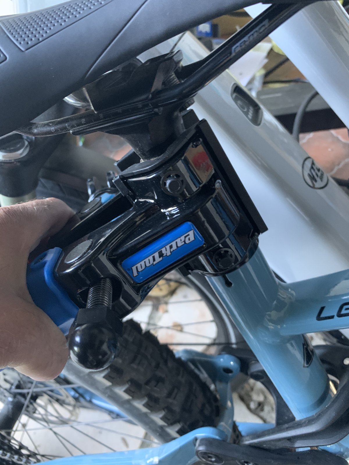

Hi
Another dumb question, where do you do attach your TL to your bike stand.
I have a Park Tool PRS 25 and obviously would like to attach at the best and safest point but where is it?
The dropper post -- makes no sense to me as suspending 22kg from a movable item seems potentially a big problem.
The seat post immediately below the dropper -- but the clamp is bigger so insecure?
Various locations on the top tube -- but none are perfect due to the taper and elliptical shape
May I ask what others do / recommend? Have I missed something .. again?

Fully extend the dropper post and clamp it for the dropper stanchion, just make sure the dropper stanchion and stand clamp are perfectly clean to not cause scratches on the stanchion ...

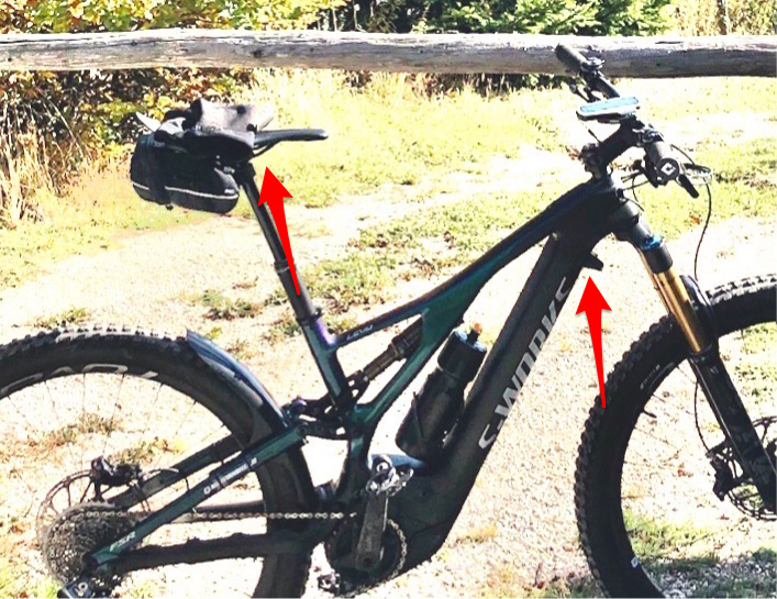

I have no good feeling to clamp the Levo at the dropperpost.
I do not clamp my Levo at all. If I work on the front wheel, I hang it on the downtube, if I work on the rear wheel and the drive, I hang it in the sattle.

I broke the seat clamp because i rotated stand upwards so beware they are heavy bikes and you are putting pressure on the clamp if using on seatpost.

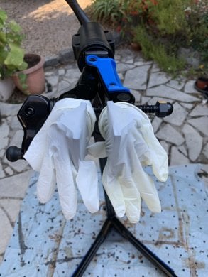

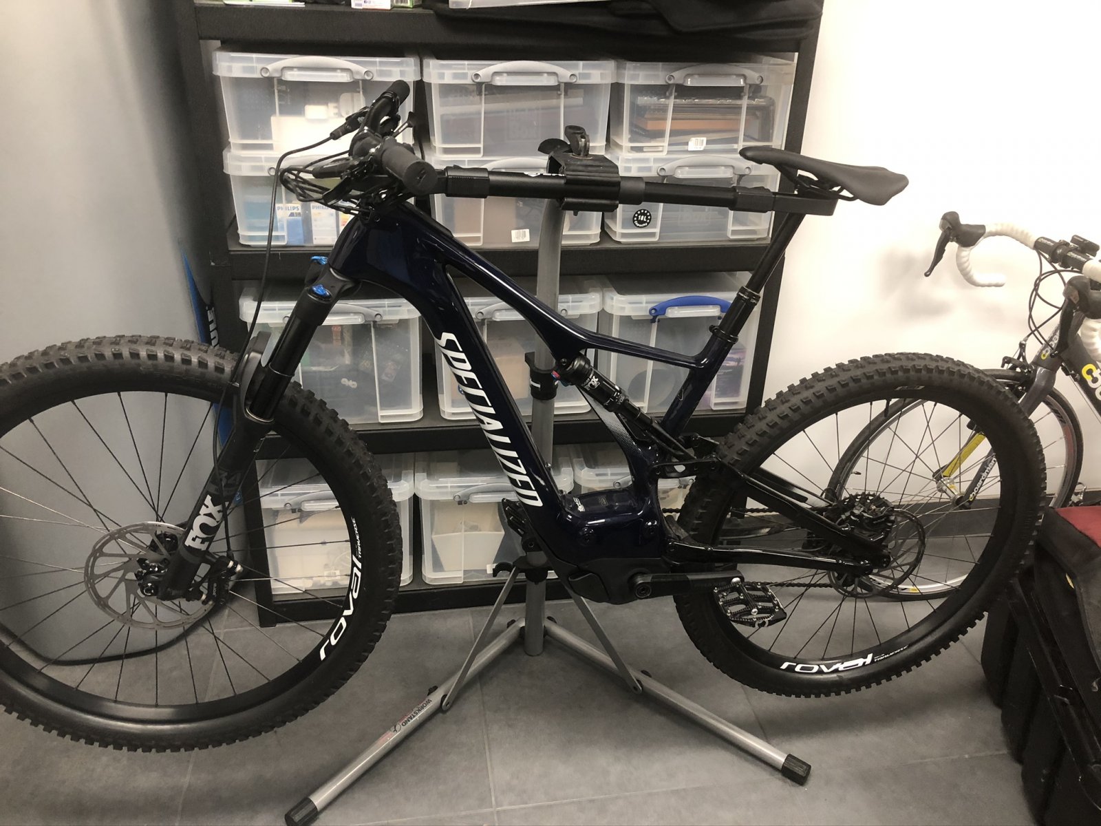

Thank You everyone for responding. There is obviously more than one way to crack this egg.
After reading everything and following the links, I decided to go with the extended dropper post as that looked the most popular / commended although it gives me the screaming fits looking at it. I did try the 10-finger condoms ( Park Tool commendation) to protect the dropper stanchion but frankly that made it more awkward as I had no idea where the actual jaws were and I started clamping in totally the wrong place.
Very grateful , more expensive errors avoided

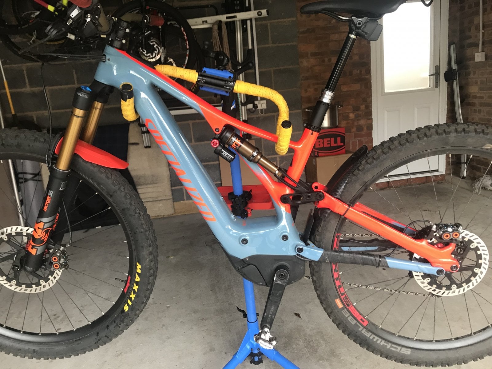

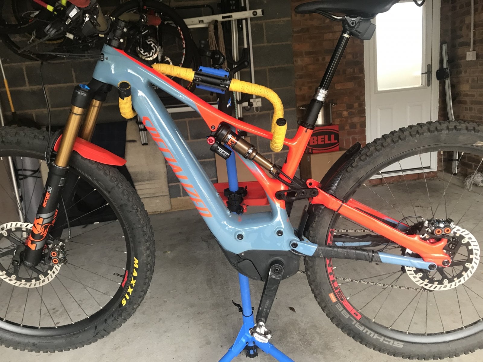

Funkeydunk
May 28, 2019
389
297
Uk
Awesome Idea ... I really like that ... going to see if I can find a cheap set somewhere ...
On a different note those mismatch tires are playing absolute havoc with my OCD
My ocd was off the chart, but the eddy current is outstanding, so the maxis has to go. The handle bars cost £7 from CRC
