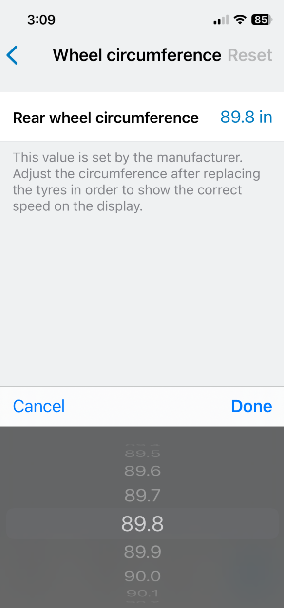

The phone app lets you adjust the circumference +/-5% so you can simply average the max/min allowable values to determine the factory programmed circumference.
I ask because my 27.5" came factory programmed as 29" (2280mm/89.8" circumference) and Bosch doesn't know if/how to fix it. I'm wondering if they even support 27.5" wheels anymore or if they just figure that 29" -5% is close enough. Anyone else have a Smart System they can check?
Technically, 29"-5% is pretty close to 27.5" but only if the tire is new and firmly inflated. At my preferred tire pressure the circumference is 2125mm/83.7" which is 7% below the factory setting.

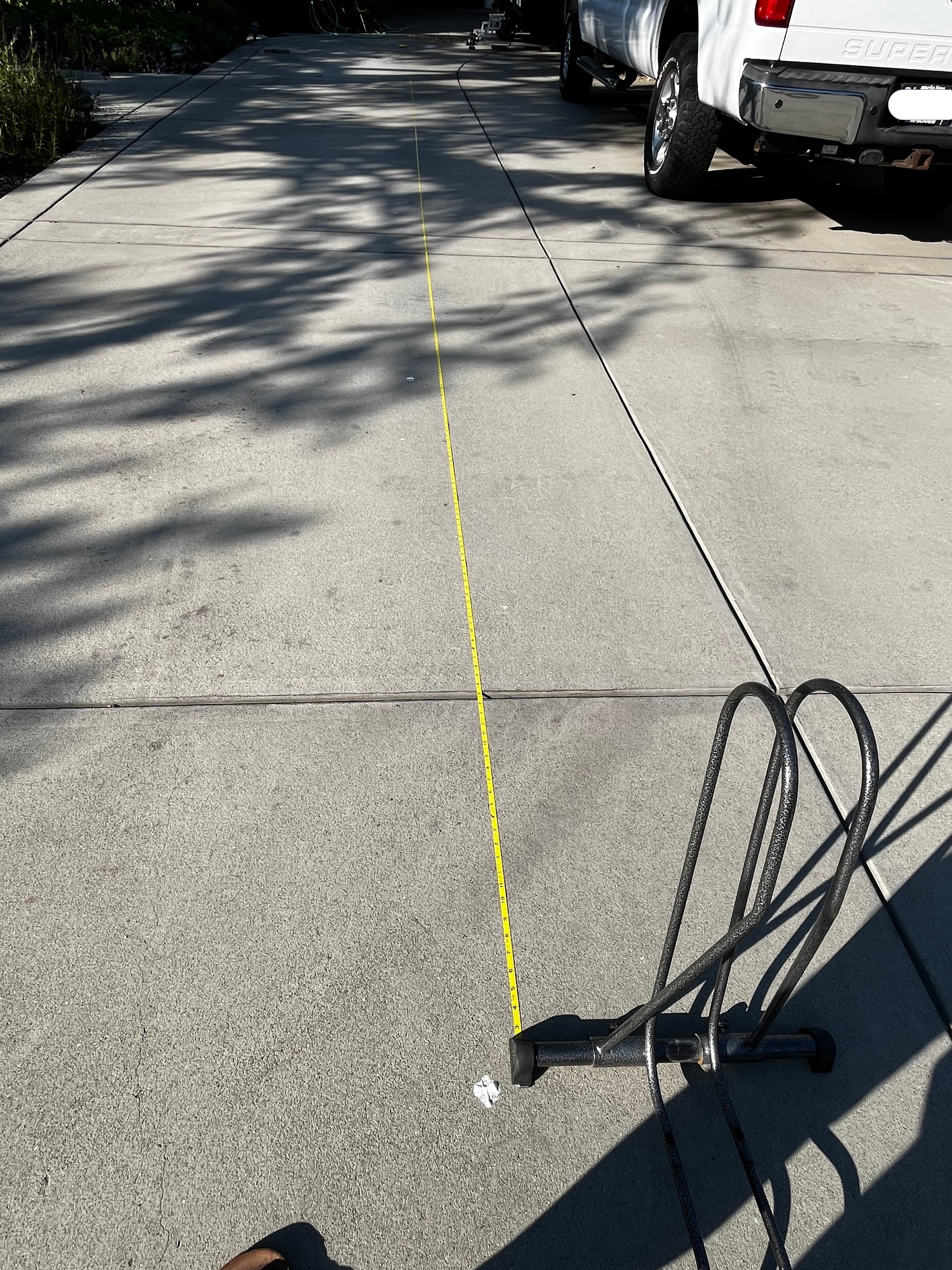

Use chalk for marking your tire. Put a line where the tire contacts your garage floor. Put a matching mark on the floor. Sit on your bike. Roll forward until the tire makes one complete revolution. Mark the garage floor again. Measure the distance between the two marks on the floor. That will get you into the ballpark.

That's precisely correct Rusty, and exactly the method I used to measure mine, but the question is:

I put my tyre size into one of the on-line calculators to give a rough guide to the factory setting in my Flow app. I've got a Maxxi DHR 11 on the back... 27.5/2.4.... the calculator says circumference is 87.12 inches. If I put in the size as 27.5/2.6 it gives me the 88.5 inch number. I haven't changed that setting but when I get a chance I'll have a look and see what is actually available.
One thing I'm not sure about is whether I'd be causing myself any warranty problems by changing it??? If I change the setting to 87.12 that will, if I'm correct, show a lower speed on the Kiox and therefore assistance will stay on for a little bit higher actual speed? Also my recorded distance would be reduced as well.... have I got that right?
Edited to add.... I've now been out to my bike and gone into the wheel circumference settings on Flow. It would appear that I can adjust them from 84.1 to 93 inches.... in 0.1 increments. I haven't changed anything at the moment though.

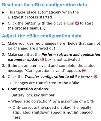

Partly right.
The user changeable value only influences the displayed speed to make it closer to actual.
The cut-off speed cannot be changed by the user or a dealership. This is a second value coded into the drive unit by the bike manufacturer.
Bosch doesn't know the answer
Hard to believe - not what you say, but what Bosch told you.
Bosch delivers all drive units to the bike manufacturer without basic programming. Either during bike assembly or before that at parts reception the bike manufacturer programms each drive unit to desired specs. This includes the four assist modes and the two tire size values. One for the max speed and the second for speed display.
If for any reason the bike manufacturer made a gross mistake and programmed a drive unit scheduled to go into a 27“ bike with 29“ circumference values, this can be changed.
One needs to convince the dealer who sold the bike to collaborate with the bike manufacturer and Bosch. The dealer will do the actual reprogramming but needs a new basic software configuration file from the bike manufacturer and at the same time a special one time code from Bosch to unlock the reprogramming feature on his diagnostic system.
As mistakes can happen with any manufacturing process, this has been done on several occasions. It will need some work and goodwill from all three parties involved. Also, Bosch will not consider the effort for small adjustments. Anything less than 10% off the correct value will be seen as ‚in spec‘.

Thanks @MasterDabber for confirming that your Cube goes from 84.1" to 93", indicating a factory value of 88.5" or 28.2" diameter. This seems really high for a 27.5" wheel which should generally be less than 27.0" (84.8") in practice so I'm not surprised that your speedometer is inaccurate. I suggest changing it to 84.x which should make your speedometer more accurate.
I'm glad to know that Cube set your bike up as 88.5" rather than 89.8" like mine. This is what I was hoping to find from this thread - does Bosch simply lock all motors at 89.8" (2280mm) or do they allow bike builders to configure the correct value? And while Cube doesn't seem to have done any better job configuring your wheel size than Bulls did with mine, the fact that they're different suggests that it's at least possible to do so.

@Shark58 is correct that the user-set wheel circumference only affects the speedometer/odometer, NOT the power assist speed limit, so correcting it will result in a lower speed reading at the time of cutoff even though the actual speed is the same. I tried to verify this with GPS but it's not easy to detect 1 or 2mph variations with certainty. A much better method I found is to ride at max/min circumference and see what pedal cadence the speed cutoff occurs at. If a 10% change in circumference were to actually change the cutoff speed by 10% as expected, the resulting 6-8 rpm difference in cadence would be clearly evident, but it is not. The Bosch service manual also confirms this behavior:
