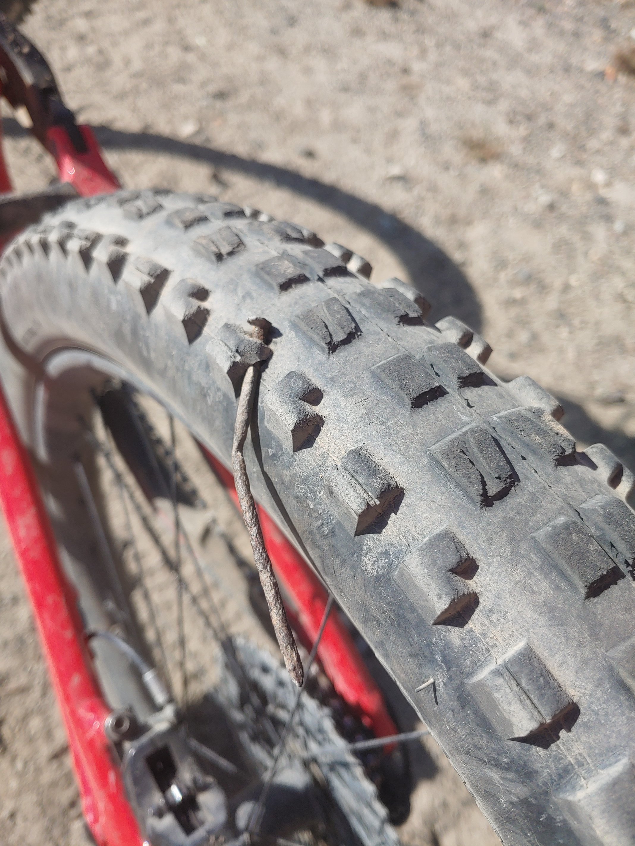

Thought I cracked something in the rear hub with all the crazy banging so I rode home hoping to make it.
