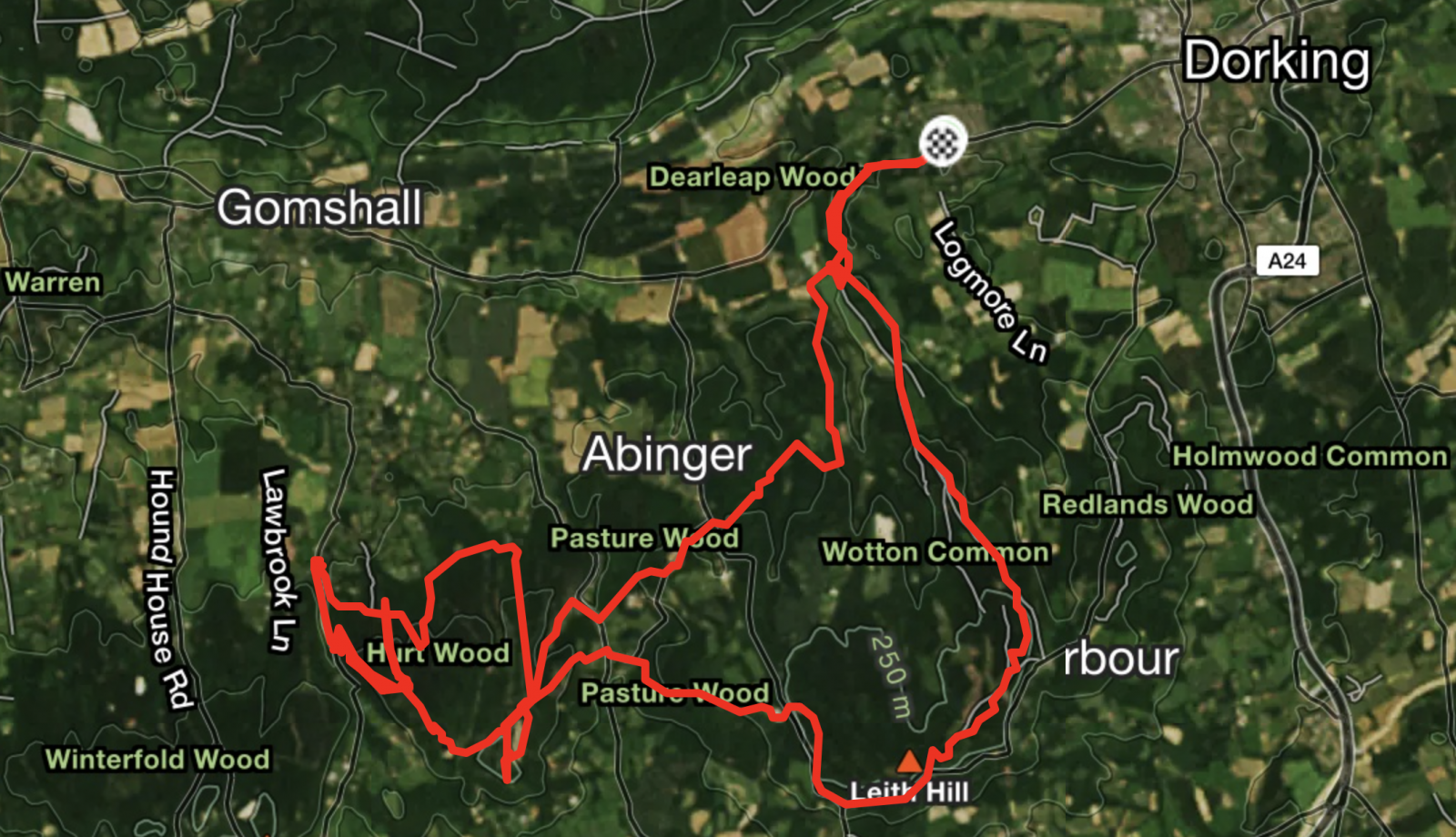

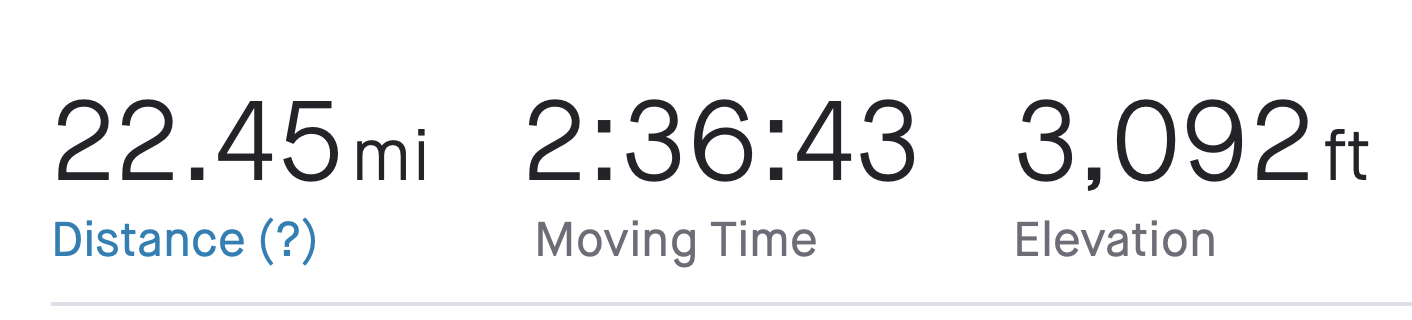

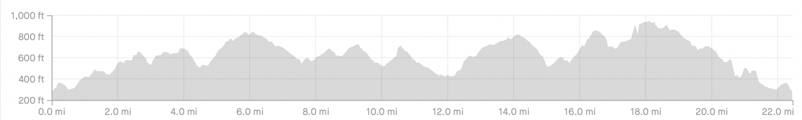

Here is an example of a ride which left me with battery flat at the end of it, was in trail mode only for full ride.
