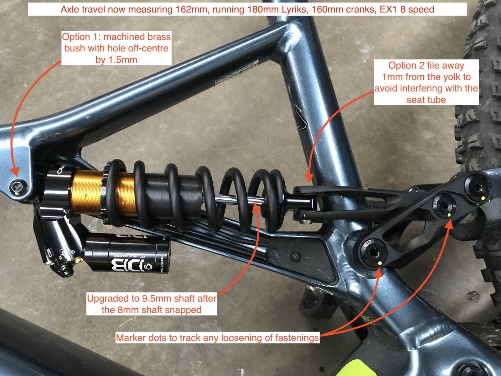

Fox factory 36 170mm GRIP2.
On the rear I already had a spare Cane Creek DB CS from and an Enduro carbon Expert(2015) at home which I then sent to TF Tuned for a complete rebuild... they changed pretty much everything and it now fits my 2019 Levo Expert and also has a 57mm stroke giving me around 163mm rear travel. Spent some proper time on the setup and researching suspension setups, worth doing if you’re buying into forks/shocks with 4 way damper control. Bike rides beautifully and is super plush. I can dial in changes for different ride types and it can handle the bigger downhills really well now. Personally for me it’s a much improved Levo and I love it! ?
I'm running the same Cane Creek and 180mm Lyriks, the bike climbs way better as they absorb everything rather than deflecting.
