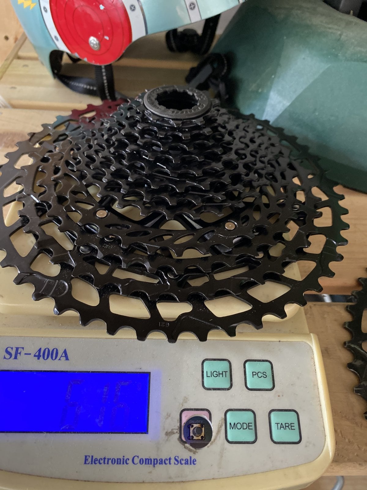

Are you sure there is so much difference in weight? Have you weighted both?
Because according to specifications PG-1210 is 630g and PG-1230 is 615g ...
