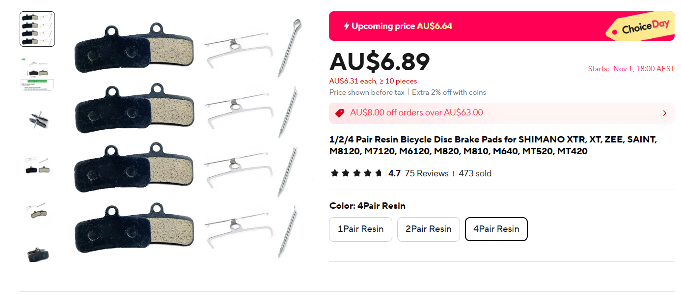

Hi all
I am asking this question as when I Google search for these pads. I am getting pads come up and when looking at the spec it's not showing Br-M8120 or M8120 it's compatibility with ZEE, Saint, M8100, M8020 and so on.
I understand shimano try to keep pads in the same ranges as much as possible.
Any pointera would be great.

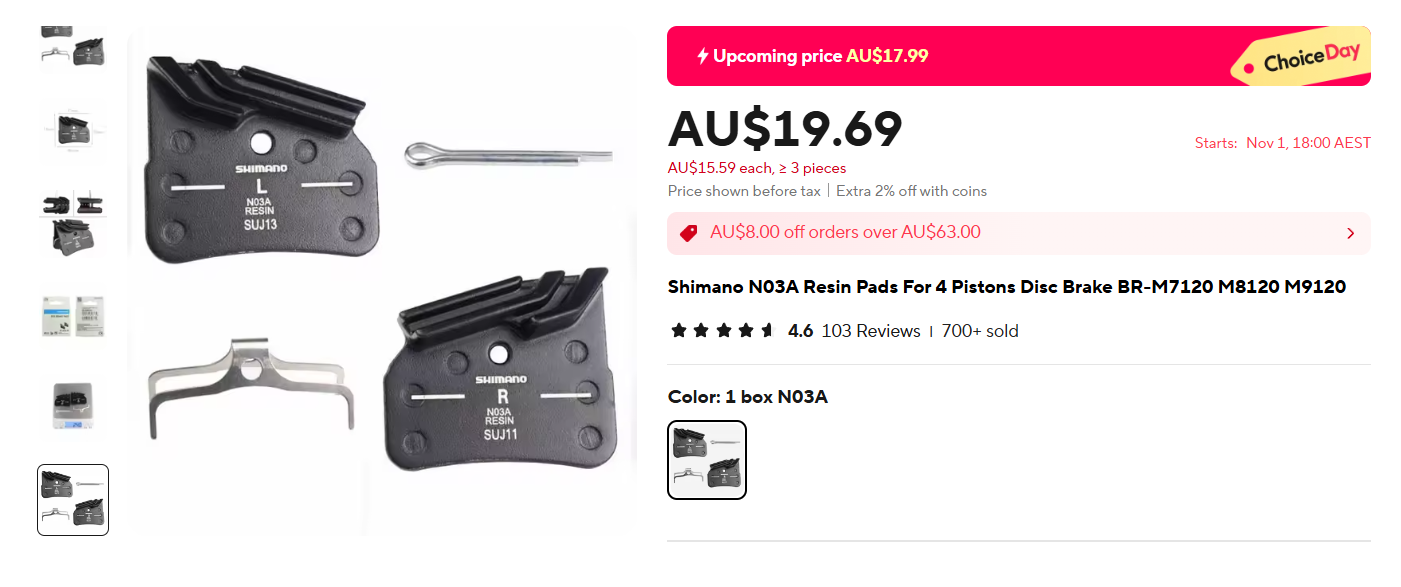

Thanks for mentioning these, most Shimano are out of stock at time of writing this, searched their e-bike pads and found M8120 in the description for one, and I've received these replacement pads next day. Haven't fitted them yet but will report if they are noticeably different in feel to the stock N03A's.
