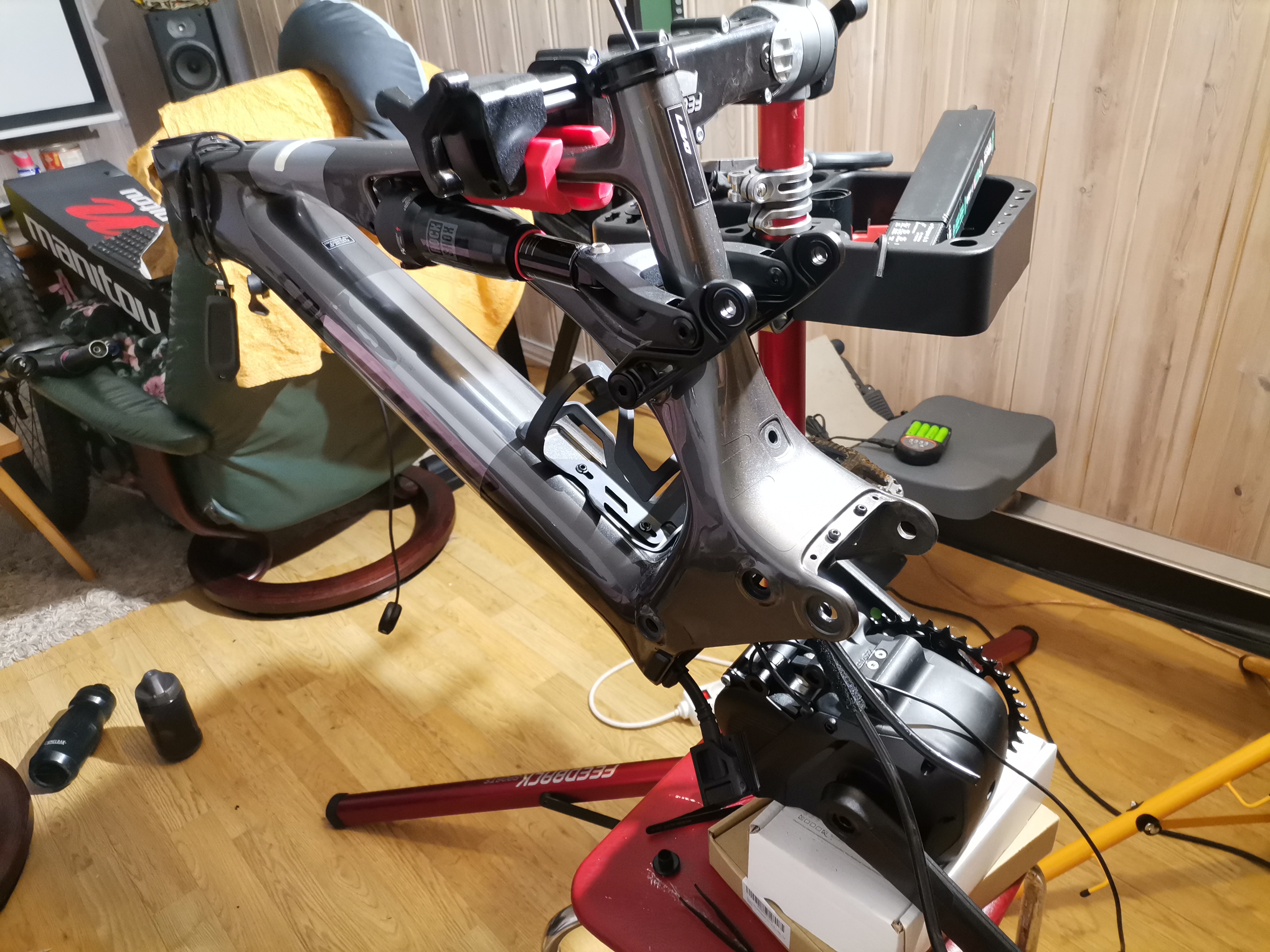

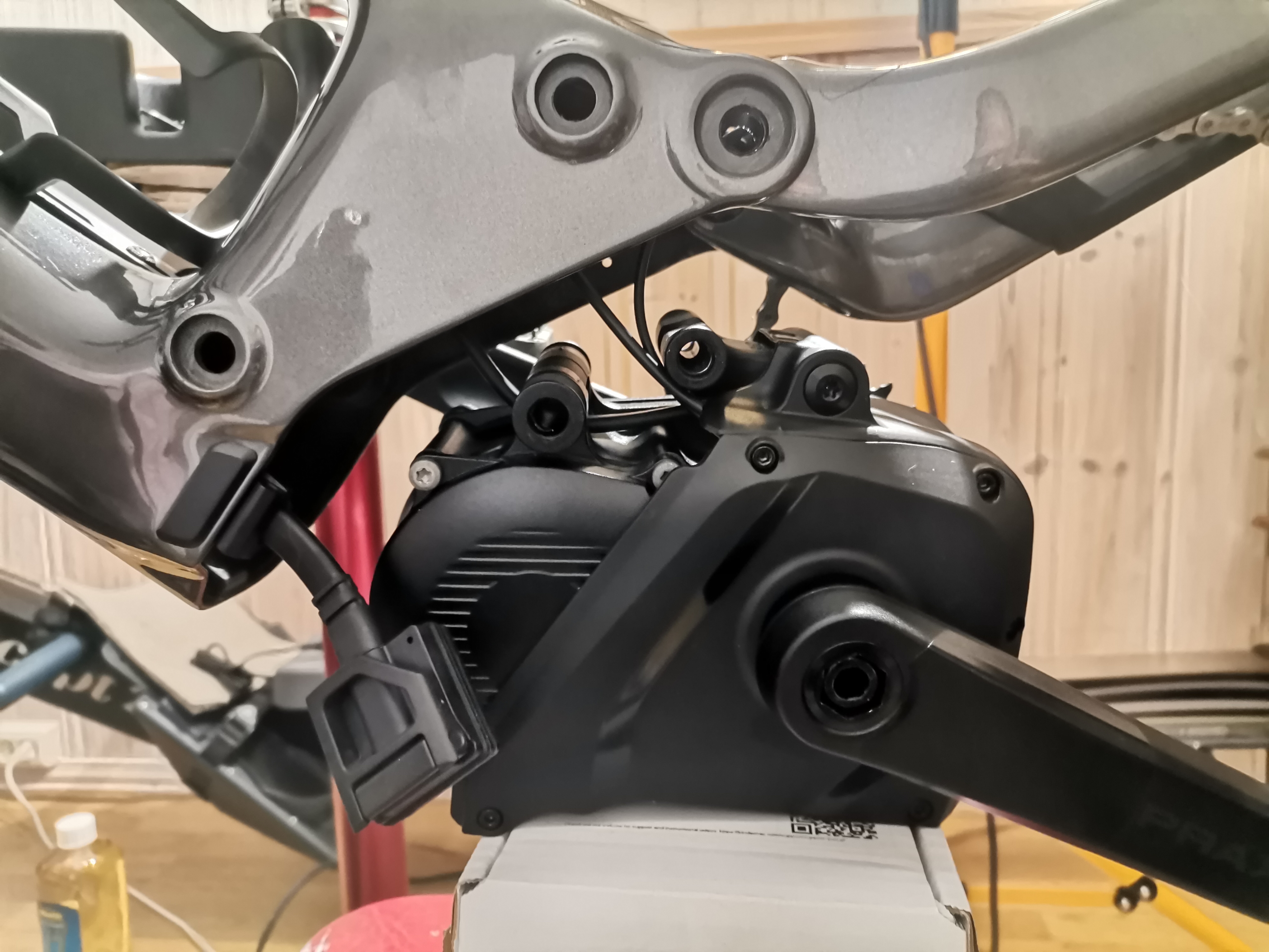

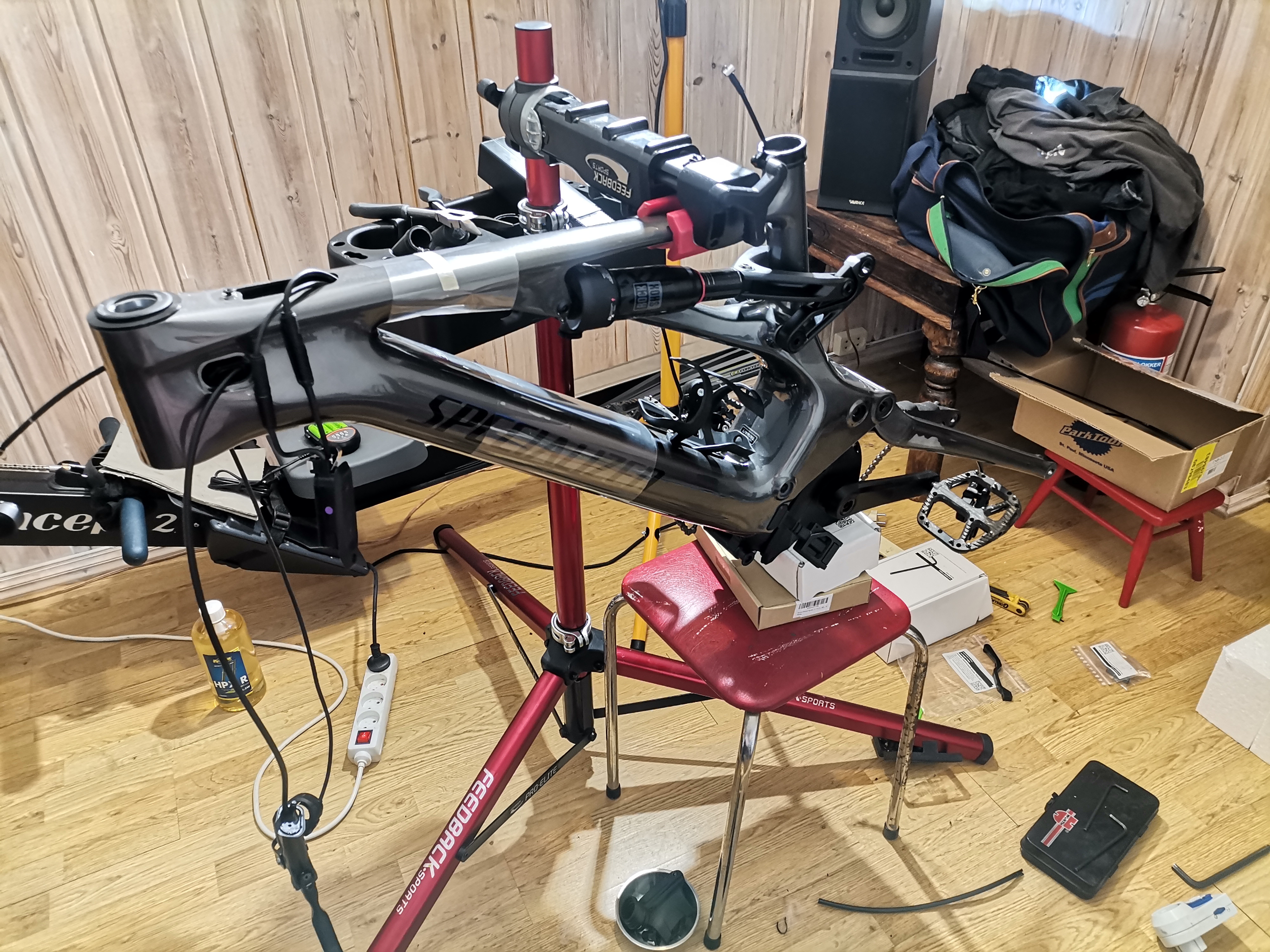

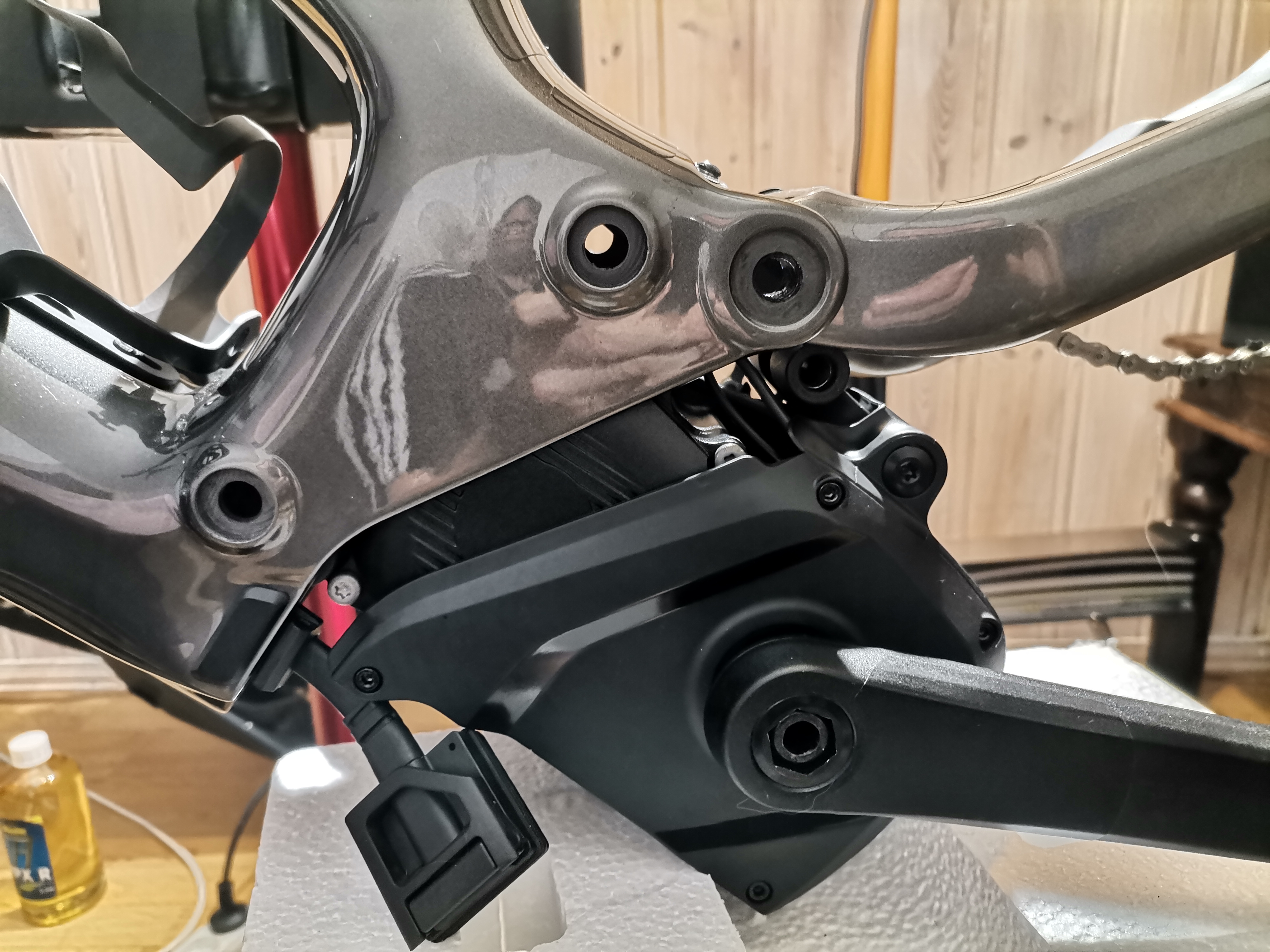

I did measure AFTER taking stuff off, so i forget, but tried to put all the stuff on weigth=ca23,6 kg stock S2(seems to much) with 700 battery.
Now change light weight brake discs 203mm trickstuff, and some Chinese leveler, Maguara mt5 pot, sold my mt7, because read about small gap to brake rotor. Mounted Kinderney hub gear, new hoses on all braks and gear. new Wolf Tooth resolve dropper, wow, they sendt it so fast that i have never experience that, and it work so good, but just to early. New Manitou mezzer pro, and not mounted yet Mara inline, sendt back pro version because of weight and no place for bottle. Order carbon rims.. build my self. Never ending story.... But the Kindernay gear is nice, but not without problems.
Some pics...
View attachment IMG_20230423_131623.jpg View attachment IMG_20230423_131906.jpg View attachment IMG_20230423_160439.jpg View attachment IMG_20230423_175614.jpg
