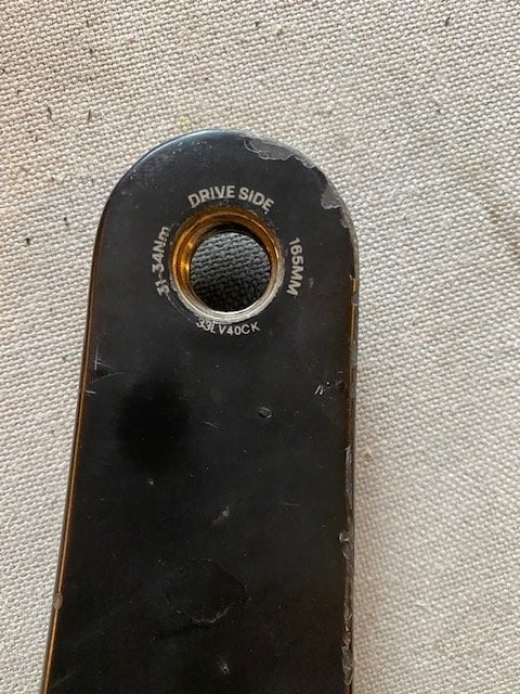

Just thought of this the carbon arms I got from @ethirteen are 165mm like on the 9.9 and 9.8xt are its a good length in my opinion BUT the pedals have backed out everytime I ride. I put green locktite as its not permanent but it is becoming a thing.
Make sure you have the cranks on the right side.....there is a drive side and a non drive side....if they are back to front the pedals will back out.
its written on the crank under the protective block so not seen normally
