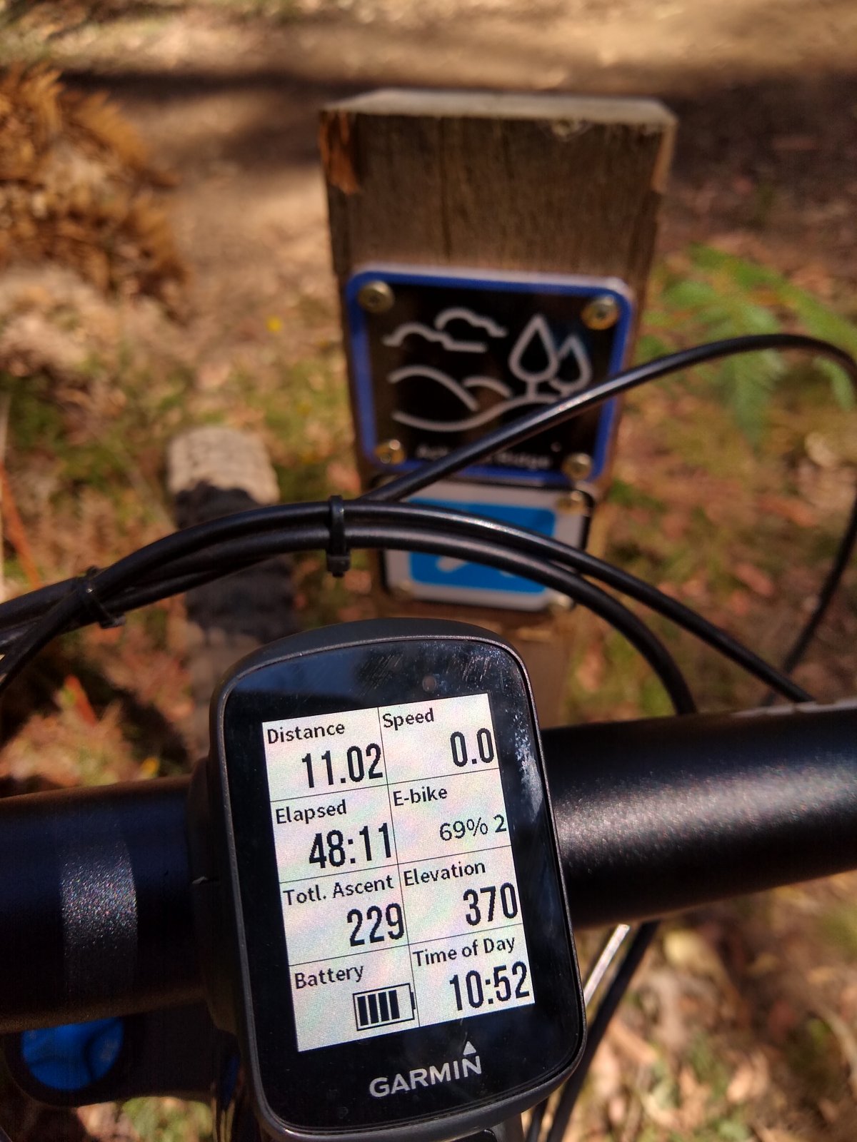

Got a 130 Plus which was the cheapest i found that connected with ANT. It's great, giving an instant connection to the Trance and shows battery % precisely with EBike field
The only error it has is trying to match its 6 power levels with the 5 on the Giant.

Do you know if a regular 130 would work? And how exactly does the Ebike field work? I download the app on my desktop and "flash" the Garmin?

It's a ConnectIQ field. I'm not sure how you'd use it on a desktop machine, but with your Garmin phone app you'd download it, synch to the 130, and then on the Edge you add the field from the ConnectIQ portion of the field menu.
