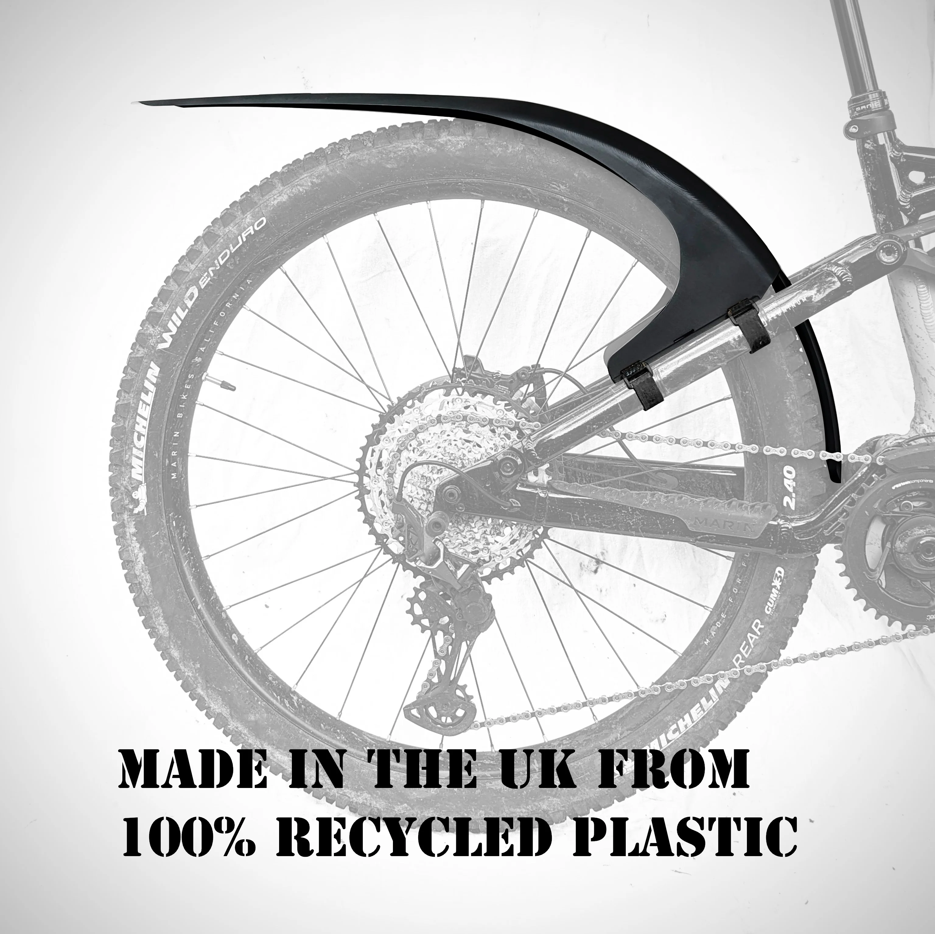

The big thing about mud and wet weather riding is the fire hose like spray off of the front wheel in particular hitting your battery and motor areas and the almost direct mud throwing rear wheel that lobs mud up your back. Do yourself a favour and fit proper mudguards like the mudhugger series, yes your mates are going to rib you but your bike electrics are going to love you. They won't stop fully you getting hit off the rear wheel but the Mudhugger large rear ( don't bother with the med or original, they are just not long enough ) goes a long way to keeping things down to ground level.

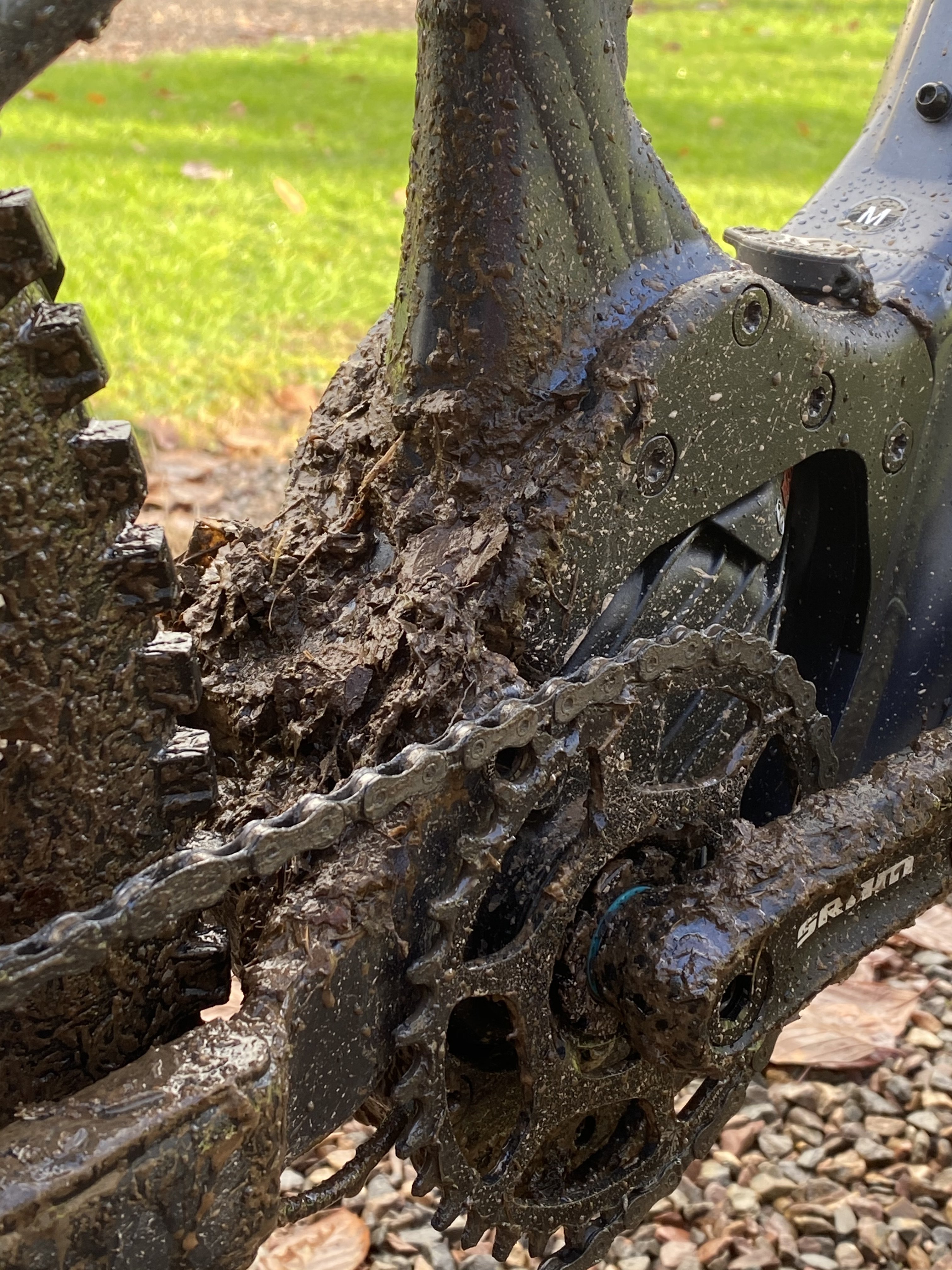

I wouldn't get out in Scotland if I waited for dry weather. Don't hose except wheels. Trouble is big tyres throw a lot of water at the motor it gets in where its hard to get dry without stripping down cranks etc. Motor number four. I am not using in wet now to see if there is any difference I am using a gravel bike if wet so we will see.
