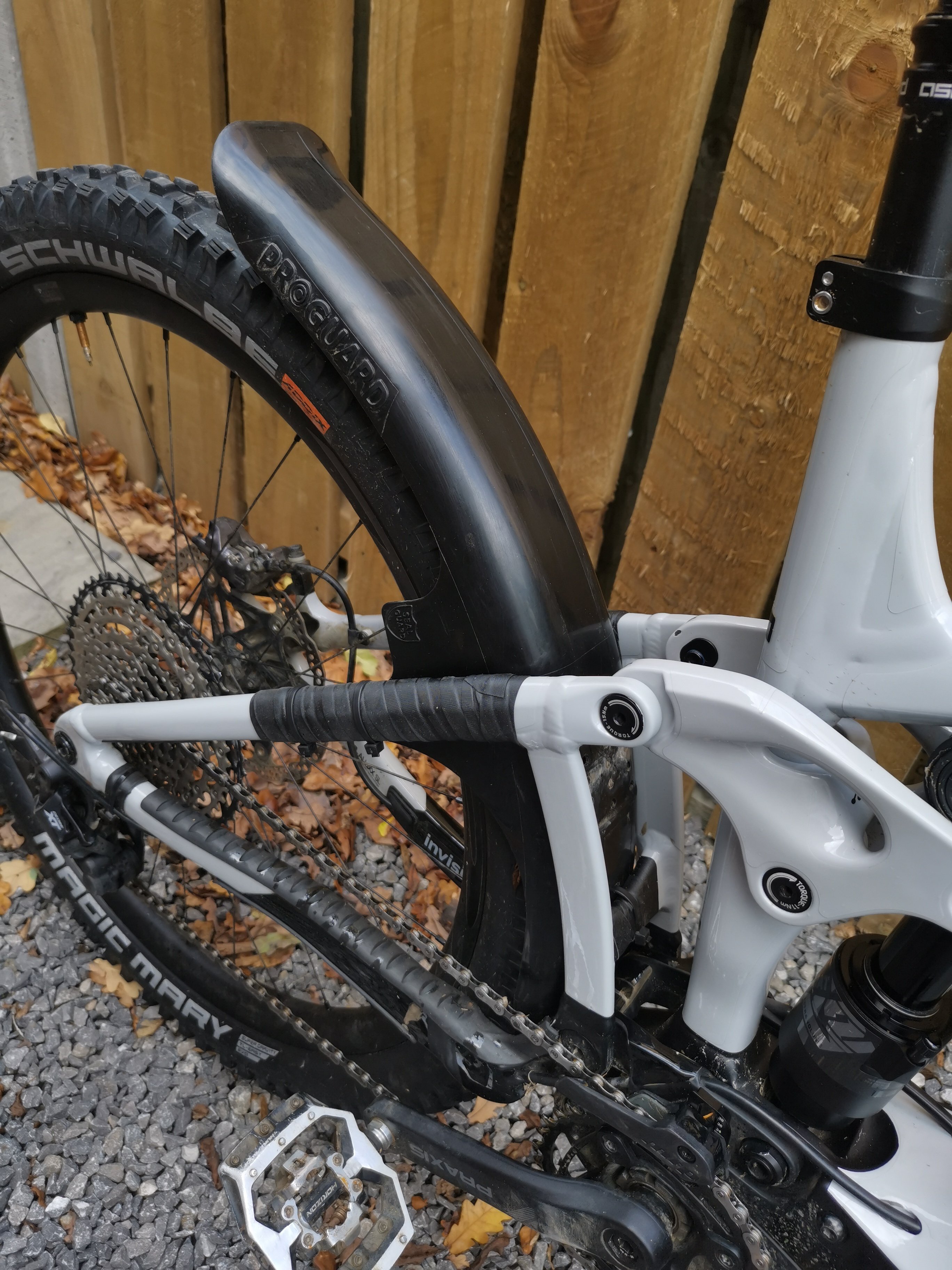

Will fit a mudguard at the back to protect the linkages/shock - there‘s huge pile of mud and stones in there right now!
Expect suspension tweaking will be needed, but base settings from Fox do feel pretty good. Might take the tokens out the fork just to give me more volume - I’m a big fella, tokens and smaller air chambers be damned!

If you looking for a rear mudguard I've found a front Rrp Pro guard max fits like a glove on the reign, just drilled 2 holes to loop a zip tie through on the lower chainstay brace.
It keeps the bike much cleaner and really helps keeping water out of the motor area.
Bit of self amalgamating tape helps protect the frame and the zip ties bed into it and stop any movement.

Cheers, that tape is a good idea. I’ve taken the medium pro guard off my Pole and I’ll see how it goes. A longer one like yours may be useful. Good to hear your experiences with tokens, my history concurs.
