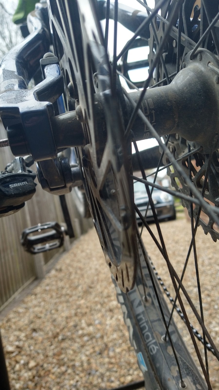

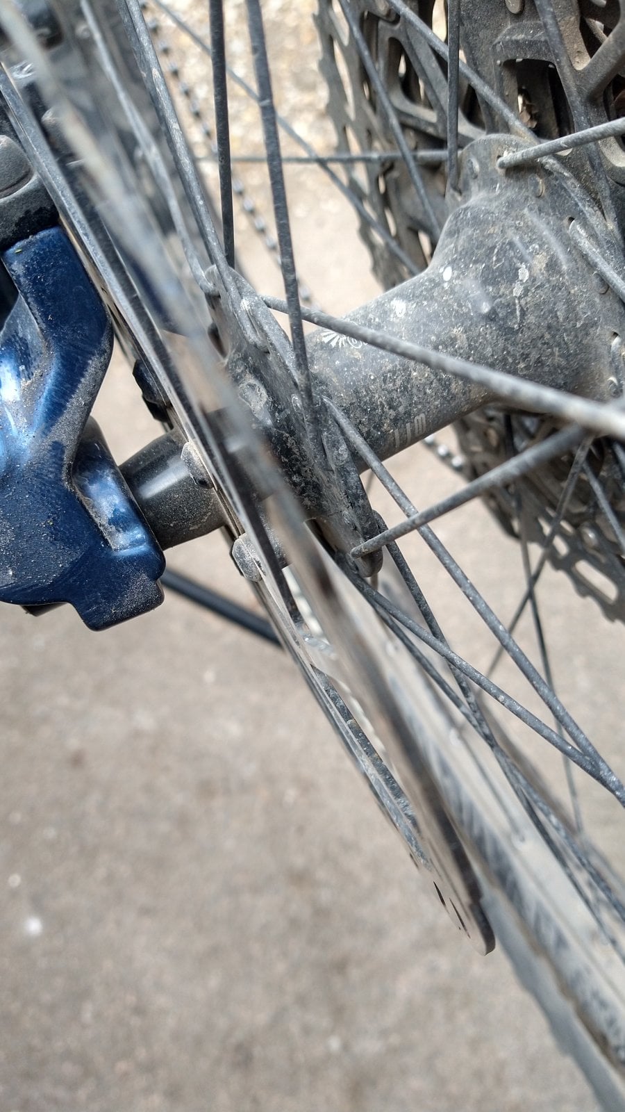

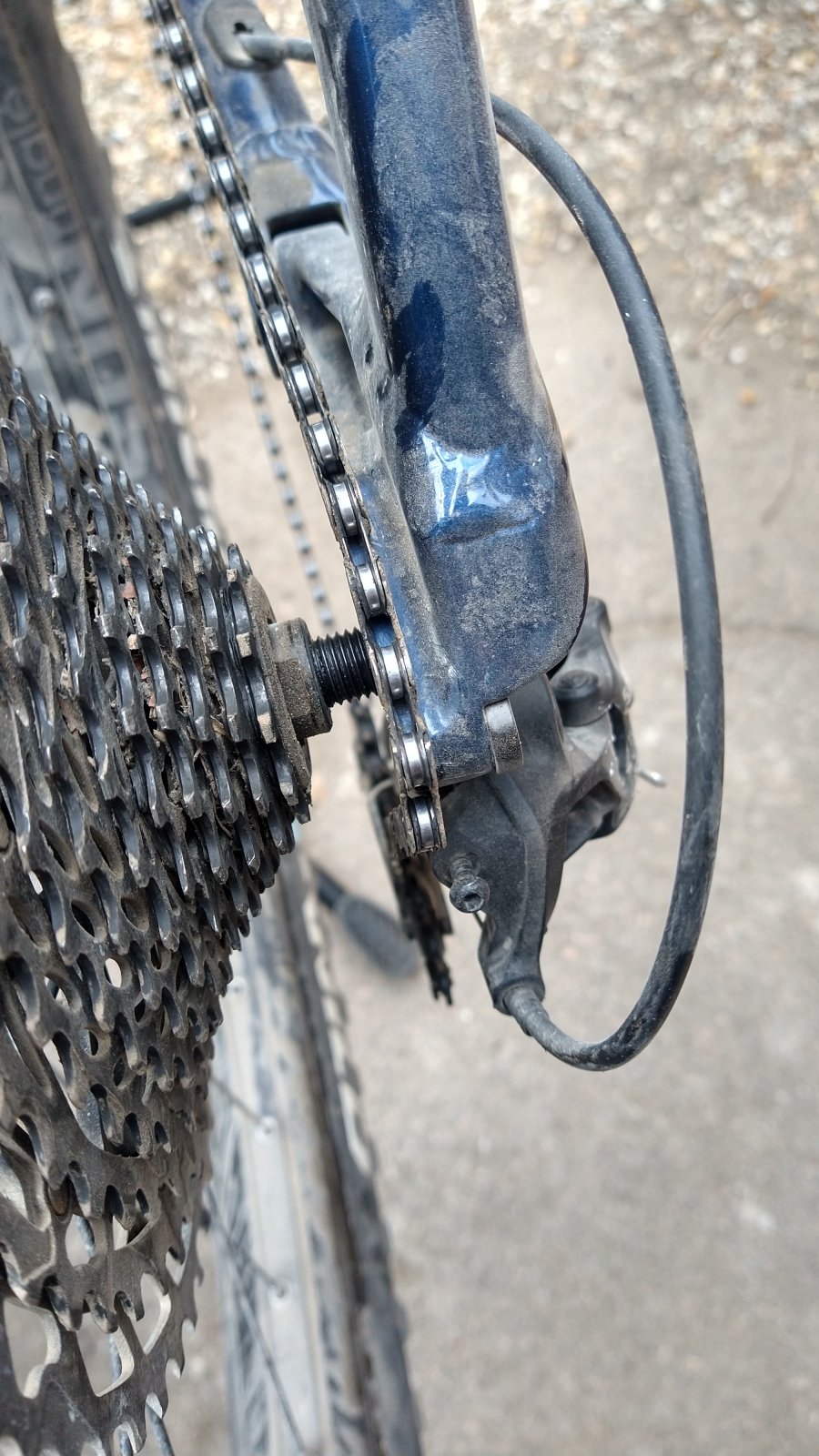

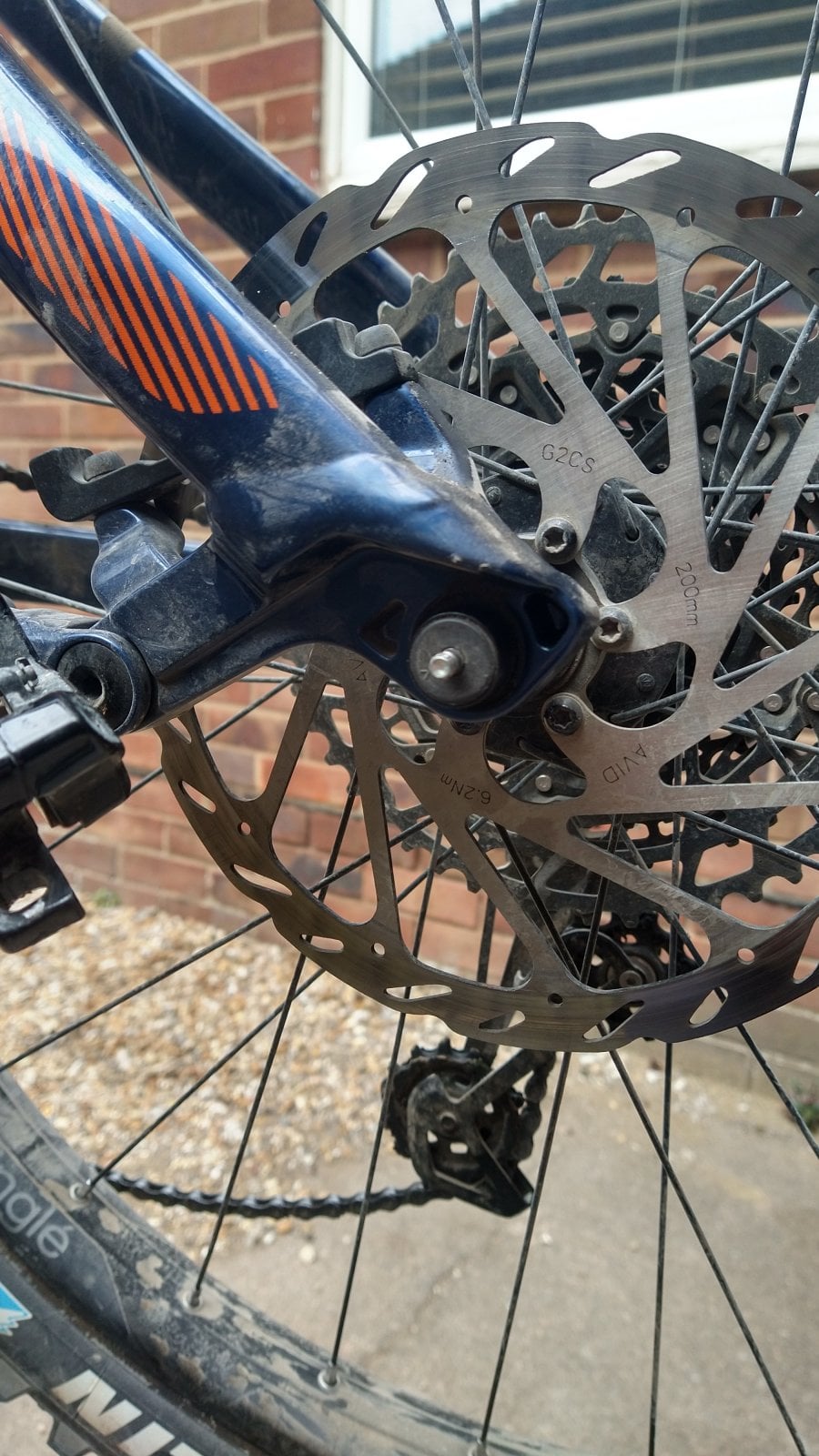

Pics. To compund things, I've managed to strip the cam thread, so mole grips here we go. First image shows the threaded maxle end wound out of the frame. It should at that point be inside the hub, on the way off the bike but it's pushing against the dropout, effectively stretching the rear triangle. Hopefully that explains it sufficiently - the maxle rotates & winds out but is being kept in situ somewhere along its length.

there's no internal expander in that thru axle design.
it has an external cam.
if I'm imagining your extremrely poor photo of the non drive side correctly ;)

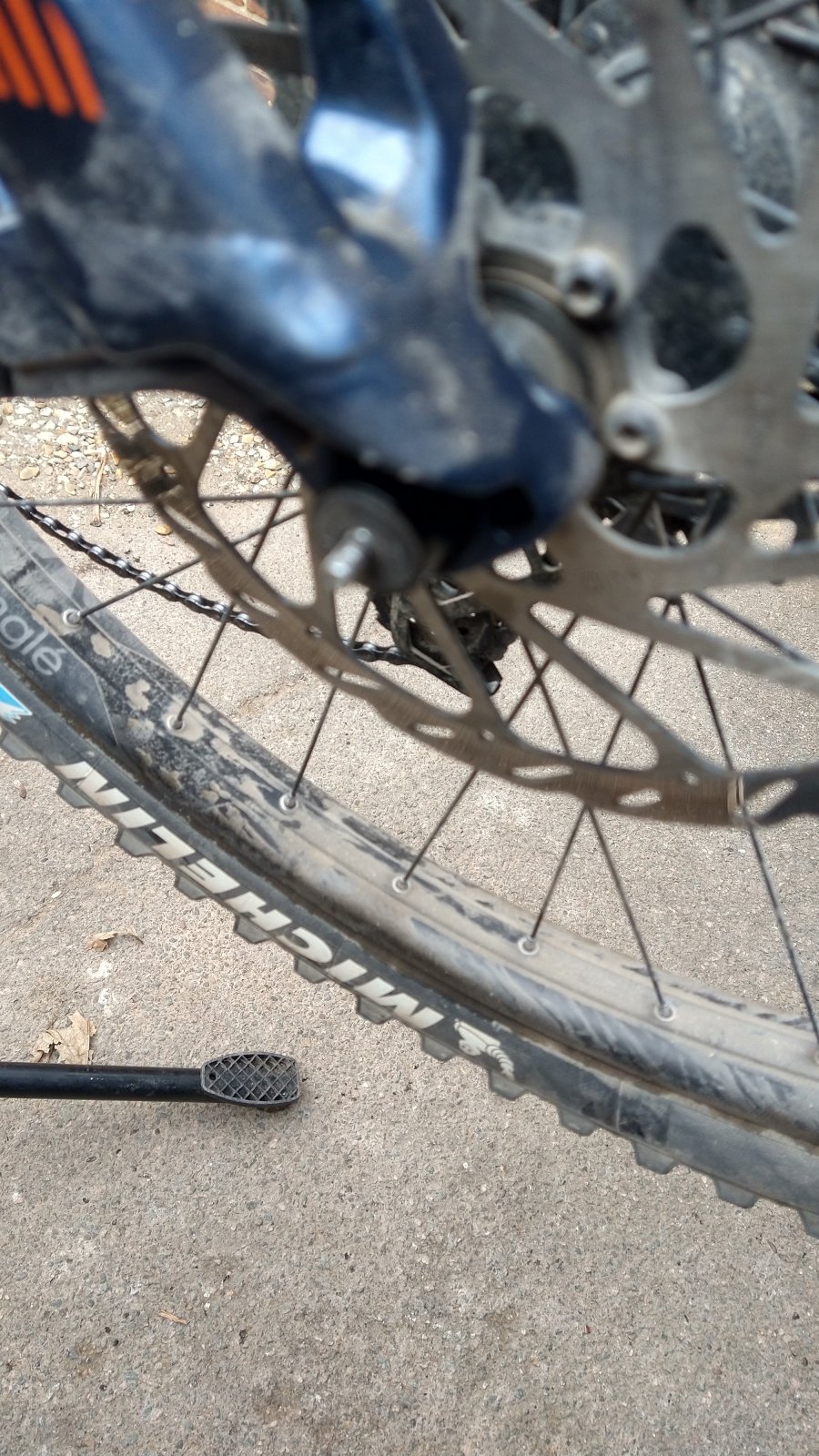

RustyMTB
Jul 22, 2020
2,832
6,844
Imagine my riding skills as a percentage of my photography skills...
So the problem is on the NDS, you can (maybe) see here the NDS has a plastic cover over the axle end & it's strating to look like an LBS job to me, it won't budge.

have the threads (where the QR attaches) stripped?
can you turn the end cap with grips? (pipe grips/molegrips?)
or if it's plastic, possibly force (hammer) a suitable sized (slightly undersized) deep socket over it

Super quick bike repair dude has been on the phone, he's got the thing out & said it took him two hours, six drill bits & a bit of skin off a knuckle. Galvanic corrosion apparently. I think we'll call this one answered. Thanks for the help fellers.
