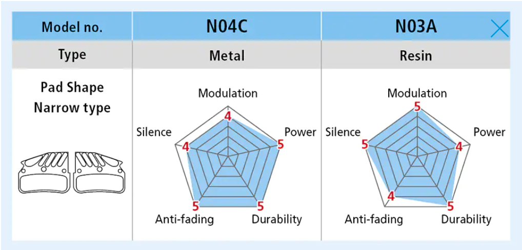

Keep in mind the factory pads are resin. I upgraded to metal pads and prefer the quicker initial bite and power with less fading.
