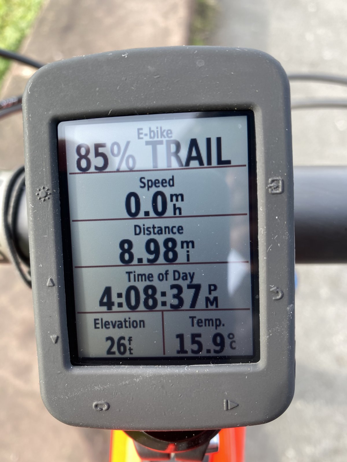

I was using a Garmin edge 520 plus (pictured) which gave all of that info’ and more, have recently updated to the Garmin edge 530 as it’s a little bit bigger. You just need to install ebike field to get the mode and battery percentage left.
