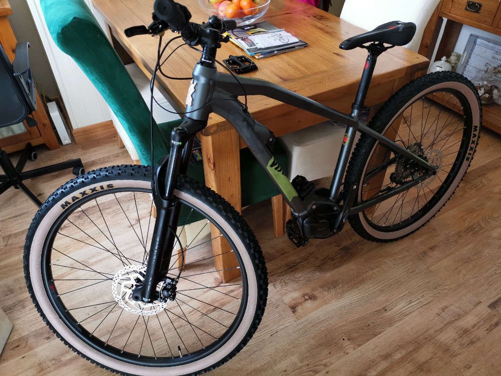

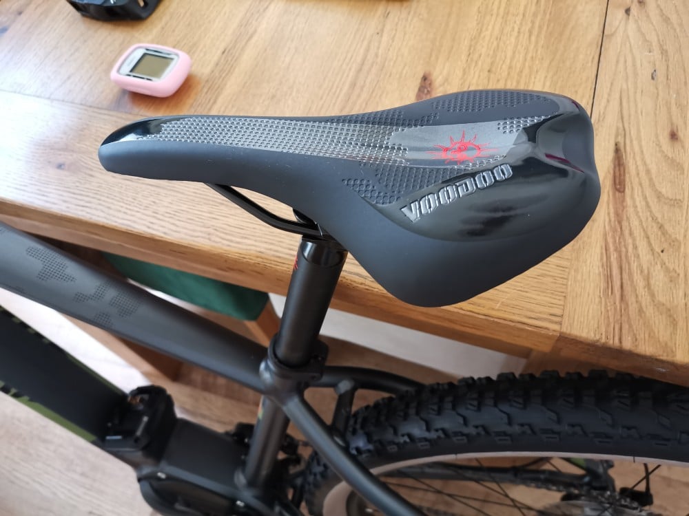

Needed a new run around so got a hardtail with shimano E7000, will do the job and be able to commute to work.
I'll let you know how it fairs once it's up and running.
Hope dropper post fits, if not will get one as can't do without one.
Here it is....bonus being with the Spectral-On's X 2 we now have 5 batteries

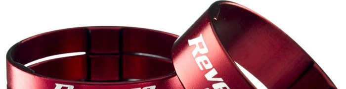

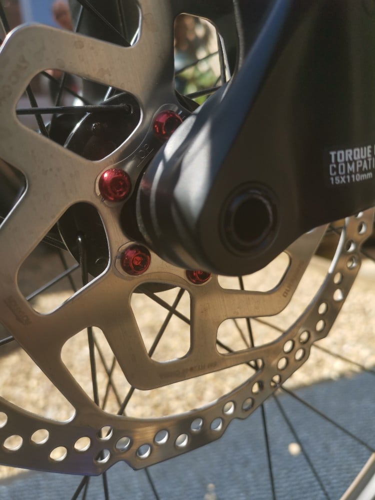

Got me some new bling as you do....not put it on as yet but when I do I'll post a pic or 2
So far very please with it, very playful, quieter motor in the E7000 and lots of fun.
Pedals are also "reverse" escape which I have on the Spectral, but in pink, Brand X ascend dropper thus far. Worth the money.

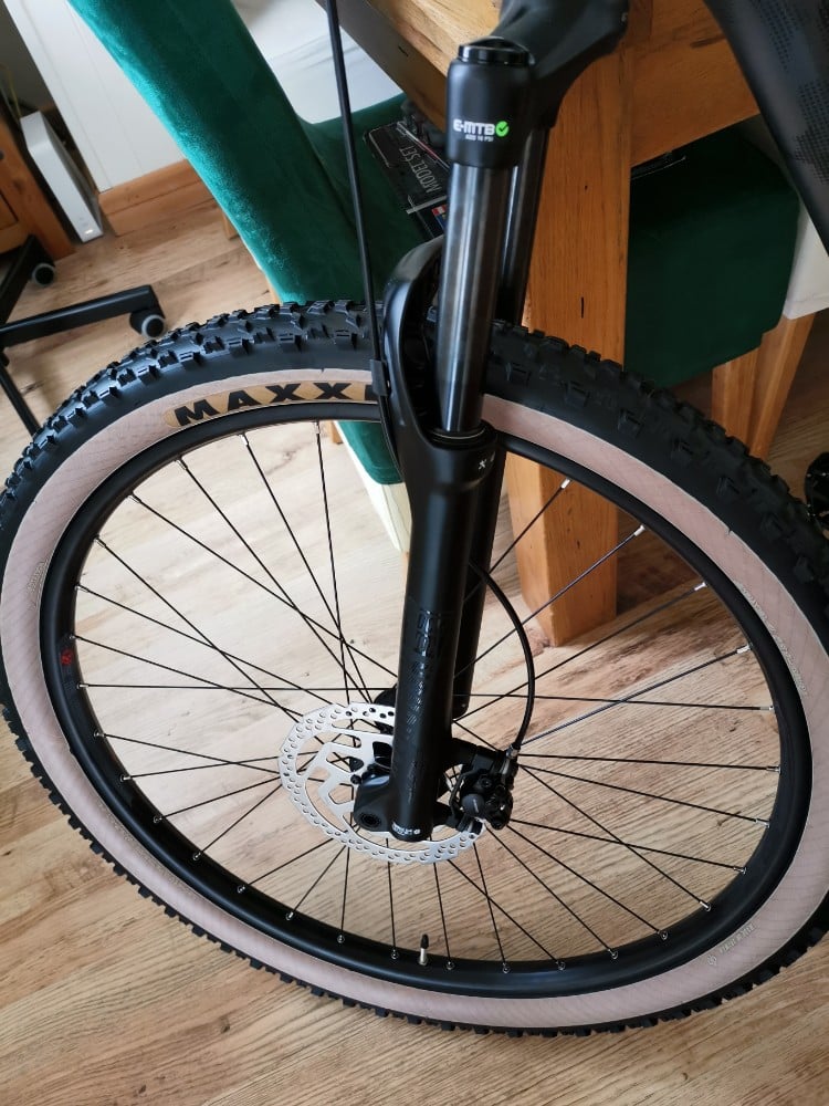

Bling gone on...
Will wash it after tomorrows ride and post pics.
Just waiting the red pedal pegs and the chain ring bolts in red and then it's done.

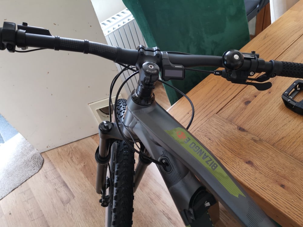

Hubby did it. Dropped out the motor, fed down top tube, via the top port and slightly enlarging the whole, watch out for pinching and kinking when putting the motor back. Bit fiddley, inside the tubing not the best finished off had to file some sharp bits, dontthink it's really designed for a dropper, but it works. I'd have externally routed it if it hadn't worked as can't be doing without one. Being female ona man's bike stand hight dictates i need to stop and drop.

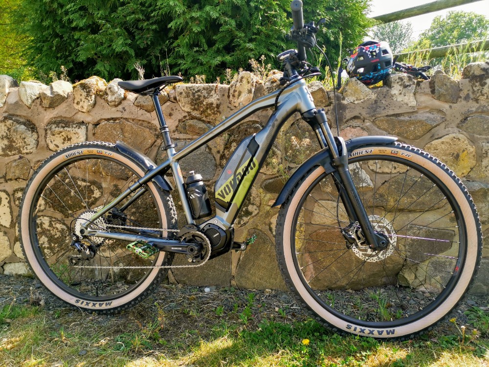

Well it's had a tiny bit of a makeover just to get it to look a little how I like, so ignore the rear mudguard i have to have it on as being a nurse commuting to work I just can't get too mucky (I have toe Spectral-On for that). Decals were the final thing to go on.
Cracking bike for the price and does it's job.

Mudguard on front is RRP on back it's a zefal
