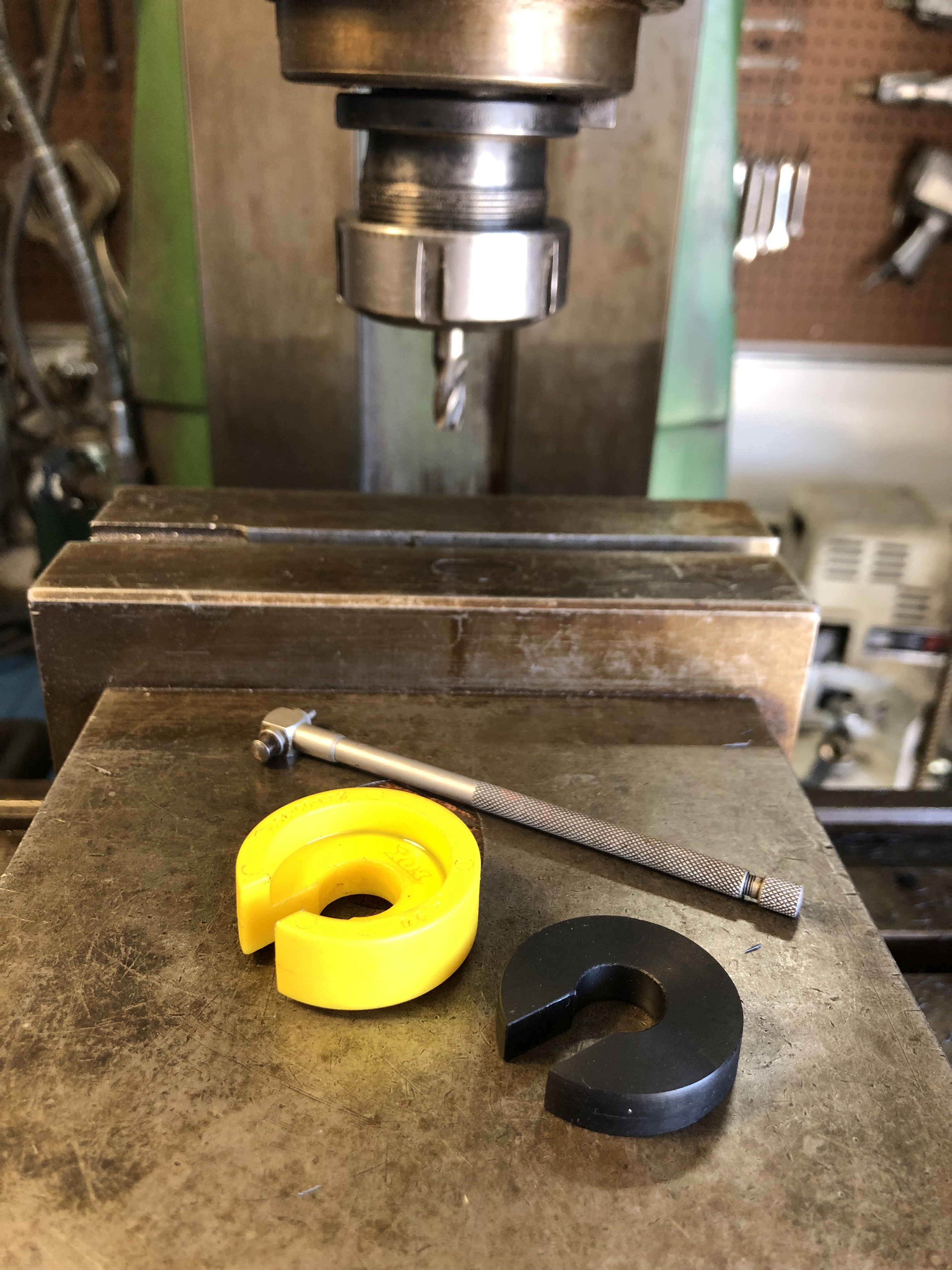

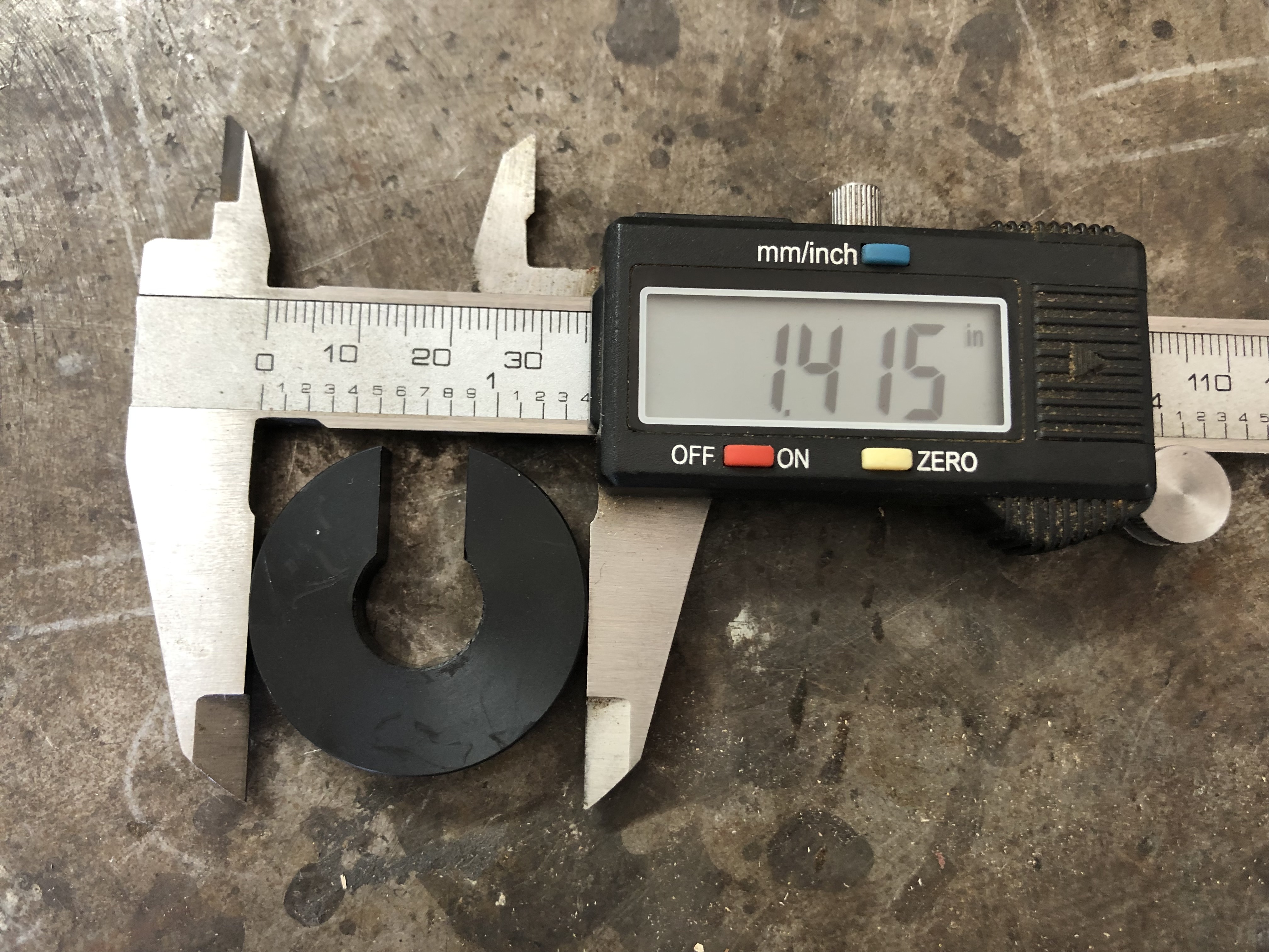

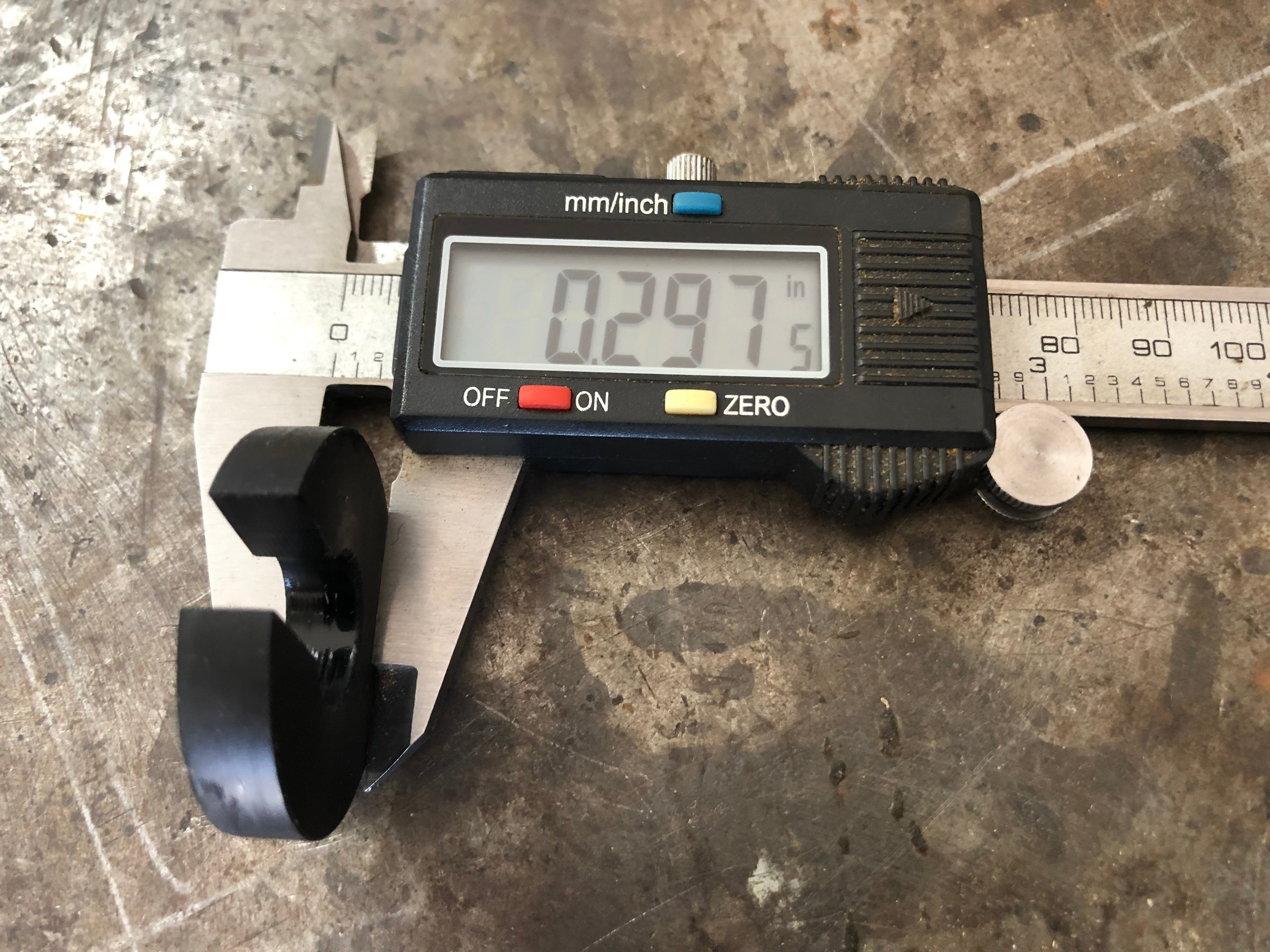

Sure you can make your own! For over a year I've been running a volume spacer that I made out of a chunk of Delrin. Yesterday I was doing a service on that shock, and decided to cut another 0.050" off the spacer. I've also cut down volume spacers for forks. In my mind, it makes no sense to go out and buy a set of spacers when you can make something that is EXACTLY how you want it.
Bambam is correct in that you'd need to measure water displacement if you wanted to know the exact volume of the spacer. But don't get hung up on the number. You're trying to achieve the best performance, not a specific number.
