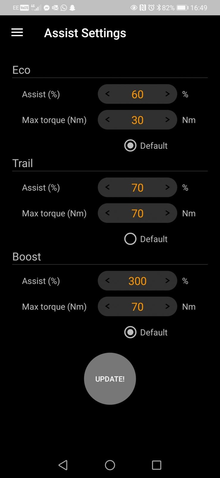

I've had this reply from Shimano (Madison?) today -
Hi Paul,
We have actually fed our findings back to CRC on this matter already so I gather you are in communication with them?
In any case, one possible option is difference in eco/trail settings:
Based on the Unit Log Acquisition report we can see that the Eco mode is set to High and the Trail and Boost modes set to Medium. As we don’t have a ULA from both bikes we can’t compare the settings to make sure that they are both running the same. It could be that one is set to Eco High – the other to Eco Low. If you are riding side by side but one bike set to high and one to low then the bike set to high will always be using more battery energy. This is a good place to start I think and can be changed if you use the etube project App on your phones.
You state they keep the tyres inflated but I’d recommend a full bolt check and disc brake rotor alignment check, you can ride an ebike and not notice the rotors rubbing as much as you would if you had to use human power. Unlikely, but worth a check.
So downloading the E-tube project app may be a good place to start if you haven't already - https://www.shimano-steps.com/e-bikes/united-kingdom/en/service/E-tube
I hope that helps.

Well, I've not heard anything back from Wiggle yet, but I have had this back from Vitus yesterday -
"Hi Paul,
Thanks for coming back to us on this and attaching the report.
We have been over this quite closely to see if we can get to the bottom of the battery life issue you have encountered.
There are a couple of things that have jumped out at us which may result in the reduced distance.
On the Drive unit section of the report, there are 3 sections relating to Assist mode - Boost, Trail and Eco. Currently the Eco mode is set on high, which would explain somewhat the shorter distances and drain on the battery life. Ideally these modes should be set as follows:
  • Assist mode Boost - High
  • Assist mode trail - Medium
  • Assist mode Eco - Low
Now if you have access to the Shimano Etube app at home, you can change these yourself, have a look at the following link.
If however you don't have access to this and you need to pop back to your mechanic, could you also have them check the tyre circumference of 2265mm as this does need to be quite accurate, as for example, if you have changed the tyres to a bigger size and the bike still thinks you are running the original tyre, there would be a slight increase in speed which also results in an additional drain on the battery.
I hope that helps Paul and solves the problems on both bike's. We would be interested to hear what Shimano have said in relation to this drain.
Anything else I can help with, please feel free to drop me a line.
Thanks,
Alan"

Hi Paul, interesting read.. I'm now on my second week of owning an E sommet. I have the 2.5 maxxis assegai tyres running tubeless and I would agree for what you say you are riding they're far too soft a compound and weighty. I'm still learning the limits of my range and ran out of battery riding home from the bike park last weekend.. Tried to continue with it off after 1 hilly mile decided it was very unpleasent. I got about 32 miles in before it died. This did include 10 runs of the steep trails with climbing back up mostly in trail so not horrendeous I guess.. I'm now looking at changing the assist settings to try and find the sweet spot. Going back to your tyres from previous experience I would say maxxis high roller tyres could be a good try. Otherwise I have also run onza ibex on previous mountain bikes with good results. All the best Josh
jpj. 92
Oct 13, 2020
22
11
Uk
These are the values that are installed on the dynamic setting and explorer setting using etube app. Explorer mode being the one with 200%assist in boost mode.
