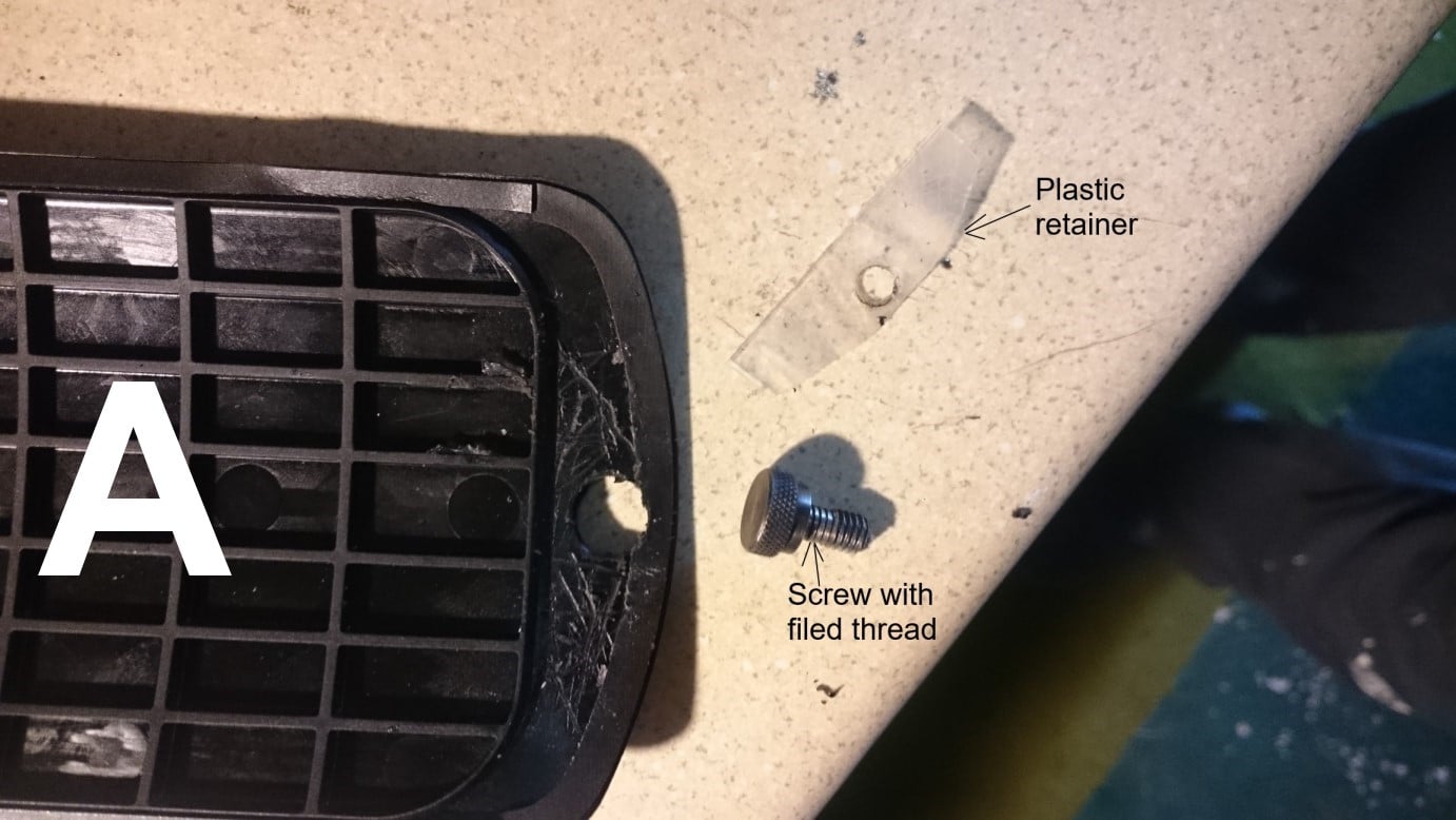

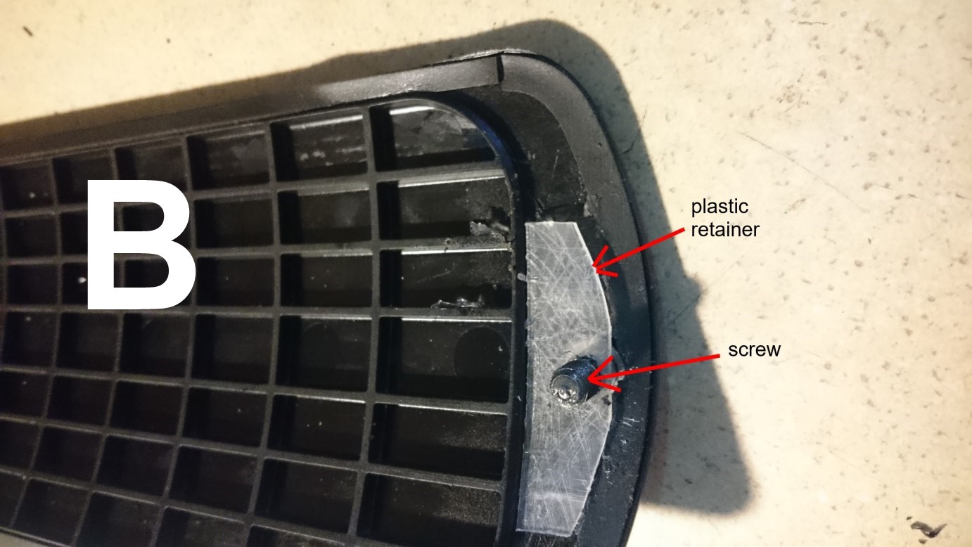

I HATE the BATTERY COVER on my Vitus!
So I have modified my mine to enable quick and easy removal - I nolonger drop the top allen-screw and spend the next 20 minutes looking for it!
First:
I have replaced all the screws with these: Knurled Thumb Screws £3.50 (PrecisionGeek Black Steel M6 x 10mm Knurled Thumb Shoulder Screws (Set of 5) | eBay)
The two bottom screws can be used as-is.
Second:
the top screw needs to be slightly modifying: filing/grinding off 4mm of thread (knurled end, zoom into photo A and you can see where to do this - it is required to ensure the plastic retainer is not pushed off when unscrewing the cover).
Now to make a plastic retainer (to stop the screw falling out), all you need is a strip of soft-plastic, cut out as shown in photo A, drill a 5mm hole, and bond to the cover as in photo B (a little scoring is needed to create a key for the glue of both faces of the plastic).
Now removing the cover is easy. Slacken the bottom two screws, unscrew to the top screw which is now retained within the cover. EASY!

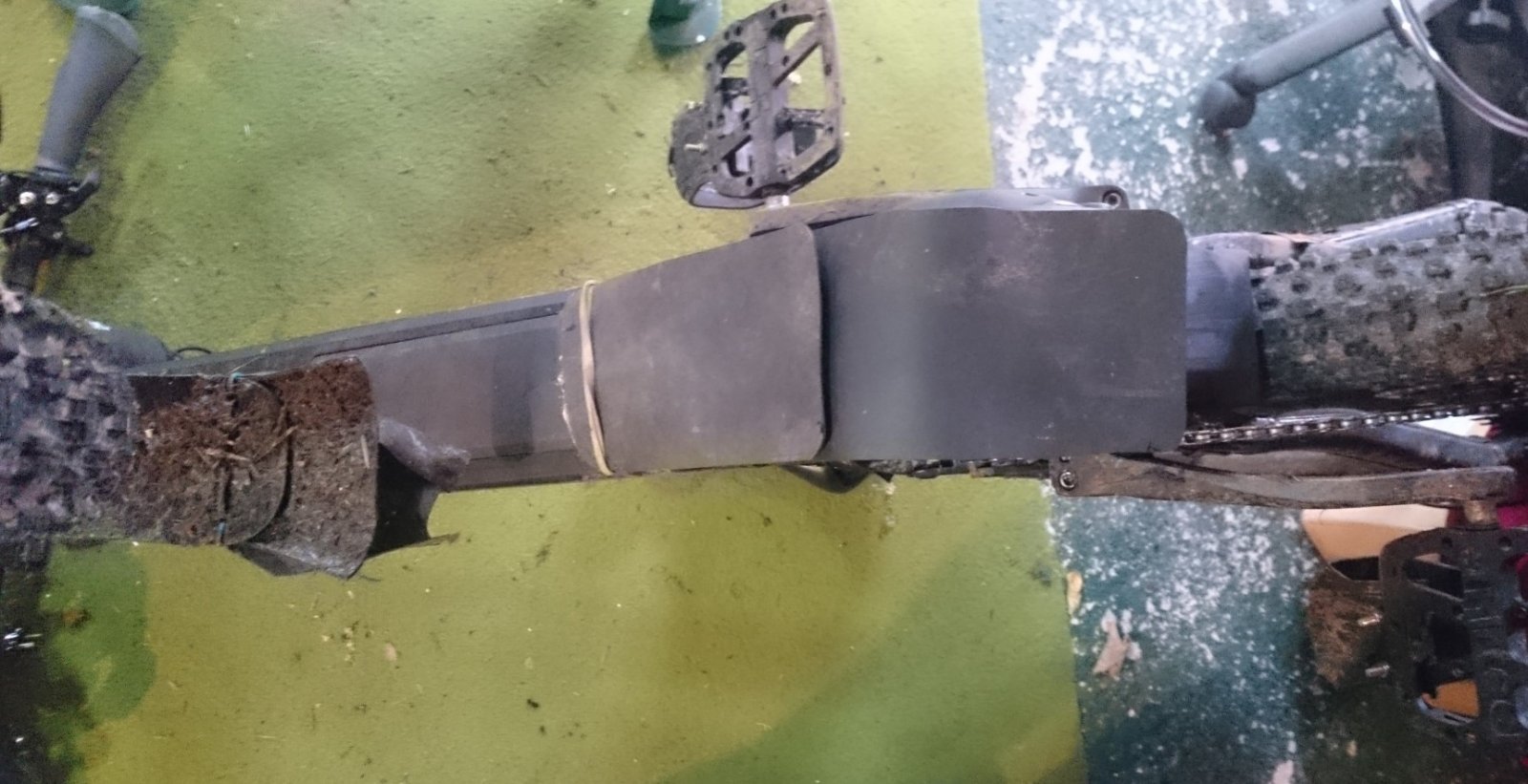

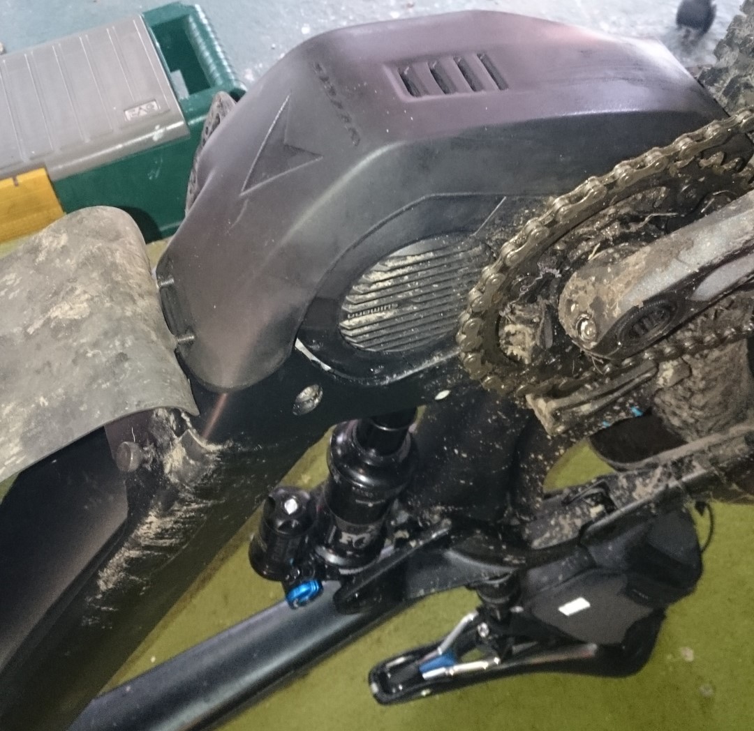

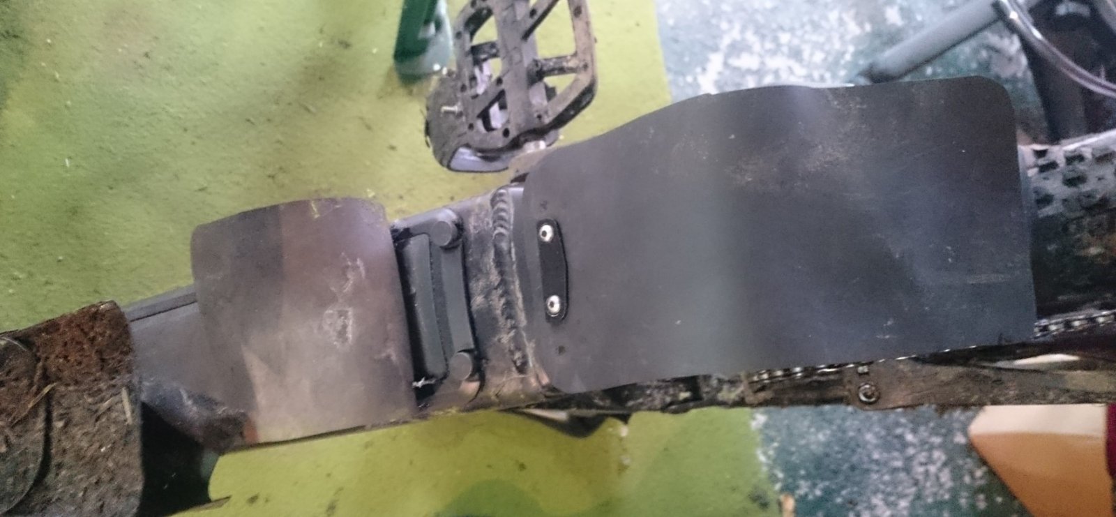

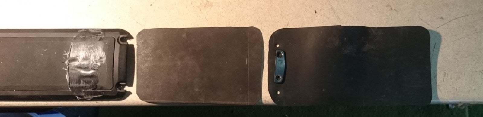

Mud and water got me in a "flap"! Having read this earlier in the month:
and then found mine all clogged up following a SHORT ride today I decided to turn the "flap" in flaps:
One is bonded to the battery cover, the other is screwed on to the engine cover:
(ignore the elestic bands - they are just holding it while the glue dries)
Hopefully that will help save the motor.
Also, tip: when replacing the engine-cover screws fill the screw heads with grease, helps stop them clogging up with mud. The flaps are made with old pond liner I had lying around.
Happy flapping!

BTW - the bottow flap is only held on by the two top engine-cover screws - it just flops down when upright.
Its only the top flap which is bonded on and only the top part (about an inch).
Good thing is the bottom battery-cover screws are covered - do not get covered in mud so easy to loosen :)

Not to be a nay-sayer, but doesn't that flap just cover the drain holes and prevent the water escaping..?
