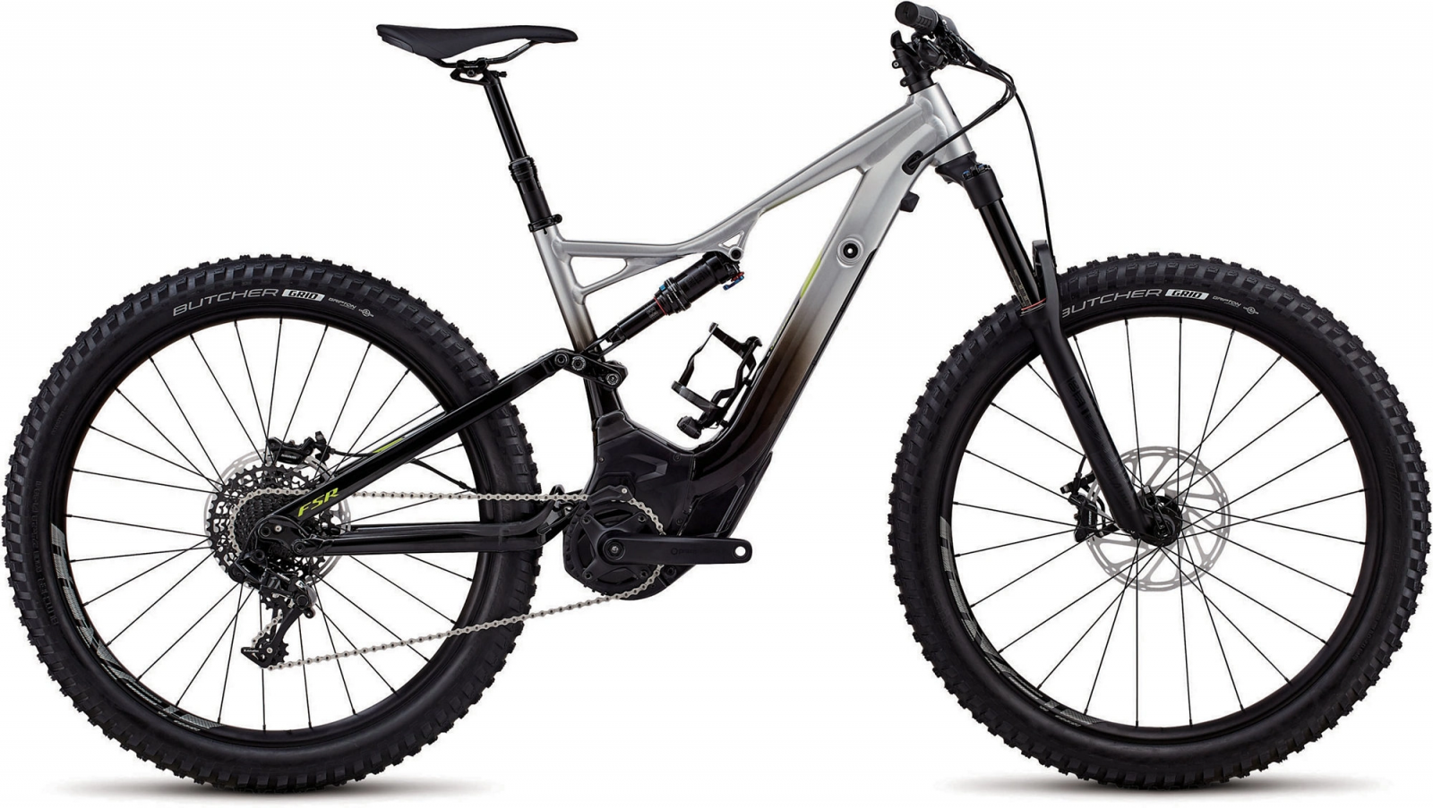

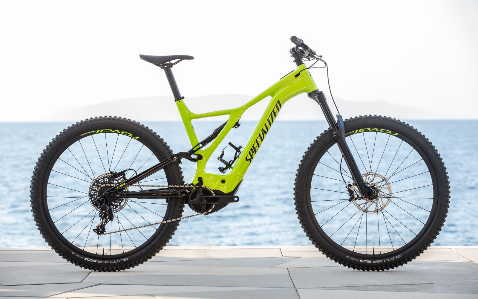

Just looking at the bike at a glance. If it looks like this :
So the battery swings down out of the frame, is held in at the top with a through bolt - this style of frame. Then it will be a Brose 1.2 or 1.3 and is a Gen1 Levo and won't have an extended motor warranty - but probably has a slightly more reliable motor anyway.

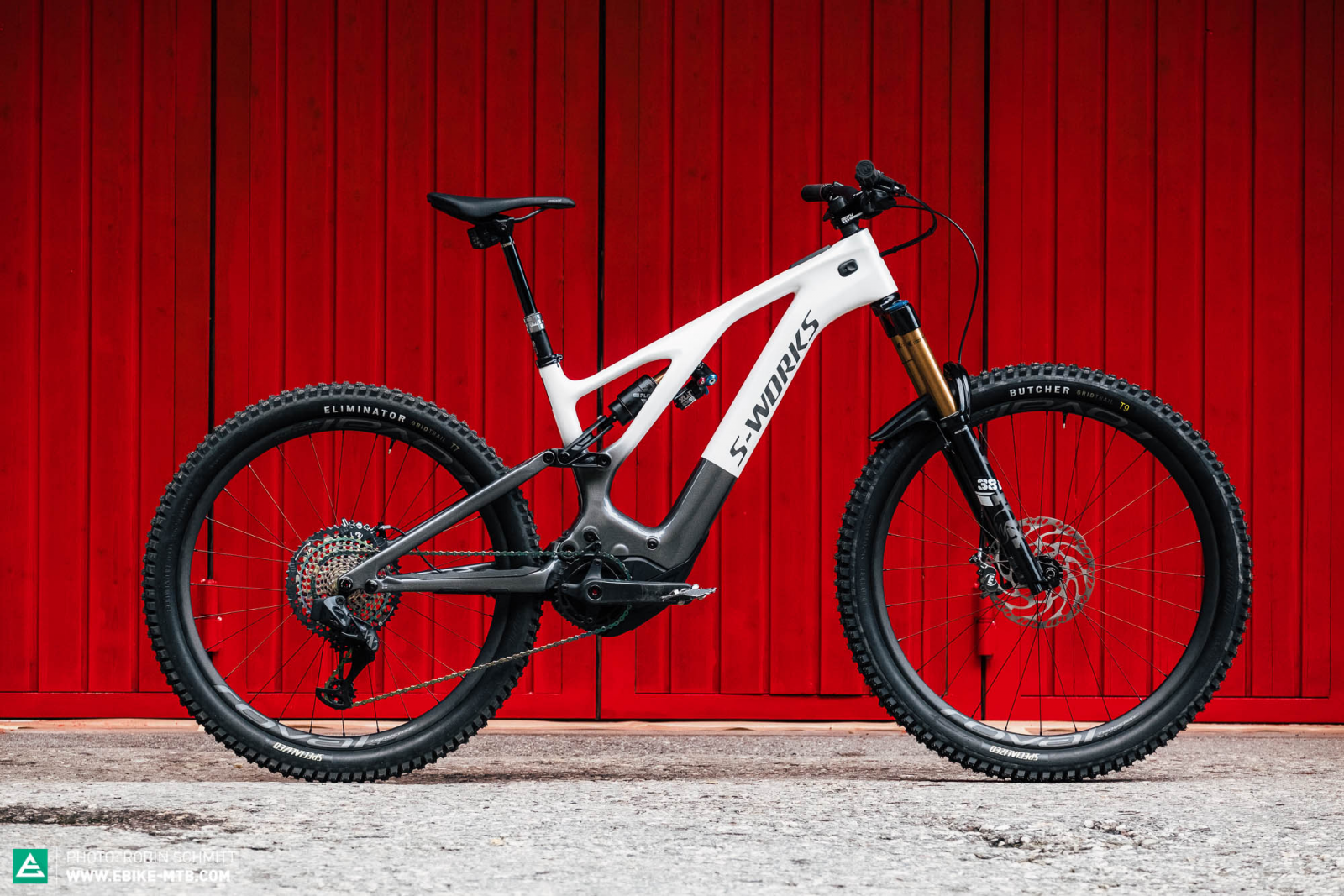

If it looks like this - battery inserts from the bottom, different frame style .. then it's a Gen2 Levo .. and will be a 2.1 motor.
If it looks like this and the frame over the motor is angled like the Gen1 again (rather than flat like the Gen2) and the top tube is straight, then it's a Gen3 levo and if they're saying it's a 2019 then it's probably stolen and you should stay clear !

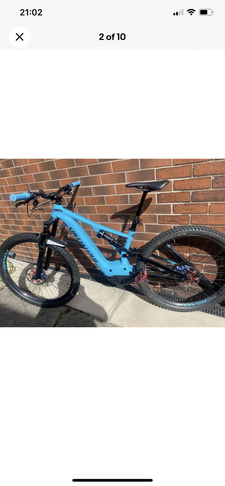

This is the bike

brilliant that thanks, this is the bike

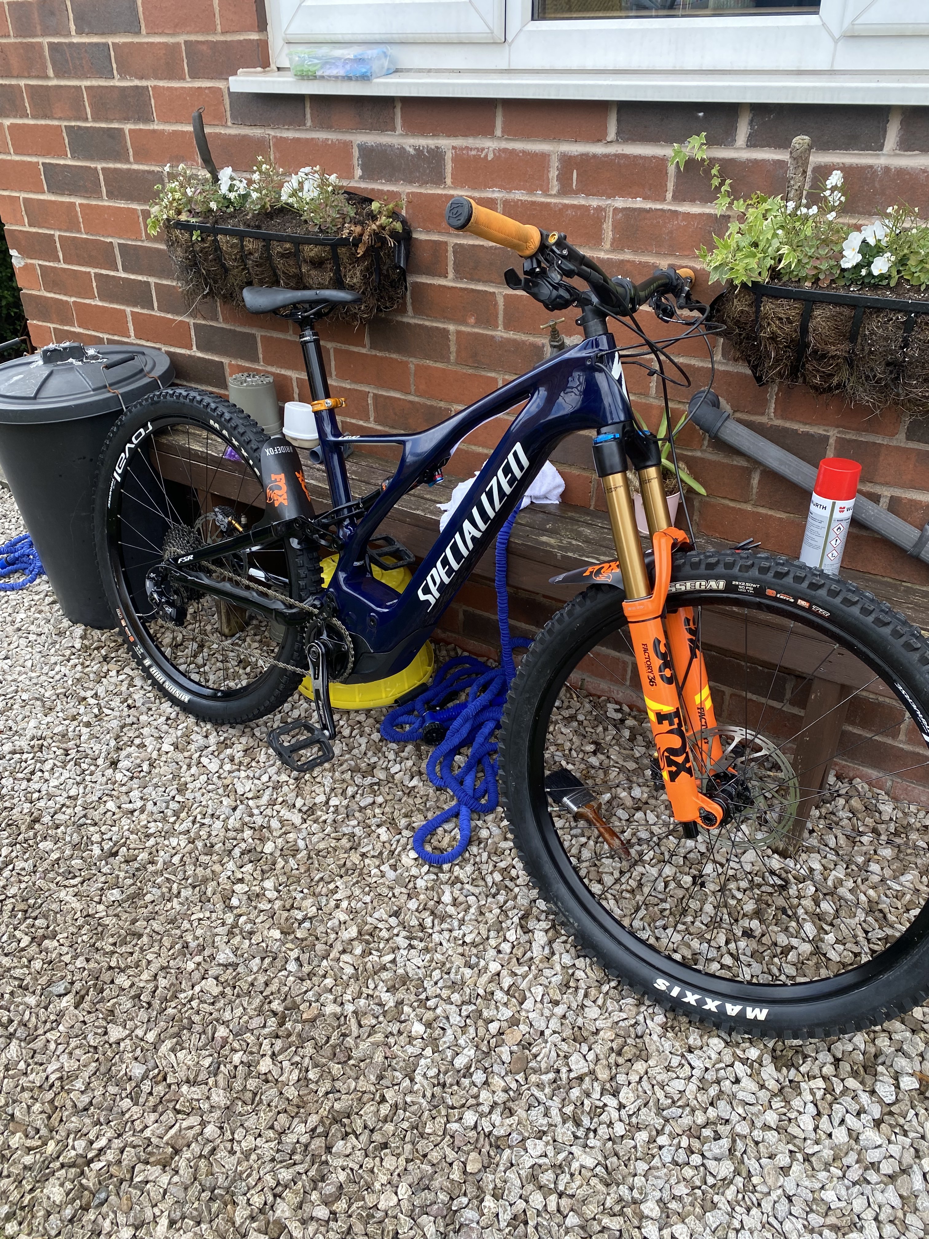

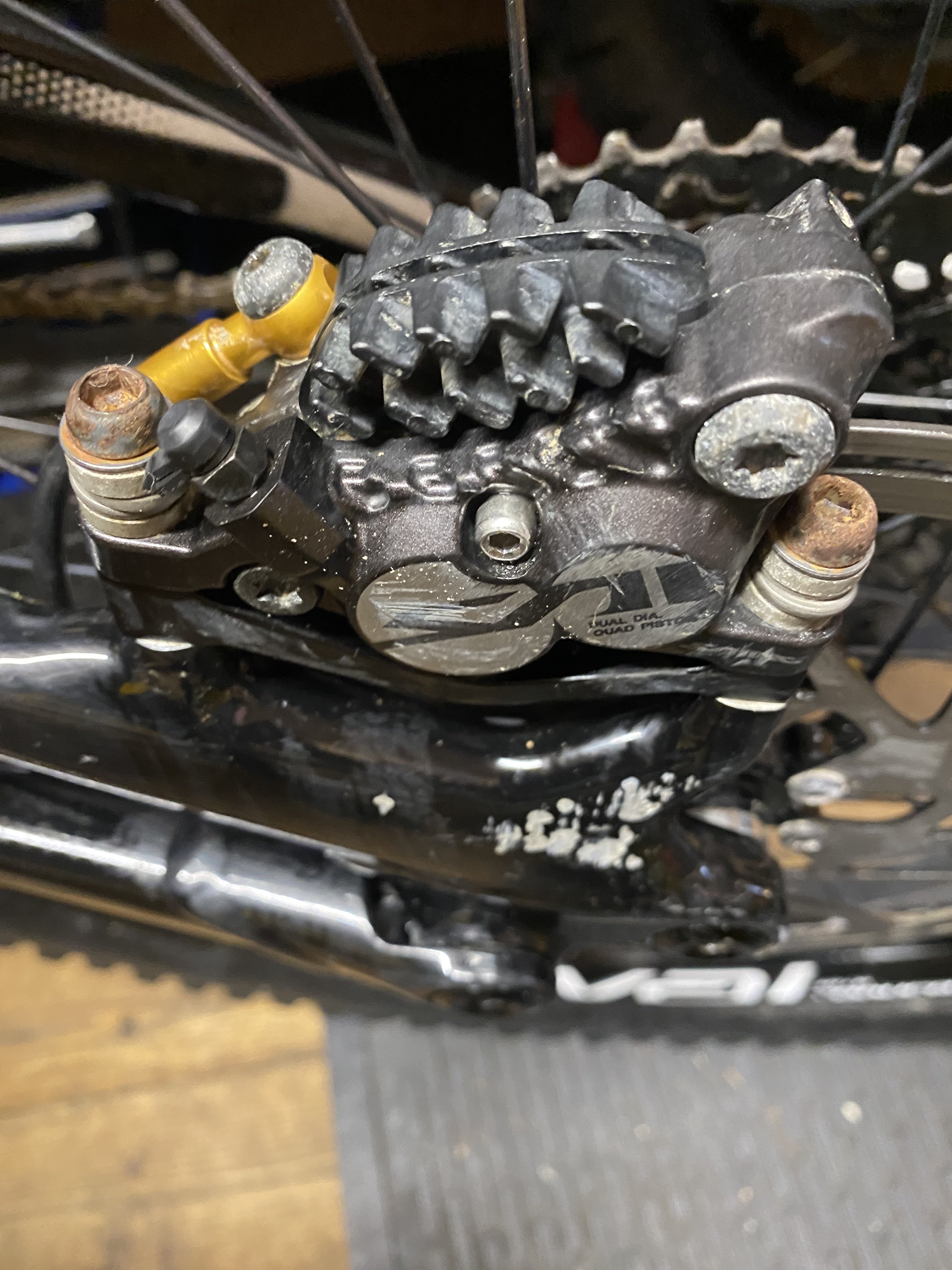

Hi all
Bought another second hand levo!
This one is carbon frame, new motor , battery and electrics under warranty , so only done a few hundred miles since.
The thing is well ridden, due a good service!, but it will clean up nicely I think!
Needs new -
brake pads , maybe rotors, as they squeak!
Seat
Pedals

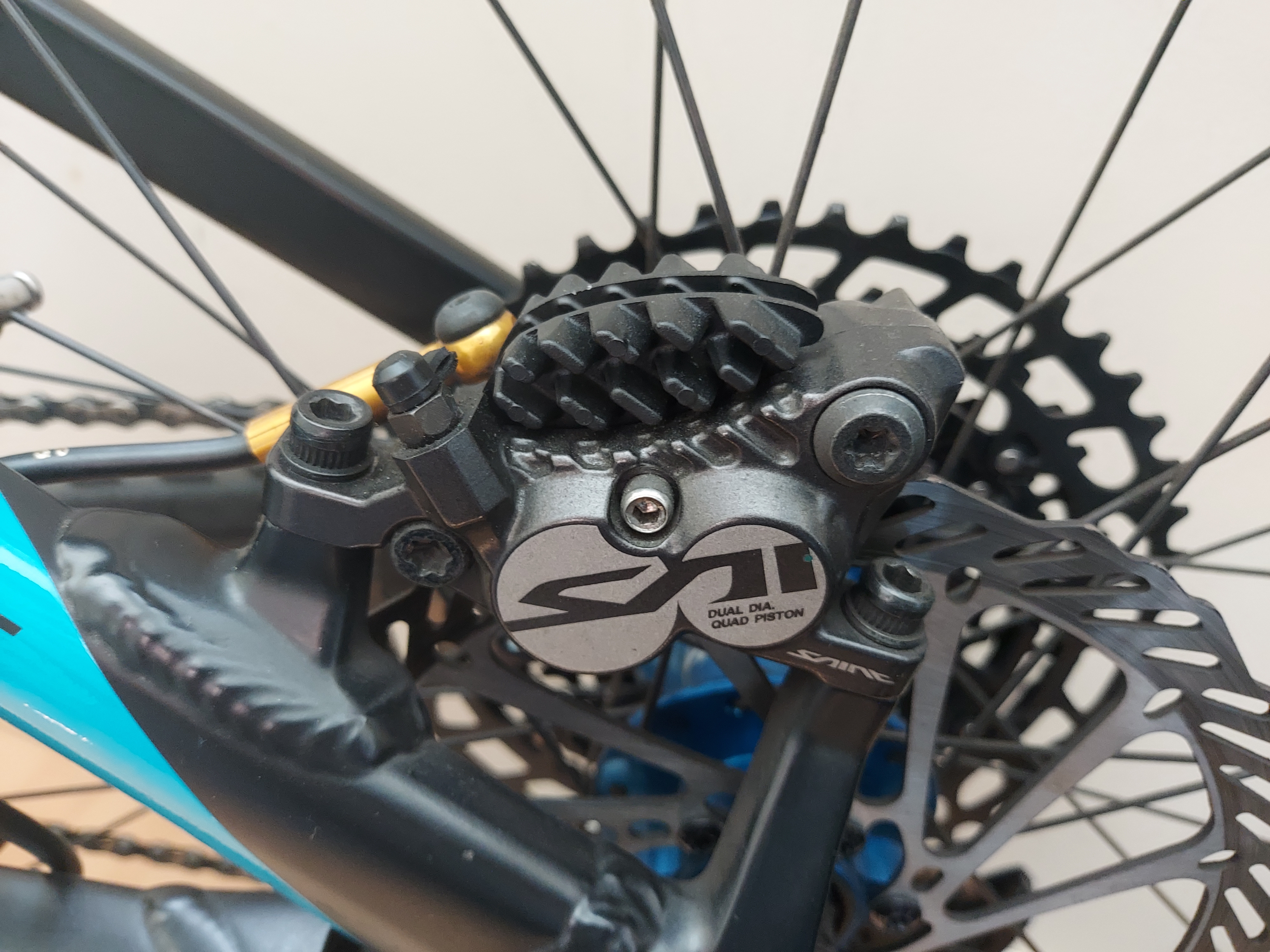

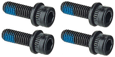

It has saint brakes that have some rusty bolts that need changing, where would I source them from?
D8CC0A61-EEAA-48C0-B596-274749EA7435.jpeg BA5FB258-29A9-4FA4-8B0B-A3215CF6719D.jpeg
