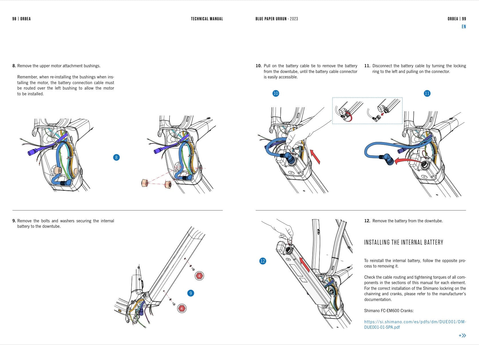

Found the bike’s ”Blue Paper” - I have to hand it to Orbea, they don’t skimp on their documentation. Very thorough with exploded part diagrams, etc. Not clear whether the battery needs to be pulled to wire a dropper.
Elegant if complicated setup: the cables and wiring run through the stem into the head tube, and the electrical wiring for the thumb switch and optional lighting switch are routed through holes in the handlebars.

Did you remove the battery? With the battery in place, I can get the cable most of the way through, but it hits something and won't go all the way.
markloch
May 14, 2021
186
141
NorCal
I didn’t for the dropper cable, but I did when I was running lighting and pulling the shifter cable (went Di2). It was easy, go for it. From the Blue Paper:
