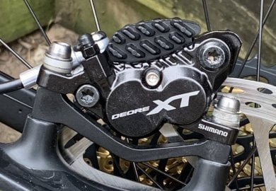

on a 2018 Levo - do I need new mounts and/or spacers or can I just bolt them on?
Should also mention I've already upgraded the brakes to Shimano 8020's

What's your actual disc diameter ? 200mm as standard ? If so, you will need a 180pm-203Pm mount adaptor as the one wich is on the levo is 180pm-200Pm. If I remember well the frame is 180 PM on the Levo. You can evantually put 1.5mm shims but I would prefer an adaptor that fit directly. After buying a Levo, 8020, and RT86, adaptors are not the biggest expense !

A couple of washers will do the trick in terms of allowing the disc to clear the caliper. But if you get any vibration under heavy braking you may have to buy the proper adaptor. You may as well try it, you have nothing to lose, unless you are about to go on a fortnights' biking holiday in a country without spares. :unsure:

Thanks, that starts to help... Yes, my standard, factory fit rotors are 200's (s-works model)
In regards to the M8020's - I love them, I had Code RSC's (standard) and they failed and spesh swapped them out for a new set under warranty. When they failed again spesh offered me the 8020's and I bit their hand off. Better modulation, better stopping power, no fade and less noise when wet - highly recommended
EDIT: and the lever feels sooo much better too

Both sets of CODE RSC’s I had suffered with spongy levers that didn’t return when squeezed. The original set the LBS said has a sticky piston. When the replacement set had the same problem the LBS called Spesh who said swap them out for 8020’s - no questions/fuss.
From what I’ve heard/read a lot of it is down to the LBS relationship with the local Spesh rep - mines is obviously good. I’ve had 2 motors, the brakes and a seat post on warranty so far.
If you don’t get what you want I’d shout a bit louder or try another LBS.
The 8020’s (came with lever, hose and Caliper) are night and day, better all round from feel to function. At the same time I went for gripshift (and a whole new 1x12 setup) so didn’t need a hanger for the gear shifter on the right hand side. On the left they just added a separate mount for the dropper.
