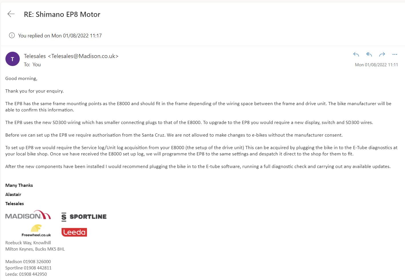

Need some help. Given your access are you able to tell us if you can buy an EP8 motor from Shimano (?) in the UK?
I want to replace the E8000 in my £10k Heckler with the newer motor but I can't get an answer from Madison.
Cheers

I have read on here that it is not simply unbolting the e8000 and bolting in the EP8 (despite the bolt holes and positioning being common). One of @Knut's mates did it early on. He was an experienced electrician and said it was tricky. The wiring used is completely different for starters and a load of other stuff that I can't recall now. But he showed that with sufficient motivation, knowledge and access to electrical stuff it can be done.
Don't let me put you off trying, just don't expect it to be easy. :(

I have a Heckler with the E8000 motor and a Heckler MX with the EP8 setup.
I don't understand why people are scared about playing with the electrics - it's all pretty much plug-and-play.
My thought was to buy a doner bike and swap all the gubbins over then sell the doner bike with the EP8 motor.
It's amazing me that this isn't a bigger issue with people!

It can be done but the problems is that the EP8 is not technically available on the aftermarket, you can buy them, but the official line is they are not, and as such anywhere you get one from is unlikely to fulfill your dealer backup requirements.
not that difficult a swap you just need all the associated wiring which is readily available on the aftermarket.
I do wonder through if Shimano will start providing the new EP6 motor as an alternative to E8000 owners. Some power as EP8 but heavier and cheaper.

I've just had an email from Madison saying about the SD300 wiring so that would need to be updated - knew that already.
But the interesting this is that they can supply me with a motor but the manufacturer has to approve the sale.
I've gone back to them asking for a cost...

They've confirmed the RRP is £969.99 but again reiterated that they need permission from Santa Cruz before they can sell the motor.

So.
Madison will sell a motor to a dealer for £969.99.
Jungle are happy to email Madison giving permission for the EP8 to go into the Heckler.
So looks to me like you can give a 2 year old bike that's out of warranty a new lease of life for lets say £1500 with fitting and cables...
This is a game changer for the Shimano bikes IMO

Great work, well done so far. I’m in the process of replacing a broken, out of warranty e8000, motor with Madison. They charge £920 for it, so paying slightly more for the EP8 is worthwhile. I realise that the display, switch and some adapters are needed but this seems worthwhile. It would be great if someone could provide a list of exactly what is needed to do the conversion. It would be even better if the parts could be sourced in the UK (Madison / other).

You might want to check all the plastic guards / covers would fit. I tried to replace a e7000 with an e8000 and whilst it physically fitted, the covers were way off and would have been a complete bodge job.
Still, awesome news if it is possible! As you say, opens up a whole new opportunity to upgrade our bikes.
